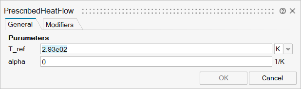

If parameter alpha is <> 0, the heat flow is multiplied by (1 + alpha*(port.T - T_ref))in order to simulate temperature dependent losses (which are given with respect to reference temperature T_ref).
mo_T_ref | T_ref | Reference temperature | Scalar | |

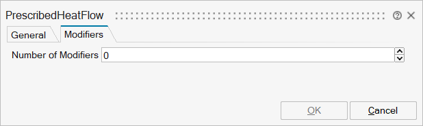

mo_alpha | alpha | Temperature coefficient of heat flow rate | Scalar |
mo__modifiers/value | Value |
