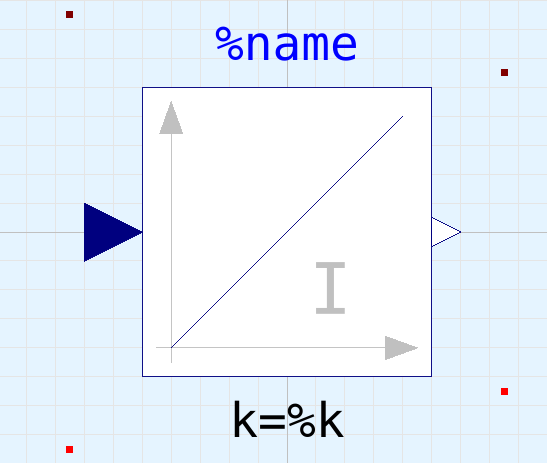

If possible, the icon shall be designed such way, that the icon name %nameand the most significant parameter can be displayed within the vertical Diagram range of the icon.

Component Name
The component name %name shall be in RGB (0,0,255) blue color.
- Text height: 40 units
- Text width: 300 units
The text shall be located above the actual icon. If there is enough space, the upper text limit of the component nameshall be 10 units below the upper icon boundary, see Fig. 1.
If the icon is as big as the entire icon range of 200 units x 200 units, e.g. in blocks,the component name shall be placed above the icon with vertical 10 units of space between icon and lower text box, see Fig. 2.
If there is a connector located at the top icon boundary and it is obvious that this connector influences the modelbehavior compared to a similar model without such connector, then a line from the connector to the actual iconshall be avoided to keep the design straight, see Fig. 4. If it is required to use a line indicating the connector dependency, thenthe line shall be interrupted such that this line does not interfere with component name.
In some cases, if there is not alternative, the component name has to be placed below the actual icon, see. Fig. 4.
Parameter Name
One significant parameter shall be placed below the icon, see Fig. 1 and Fig. 2. The parameter name shall be RGB (0,0,0) black color.
- Text height: 40 units (or 30 units, minimum 20 units, if required)
The parameter text box shall be placed 10 units below the actual icon.
