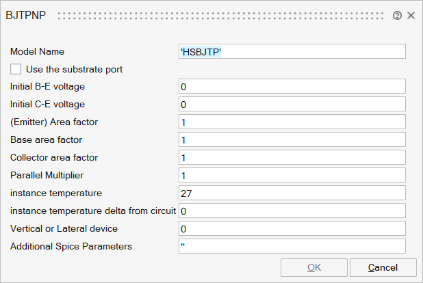

sp_mname | Model Name | String | ||
sp_needsubstrate | Use the substrate port | A bipolar may have a fourth node called substrate port | Number | 0 |
sp_icvbe | Initial B-E voltage | Initial Base-Emitter voltage. | Scalar | |
sp_icvce | Initial C-E voltage | Initial Collector-Emitter voltage | Scalar | |
sp_area | (Emitter) Area factor | Junction area but used to scale any pn junction | Scalar | |
sp_areab | Base area factor | Junction area but used to scale any pn junction | Scalar | |
sp_areac | Collector area factor | Junction area but used to scale any pn junction | Scalar | |
sp_m | Parallel Multiplier | Multiplier for setting ‘m’ bipolars in parallel | Scalar | |
sp_temp | instance temperature | The temperature at which the device is operating | Scalar | |
sp_dtemp | instance temperature delta from circuit | Temperature variation relative to the simulation temperature | Scalar | |
sp_subs | Vertical or Lateral device | Type of the BJT structure: Vertical (1), Lateral (0). | Scalar | |
sp_Spice | Additional Spice Parameters | For more details, see the section Additional Spice Parameters. Additional Spice Parameters. | String |
