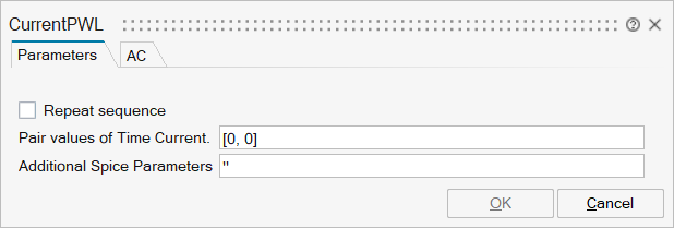

sp_PWL | PWL | String | ||
sp_R | Repeat sequence | Repeat sequence checkbox allows to repeat the signal till the end of the simulation. | Number | 0 |
sp_timepoints | Pair values of Time Current. | Pair values of Time Current. Should be filled as : T0 I0 T1 I1 .. Tn In R.R is only needed if you want to repeat a sequence R only needed to repeat a sequence. | Matrix of size Mx2 | |

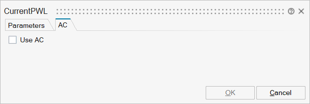

use_ac | Use AC | Check this parameter to set the AC parameters | Number | 0 |
ac_magnitude | AC Magnitude | Value of the AC current source | Scalar | |
ac_phase | AC Phase | Value of the AC phase | Scalar |
