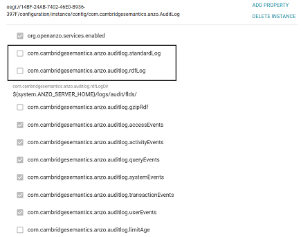

  1. In the Administration application, expand the Servers menu and click Advanced Configuration. Click I understand and accept the risk.
  2. Search for the Anzo Audit Logging Framework bundle and view its details.
  3. Click the Services tab and expand com.cambridgesemantics.anzo.AuditLog.
  4. Find the com.cambridgesemantics.anzo.auditlog.standardLog and com.cambridgesemantics.anzo.auditlog.rdfLog properties (shown below).
  5. Click the standardLog property to make it editable, and then select the checkbox to enable it.
  6. Click the checkmark icon () to save the change.
  7. If you would also like Graph Studio to generate RDF files for the audit logs so that the logs can be loaded to a graphmart for analysis, click the rdfLog property to make it editable, and then select the checkbox to enable it. Then click the checkmark icon () to save the change.
  8. Restart Graph Studio to apply the configuration changes.

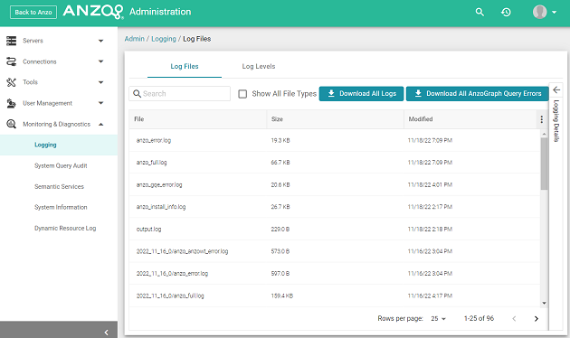

  1. In the Administration application, expand the Monitoring & Diagnostics menu and select Logging. The Log Files tab is displayed on the Logging screen. Log Packages that have the Log Level set to Error log events to files with the suffix _error. Operational information that is logged by packages that are set to Info is captured in files with the suffix _info. The current versions of the log files are shown at the top of the list. Earlier versions of the logs are prefixed with the name of the <date>_<part> subdirectory they are saved in. For example:

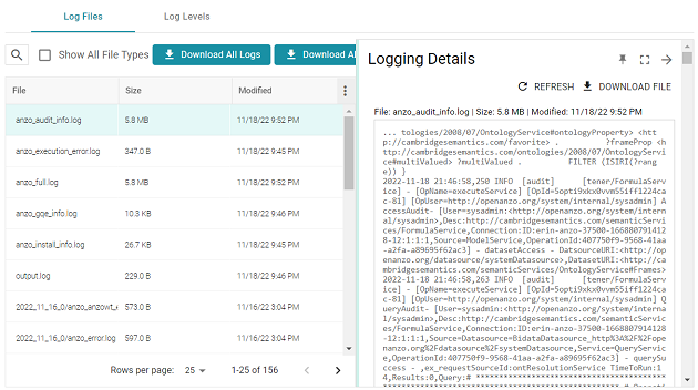

  2. Select the anzo_audit_info.log file. The contents of the file are displayed in the Logging Details section of the screen. For example:
    You can expand the details view by clicking the Expand icon () in the top right corner.
