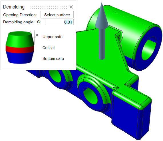

Then, in the Part Analysis sub-ribbon, click Mold Opening Direction.

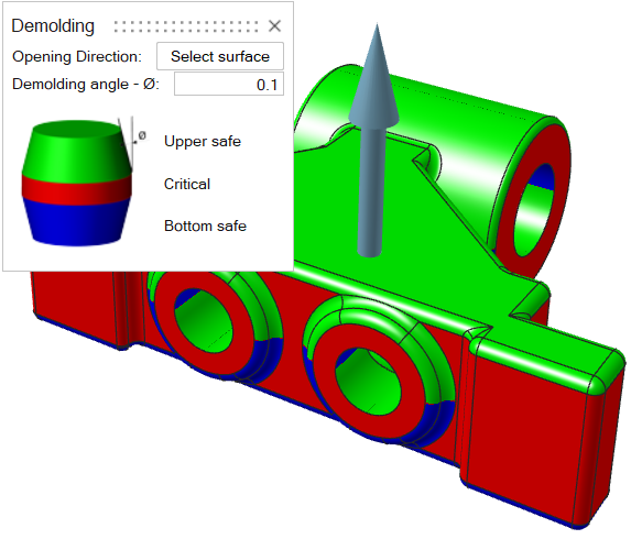

The Demolding window appears, along with a gray arrow indicating the direction of the mold opening.Note: Surfaces at an angle from the axis smaller than the demolding angle are in a critical orientation to the mold, and may adhere to the mold during the demolding process. Critical surfaces appear in red.
In the microdialog, click the Select Surface menu, then
select a face on the model.
The gray arrow reorients normal to the selected face.
Set the demolding angle.
Note: The Demolding angle field defaults to 4 degrees, though for most applications, a tolerance of 2 degrees or less is sufficient. - Right-click and mouse through the check mark to exit, or double-right-click.
