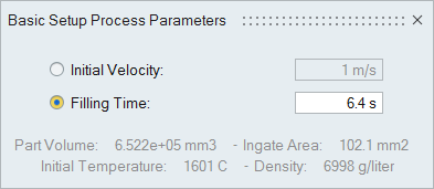

Basic Setup
Define the parameters for a quick, general casting process.
Click the Basic Setup icon.
Select Initial Velocity or Filling
Time.
Basic Setup Options
- Initial Velocity (m/s)
- Define the velocity at the predefined gate.Note:
- In gravity casting, velocities tend to be around 0.5–1.0 m/s.
- In high pressure die casting, velocities tend to be around 2.0–5.0 m/s at the filling system piston gate and 30–40 m/s at the cast part gate.
- Filling Time (s)
- Select this option if you have calculated the exact filling time
required for your process. Inspire Cast
internally converts the filling time to velocity.
