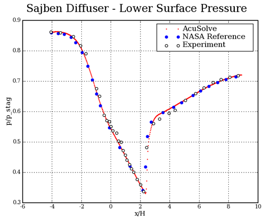

In the following example, the pressure along the bottom wall of a nozzle is plotted from three different data sources. The x-axis is scaled to represent the non-dimensional length using the x_scale attribute. Additional options are provided to further configure the plot that is outputted.
acuPlotData -files diffuser.interp.dat,pb-c4.dat,pbot-exp.dat -y_cols 4 -x_scale
22.7272 -y_label "p/p_stag" -x_label x/H -title "Diffuser - Lower Surface Pressure"
-legend "AcuSolve,NASA Reference,Experiment" -pb diffuser_lower_pressure -lfmt
or,ob,ow -ms 1,5,5 -mec r,b,k -lw 2,2,2
or alternatively the options may be put into the configuration file Acusim.cnf as follows and then type acuPlotData in the AcuSolve cmd prompt (Windows) or the Linux command line to execute:
acuPlotData.pb=diffuser_lower_pressure
acuPlotData.files=diffuser.interp.dat,pb-c4.dat,pbot-exp.dat
acuPlotData.y_cols=4
acuPlotData.ptf=on
acuPlotData.x_scale=22.7272
acuPlotData.y_label="p/p_stag"
acuPlotData.x_label=x/H
acuPlotData.title="Diffuser - Lower Surface Pressure"
acuPlotData.legend="AcuSolve,NASA Reference,Experiment"
acuPlotData.lfmt=or,ob,ow
acuPlotData.ms=1,5,5
acuPlotData.mec=r,b,k
acuPlotData.lw=2,2,2
The following will be printed to the standard output of the terminal:
acuPlotData:  Plotting frame <1>
acuPlotData:  Evaluating argument <diffuser.interp.dat>
acuPlotData:  Found <1> files
acuPlotData:  Processing file <diffuser.interp.dat>
acuPlotData:  Plotting <500> points
acuPlotData:  Evaluating argument <pb-c4.dat>
acuPlotData:  Processing file <pb-c4.dat>
acuPlotData:  Plotting <26> points
acuPlotData:  Evaluating argument <pbot-exp.dat>
acuPlotData:  Processing file <pbot-exp.dat>
acuPlotData:  Plotting <36> points
acuPlotData:  Printing plot to file <diffuser_lower_pressure.png>
The above example produces an image file with extension .png, an example is shown below.

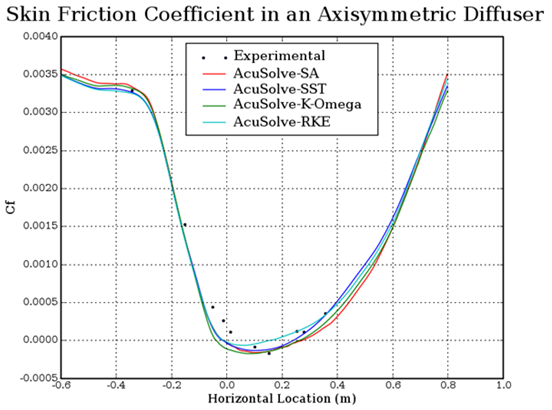

In the following example, the skin friction coefficient along the wall is plotted from five different data sources. Additional options are provided to further configure the plot that is outputted.
acuPlotData -files exp.dat,sa.dat,sst.dat,ko.dat,rke.dat -y_cols 4 -y_label "Cf" -
x_label “Horizontal Location (m)” -title "Skin Friction Coefficient in an
Axisymmetric Diffuser" -legend "Experimental,AcuSolve-SA,AcuSolve-SST,AcuSolve-K-
Omega,AcuSolve-RKE" -lfmt ok,-r,-b,-g,-c -ms 2,1,1,1,1 -lw 2,2,2,2,2
or alternatively the options may be put into the configuration file Acusim.cnf as follows:
acuPlotData.pb=dr
acuPlotData.files= exp.dat,sa.dat,sst.dat,ko.dat,rke.dat
acuPlotData.ptf=on
acuPlotData.y_label="Cf"
acuPlotData.x_label=”Horizontal Location (m)”
acuPlotData.title="Skin Friction Coefficient in an Axisymmetric Diffuser"
acuPlotData.legend=Experimental,AcuSolve-SA,AcuSolve-SST,AcuSolve-K-Omega,AcuSolve-RKE
acuPlotData.lfmt= ok,-r,-b,-g,-c
acuPlotData.ms=2,1,1,1,1
acuPlotData.lw=2,2,2,2,2
