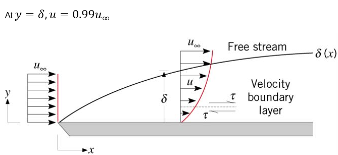

Velocity boundary layer or commonly referred to as boundary layer is a thin layer of fluid formed near a boundary surface where the viscous effects of the fluid are significant.
When a fluid moves past an object or an object moves past a fluid, the fluid molecules right next to the boundary surface stick to it. This causes the molecules just above the surface to slow down because of collision with the molecules sticking to the surface. These molecules consequently slow down the flow just above them. As we move farther away from the surface of the object, the collisions affected by the object’s surface reduces. Thus a layer of fluid is created within which the velocity of the flow gradually changes from zero at the object’s surface to the free stream velocity at a certain distance away from the surface.
This distance at which the flow velocity inside the boundary essentially reaches the free stream velocity is termed as the boundary layer thickness. Mathematically it is defined as the distance at which the flow velocity is 99 percent of the free stream velocity.
Figure 1. Velocity Boundary Layer
As a result of the loss of velocity, a shear stress is imparted on the object surface defined as
τ s = μ ∂ u ∂ y | y = 0
