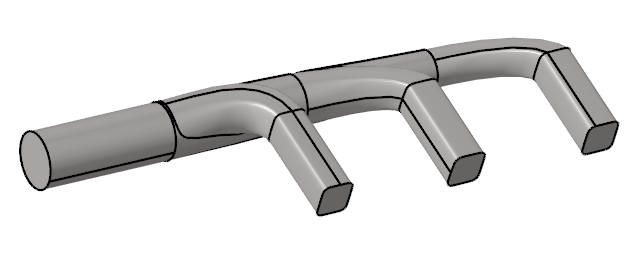

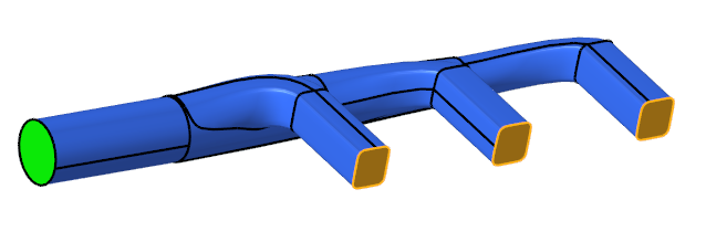

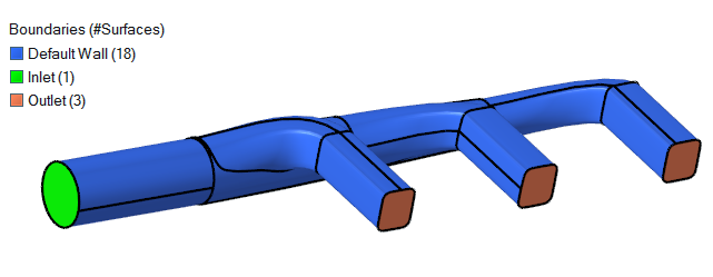

The system being simulated here is a manifold pipe, analogous to an inlet manifold in an engine. An inlet manifold distributes the incoming flow to multiple outputs. As can be seen in the image below, the pipe has a single inlet and multiple outlets, thus distributing a fraction of the flow among each outlet. Ideally in an inlet manifold used in an engine, the manifold design is such that it ensures near-equal distribution of flow among all the outlets. However, the geometry being used here is purely a demonstration case and not an optimized manifold geometry.
Figure 1. Schematic of the Problem

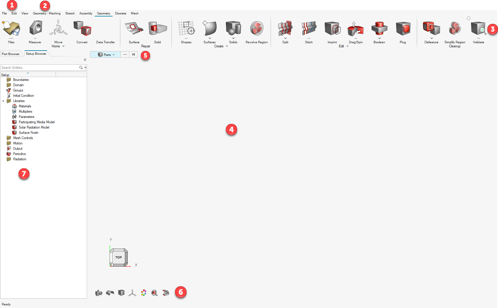

The HyperMesh CFD graphical user interface can be divided into seven general categories as shown in the figure above.
  1. The menu bar contains the drop-down menus for File input-output, Edit, and View operations.
  2. The modeling environment switcher is used to populate relevant ribbons and tools based on modeling tasks.
  3. Ribbons contain various functionalities and tools available in HM-CFD. Navigate between various ribbons by clicking the ribbon tabs to the right of the modeling environment switcher. After selecting a ribbon, the corresponding tool icons are displayed on the screen. The functionalities of various ribbons and corresponding tools are briefly explained in this section.

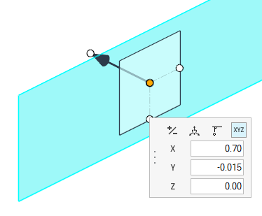

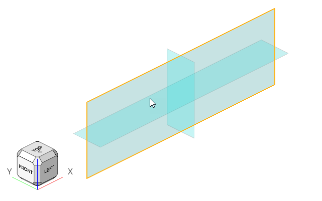

    Sketch ribbon
    The Sketch ribbon provides multiple ways to define sketching plane by selecting planes aligned with global coordinate systems. You can also get references of existing geometry by cutting geometry or projecting geometry to a plane. It provides capabilities to create sketches using multiple interactive tools. A dimensioning capability enables you to parametrize dimensions of sketches. One of big use case for CFD is to get cutting lines of rotating geometry and create a non–cylindrical axisymmetric MRF region around them.

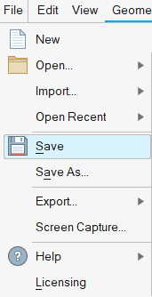

  2. Create a new .hm database in one of the following ways:
    • From the menu bar, click File > Save.
      Figure 20.

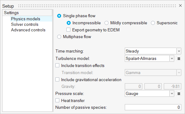

  2. Under the Physics models setting:
    1. Verify that the Incompressible option is selected under Single phase flow.
    2. Set the Time marching to Steady.
    3. Select Spalart-Allmaras as the Turbulence model.
      The robustness and accuracy of the Spalart Allmaras turbulence model makes it an excellent choice for simulation of steady state flows.
    Figure 27.

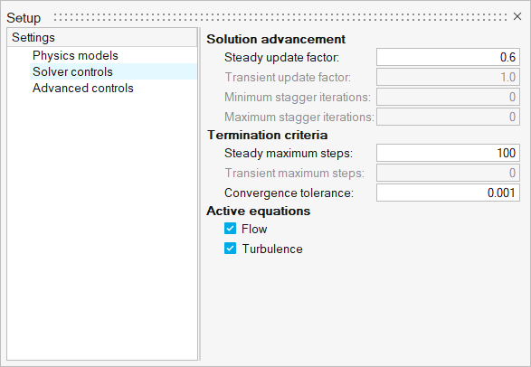

  3. Click the Solver controls setting and verify that the parameters are set as shown in the figure below.
    Figure 28.

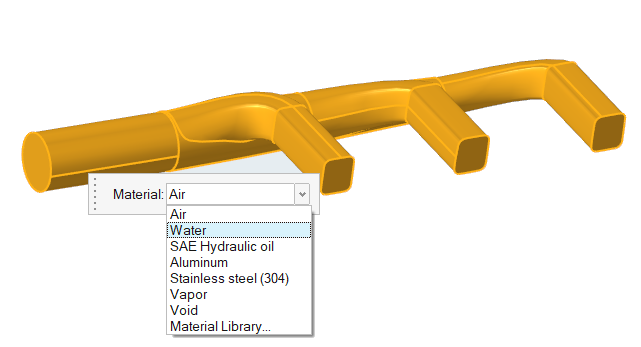

  1. From the Flow ribbon, click the Material tool.
    Figure 29.
  2. From the modeling window, click anywhere on the manifold.
    The entire manifold geometry is highlighted and a Material microdialog appears.
    Figure 30.

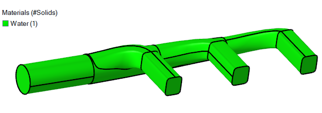

  3. Click the drop-down menu and select Water from the list of materials.
  4. On the guide bar, click to execute the command.
    The changes made in the tool are not effective until they are executed by clicking the icon.
    Once the command is executed, the color of the geometry changes to indicate the material assigned to the volume. In this case, there is only one volume in the geometry so there is a single color. Alternatively, if there are multiple volumes with different materials assigned, the model will be displayed accordingly with distinct colors for each material assigned.
    Figure 31.

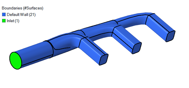

    Observe that a new group named "Inlet" is created under the Boundaries list in the top-left corner of the modeling window. Once the current command is executed, the highlighted surface will be moved into the Inlet group.

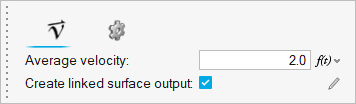

  3. In the microdialog, enter a value of 2.0 m/sec for Average velocity.
    Figure 34.
    The color of the inlet surface in the modeling window is updated.

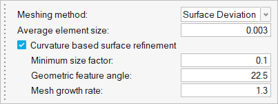

  1. From the Mesh ribbon, click the Surface tool.
    Figure 39.

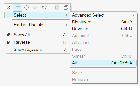

  2. Right-click in the modeling window and go to Select > All.
    Figure 40.
    All the surfaces in the model are highlighted and a dialog for surface mesh parameters appears.
  3. Enter 0.003 m for the Average element size.
    Figure 41.
  4. Leave the default values for the remaining parameters unchanged then click on the guide bar to execute the command.

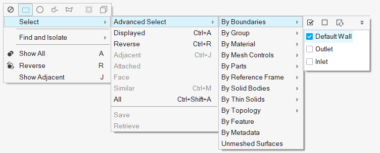

  2. Right-click in the modeling window and go to Select > Advanced Select > By Boundaries > Default Wall.
    Figure 43.

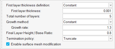

    All the wall surfaces are highlighted and a dialog for boundary layer parameters appears.
  3. Enter the values in the dialog as shown in the figure below.
    Figure 44.

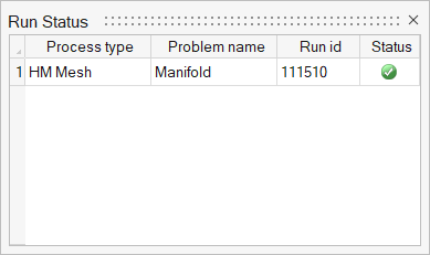

  3. Click Mesh.
    Once the meshing process has started, the Run Status dialog appears. To view the status of the meshing process, right-click the process row and select View log file.
    Once the meshing is done, the run status is updated accordingly, and you are automatically moved to the Solution ribbon.

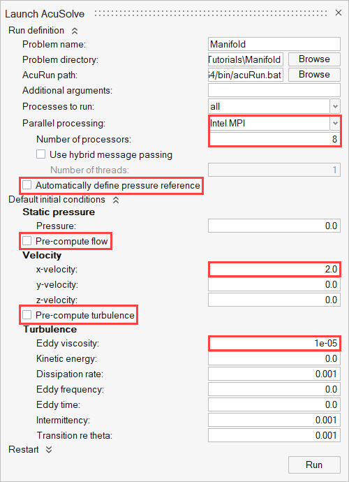

  1. From the Solution ribbon, click the Run tool.
    Figure 48.
  2. In the Launch AcuSolve dialog, verify that the Problem directory and AcuRun path are pointing to the correct location.
  3. Set the Parallel processing option to Intel MPI.
  4. Optional: Set the number of processors to 4 or 8 based on availability.
  5. Deactivate the Automatically define pressure reference option.
  6. Expand the Default initial conditions menu.
  7. Deactivate the Pre-compute flow option and enter 2.0 m/s for x-velocity.
  8. Deactivate the Pre-compute turbulence flow option and enter 1e-5 m2/s for Eddy viscosity.
  9. Leave the remaining options as default and click Run to launch AcuSolve.
    Figure 49.
    The Run Status dialog opens again and the AcuSolve run appears on the list.

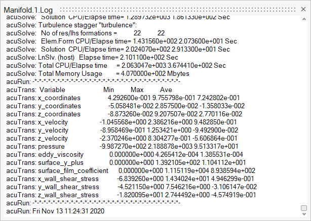

  10. Right-click on the AcuSolve run and select View log file.
    A summary of the run printed in the dialog indicates that AcuSolve has finished running the simulation. Once the solution is converged, the Status will be updated accordingly.
    Figure 50.

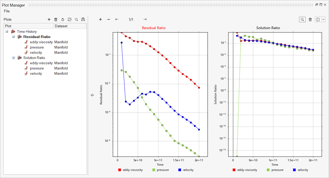

  11. In the Run Status dialog, right-click AcuSolve run and select Plot time history to launch the Plot Manager.
    Figure 51.
    The above plot shows the residual and solution ratios of the equations as the solution progresses through each time step. The convergence check is performed on the residual and solution increment ratios of each equation in the problem. For the residual, the ratio of the residual norm over the norm of the forces of the systems is used. For the solution increment, the ratio of the solution increment norm over the solution norm is used. These ratios are computed separately for each solution field, such as pressure and velocity.
    Once the pressure and velocity residual ratios reach a value less than the specified convergence tolerance (0.001), the solution is considered to be converged. By default, the eddy viscosity convergence tolerance is set to a magnitude of one order higher than the specified convergence tolerance (0.01).
    Once the pressure and velocity solution ratios reach a value less than the specified convergence tolerance (0.01), the solution is considered to be arrived at steady state. The eddy viscosity solution ratio convergence tolerance is set to a magnitude of one order higher than the specified solution ratio convergence tolerance (0.1).

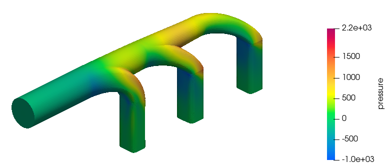

Create Pressure Contours on Boundary Surfaces
  1. Click the Boundary Groups tool.
    Figure 52.
  2. Select all surfaces in the model by holding the left mouse button, dragging, and drawing a rectangle across the manifold.
    Figure 53.

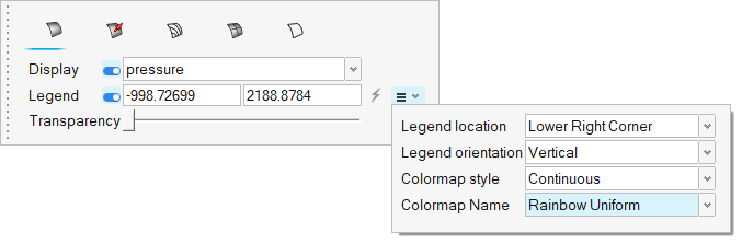

  3. In the microdialog, set the Display variable to pressure.
  4. Activate the Legend toggle and click to reset the range.
  5. Click and set the Colormap Name to Rainbow Uniform.
    Figure 54.
  6. Click on the guide bar.
    The pressure legend is in Pa.
    Figure 55.

  2. Click the Slice Planes tool.
    Figure 57.
  3. Select the x-z plane in the modeling window.
    Figure 58.
  4. In the microdialog, click to adjust the plane with the Vector tool.
  5. In the Vector tool dialog, click to define the coordinates of the center of plane. Set the value of Y to -0.015 and press Enter.
    Figure 59.
  6. Press Esc twice.
  7. In the slice plane microdialog, click to create the slice plane.

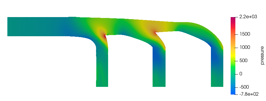

  8. In the display properties microdialog, set the Display variable to pressure.
  9. Activate the Legend toggle and click to reset the range.
  10. Click and set the Colormap Name to Rainbow Uniform.
    Figure 60.
  11. Click on the guide bar.
    Figure 61.
  12. In the Post Browser, right-click Slice Plane 1 and select Edit.

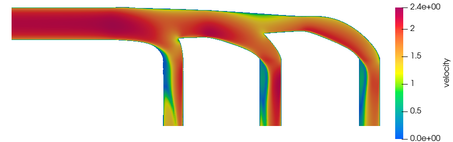

  13. In the microdialog, change the Display variable to velocity (m/s) then click on the guide bar.
    Figure 62.
