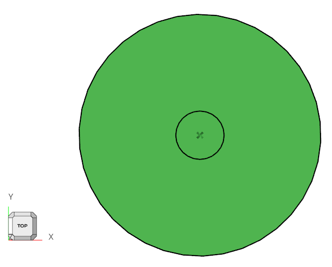

Import the Airfoil Geometry
  1. From the menu bar, click File > Import > Geometry Model.
  2. In the Import File dialog, browse to your working directory then select ACU-T2100_NACA0012airfoil.x_b and click Open.
  3. In the Geometry Import Options dialog, leave all the default options unchanged and then click Import.
    Figure 3.

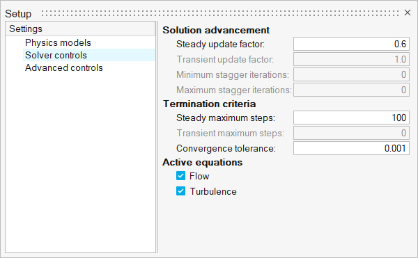

  3. Click the Solver controls setting.
  4. Set the Steady update factor to 0.6, the Steady maximum steps to 100, and the Convergence tolerance to 0.001.
    Figure 8.
  5. Close the dialog and save the model.

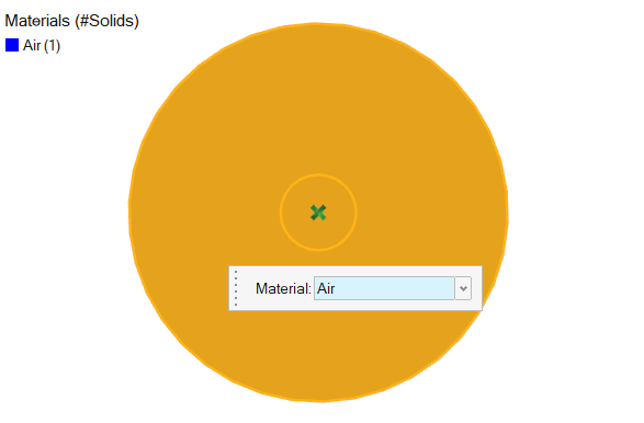

  2. Select the model body.
    The entire solid is highlighted.
    Figure 10.
  3. In the microdialog check that the material Air is assigned by default.

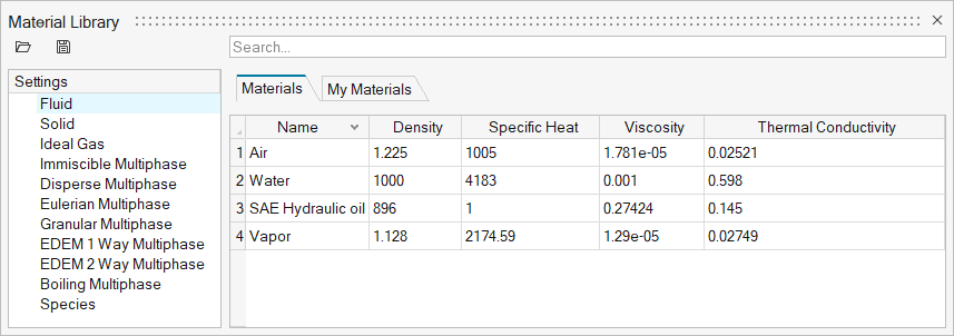

  4. Click the Material Library tool to verify the material properties of air.
    Figure 11.
    Air should have the following properties.
    • Density: 1.225
    • Specific Heat: 1005
    • Viscosity: 1.781e-5
    • Thermal Conductivity: 0.02521
    Figure 12.

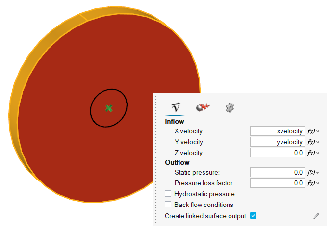

  1. From the Flow ribbon, click the Far Field tool.
    Figure 15.
  2. Rotate the geometry slightly so that the side-surfaces are visible. Click the two half-side surfaces as shown in the figure below. In the microdialog, type xvelocity and yvelocity in the respective velocity fields. Accept all other default parameters.
    Figure 16.

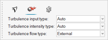

  3. Click the Turbulence tab in the microdialog and select External for the Turbulence flow type. Accept all other default parameters.
    Figure 17.
  4. Click on the guide bar.
    The Boundaries legend shows the status of the updated event.
    Figure 18.
  5. On the guide bar, click to execute the command and exit the tool.

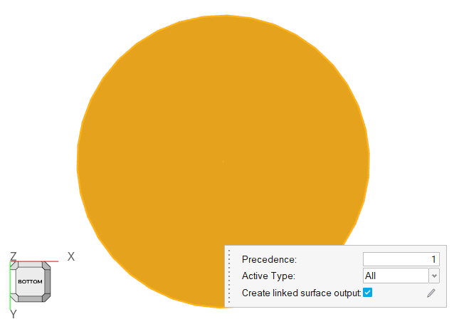

Set Slip Boundary Conditions
  1. Click the Top face of the View Cube to orient the geometry.
    Figure 19.
  2. Click the Slip tool.
    Figure 20.
  3. Select the two surfaces shown in the figure below. Accept all default parameters in the microdialog.
    Figure 21.
  5. Click the Top face of the View Cube once more to orient the geometry to the bottom view.
    Once the view is set, clicking the view again aligns the geometry to the opposite view.
  6. Select the surface and accept all default parameters in the microdialog.
    Figure 22.
  7. Click on the guide bar.
    The Boundaries legend should now look like the following:
    Figure 23.
  8. Click the Bottom face of the View Cube to re-align the geometry with the top view.
  9. Using the Boundaries legend, rename Slip (2) to +Z slip and Slip (1) to -Z slip.
  10. On the guide bar, click to execute the command and exit the tool.

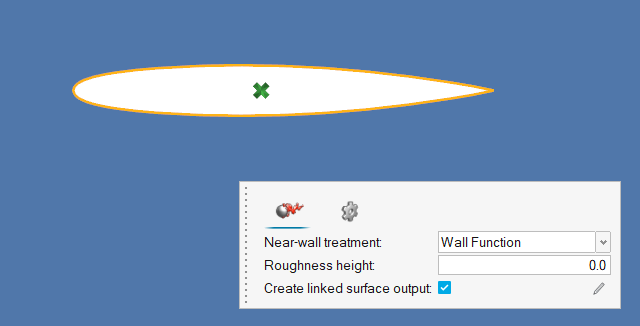

  1. Click the No Slip tool.
    Figure 24.
  2. Scroll to zoom in so that the airfoil surface is clearly visible.
  3. Right-click in the modeling window and choose Select > Advanced Selection > By Boundaries > Default Wall to select the entire airfoil profile.
    Figure 25.
  5. Using the Boundaries legend, rename Wall (30) to Airfoil.
  6. On the guide bar, click to execute the command and exit the tool.

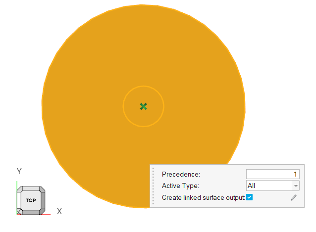

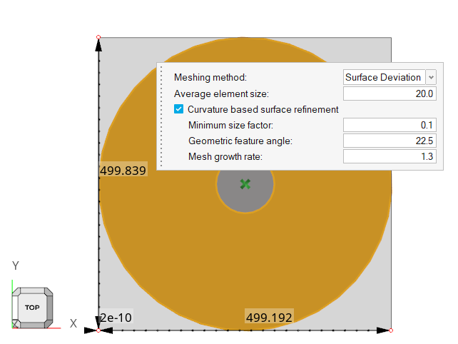

  2. Select the outer circular surface shown in the figure below.
  3. In the microdialog, set the Average element size to 20 and make sure the Minimum size factor (0.1), Geometric feature angle (22.5), and Mesh growth rate (1.2) are entered as shown below.
    Figure 27.

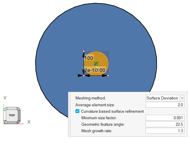

  5. Select the inner circular surface shown in the figure below.
  6. In the microdialog, set the Average element size to 2 and the Minimum size factor to 0.001.
    This ensures a smooth transition of mesh size of the airfoil.
    Figure 28.
    The Surface Controls legend shows the status of the updated events.
    Figure 29.

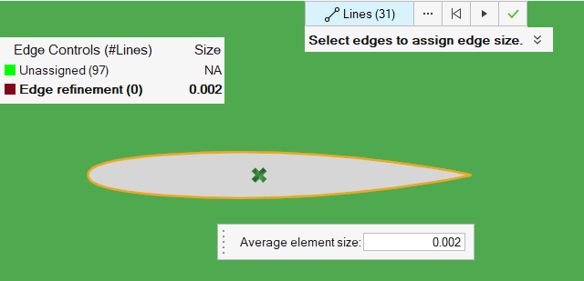

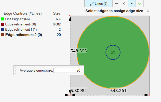

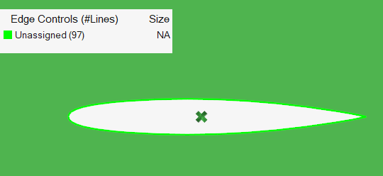

Set Edge Mesh Controls
  1. Click the Edge tool.
    Figure 30.
  2. Zoom in on the airfoil.
    Figure 31.
  3. Right-click in the modeling window and select Select > Advanced Selection > By Mesh Controls > Surface Mesh Controls 1.
    This also selects the edge of the smaller circle, which will be unselected in the next step. The total number of lines selected is (31).
  4. In the microdialog, enter a value of 0.002 for Average element size.
    Figure 32.
  5. Click on the guide bar.
  6. Zoom out until the edge of the smaller circle appears.
  7. Right-click Edge refinement(31) and select Edit. Keep the cursor on the highlighted edge of the smaller circular. Press Shift and left click to deselect the smaller circular edge so that the total lines selected becomes (30).
    Figure 33.
  8. Click on the guide bar.

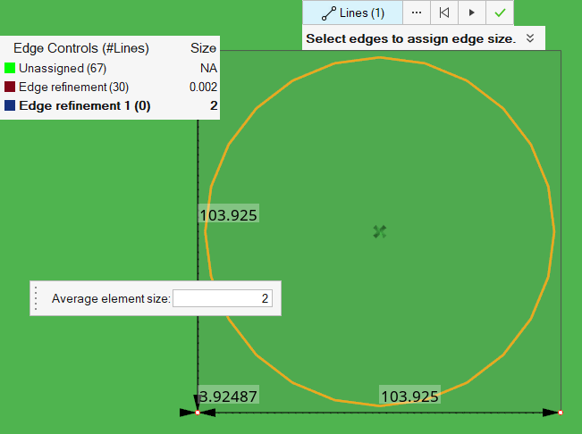

  9. Keep the mouse on the smaller circle edge line and click it. Enter the value of 2 for the Average element size.
    Figure 34.
  10. Click on the guide bar.
  11. Click the Top face of the View Cube.
    Figure 35.
  12. Select the two outer edges of the outer circle and enter a value of 20 for the Average element size.
    Figure 36.
  13. Click on the guide bar.
    The Edge Controls legend shows the status of the updated events.
    Figure 37.
  14. On the guide bar, click to execute the command and exit the tool.

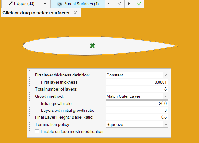

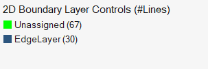

Set Edge Layer Controls
  1. Zoom in on the airfoil.
  2. Click the Edge Layer tool.
    Figure 38.

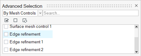

  3. On the guide bar, click besides the Edges selector.
  4. In the Advanced Selection dialog, select By Mesh Controls and enable Edge refinement.
    Figure 39.

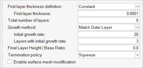

  5. In the microdialog, select Constant for First layer thickness definition. Enter a value of 0.0001 for First layer thickness and 20 for the Total number of layers for generating mesh boundary layers. Select Constant for Growth method, enter a value of 1.2 for Growth rate, and verify a value of 0.8 for Final Layer Height/Base Ratio. Accept all other default parameters.
    Figure 40.
  6. Close the Advanced Selection dialog and then click Parent Surface on the guide bar and select the smaller circular surface (around the airfoil) as shown below.
    Figure 41.
    The 2D Boundary Layer Controls legend shows the status of the updated events.
    Figure 42.
  8. On the guide bar, click to execute the command and exit the tool.

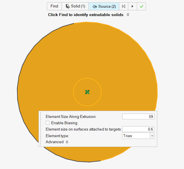

  4. Click Source then select the model surface.
  5. In the microdialog, enter a value of 50 for Element Size Along Extrusion and 0.6 for Element size on the surfaces attached to targets. Accept all other default parameters.
    Figure 44.
  6. Click on the guide bar, observe the change in the legend, and then click .

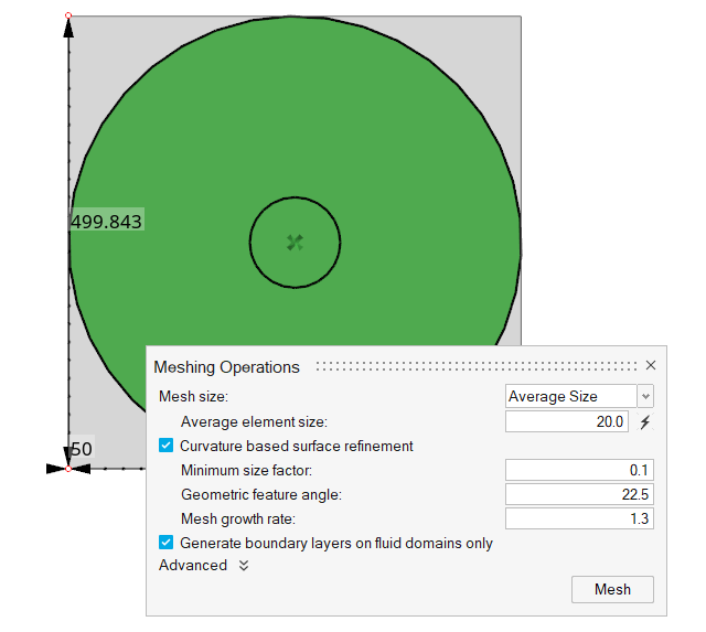

Generate the Mesh
  1. From the Mesh ribbon, click the Volume tool.
    Figure 45.
    The Meshing Operations dialog opens.
  2. Check that the Average element size is 20. Accept all other default parameters.
    Figure 46.
  3. Click Mesh.
    The Run Status dialog opens. Once the run is complete, the status is updated and you can close the dialog.
    Tip: Right-click the mesh job and select View log file to view a summary of the meshing process.

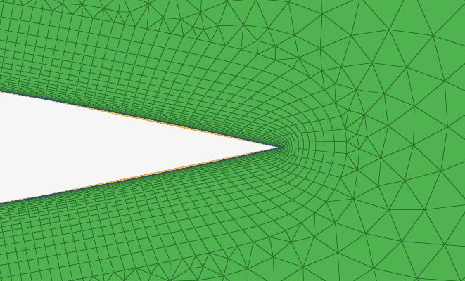

  6. Zoom towards the trailing edge of the airfoil to view the mesh.
    Figure 49.

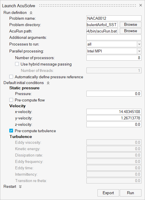

Run AcuSolve
  1. From the Solution ribbon, click the Run tool.
    Figure 52.
    The Launch AcuSolve dialog opens.
  2. Set the Problem name to NACA0012.
  3. Set the Parallel processing option to Intel MPI.
  4. Optional: Set the number of processors to 4 or 8 based on availability.
  5. Deactivate the Automatically define pressure reference option.
  6. Expand Default initial conditions, turn off Pre-compute flow, and set x-velocity yo 14.48345108 and y-velocity to 1.26713777823. Enable Pre-compute turbulence.
    Figure 53.
  7. Click Run.

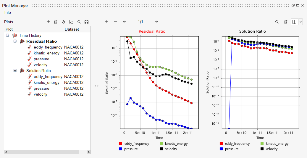

Post-Process the Results with HM-CFD Post
  1. Once the solution is completed, right-click the AcuSolve run in the Run Status dialog and select Plot time history.
    Figure 54.
    The Plot Manager shows the Residual and Solution Ratios.
    Figure 55.
  2. Close the dialog.

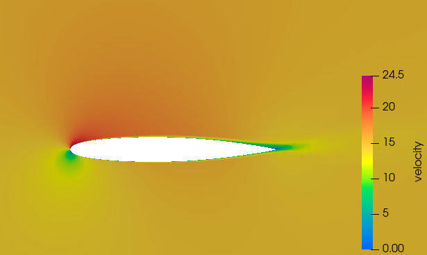

  3. Right-click the AcuSolve run again and select Visualize Results.
    You are taken to the Post ribbon.
  4. Click the Slice Planes tool.
    Figure 56.
  5. Select the x-y plane in the modeling window.
    Figure 57.
  6. Click to create the slice plane.

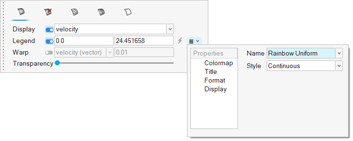

  7. In the display properties microdialog, set the display to velocity and activate the Legend toggle.
  8. Click and set the Colormap Name to Rainbow Uniform.
    Figure 58.
  9. Click on the guide bar to visualize the sqrt eddy period contour.

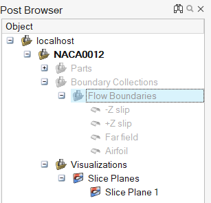

  10. In the Post Browser, click the icon beside Flow Boundaries to turn off the display for all the flow boundaries.
    Figure 59.
  11. On the guide bar, click to execute the command and exit the tool.
  12. Zoom in on the airfoil to see the contour.

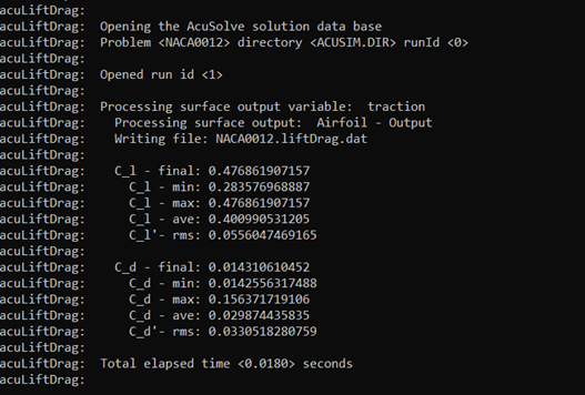

    acuLiftDrag -osis "Airfoil - Output" -aoa 5 -ref_vel 14.54 -chord 1 -ref_rho 1.225 -span 50
    The output of the command should look like the image below:
    Figure 61.
    The value C_l corresponds to the lift coefficient, and C_d corresponds to the drag coefficient. The final keyword refers to the respective coefficient values at the last time step of the simulation. The rest of the values provide the basic statistics for these coefficients over all the time steps of the simulation. These statistics are more meaningful if the simulation is transient.
    The script also creates the file NACA0012.liftDrag.dat in the problem directory. The file contains the lift and drag data for all the available time steps in a determined tabular arrangement. The first column is the time step, the second column is the lift coefficient, and the third column is the drag coefficient.

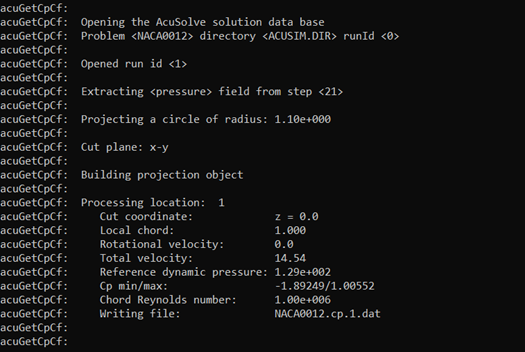

AcuGetCpCf
AcuGetCpCf is another utility script used to calculate the coefficient of pressure (Cp) and coefficient of friction (Cf) for the airfoil.
To execute the AcuGetCpCf script for this problem, follow the steps below:
  1. Start AcuSolve Command Prompt from the Start menu by clicking Start > Altair <version> > AcuSolve Cmd Prompt.
  2. Change the directory to the present problem directory using the cd command.
  3. Enter the following command at the prompt to extract Cp and save it to the file with the .dat extension.
    acuGetCpCf -osis "Airfoil - Output" -type cp -ref_vel 14.54 -ref_rho 1.225 -no_nc -ref_pres 0 –cut_dir z –rad_locs 0.0
    The cut_dir option describes the cut plane axis to calculate the Cp and Cf values. rad_locs describes the location of the cut plane on the cut_dir axis. The script prints the minimum and maximum values for the pressure coefficient. It also creates a file, NACA0012.cp.1.dat, in the problem directory. The file contains the pressure coefficient data along the chord of the airfoil. The first column is the x-coordinate along the chord, and the second column is the pressure coefficient.
    Figure 62.

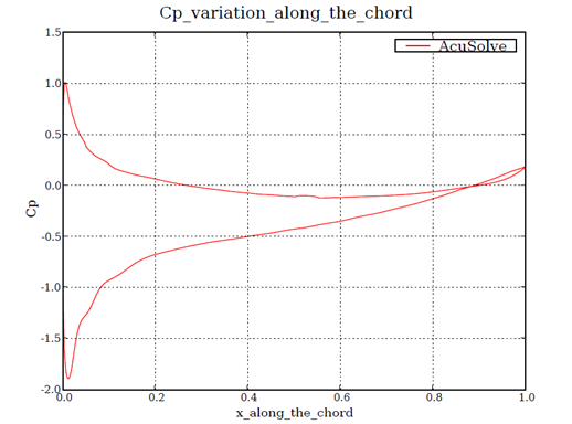

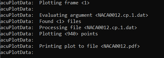

  4. Enter the following command at the prompt to plot the variation of Cp along the airfoil surface, or you can use an external plotting utility to the plot the data.
    acuPlotData -files NACA0012.cp.1.dat -x_col 1 -y_cols 2 -no_pts -ptf -lfmt "-r" -legend AcuSolve -title Cp_variation_along_the_chord -x_label x_along_the_chord -y_label Cp
    Figure 63.
    The plotting result is shown below:
    Figure 64.
