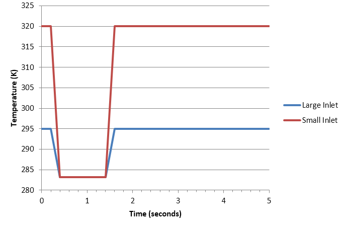

At 0.2s into the simulation, a cold slug of water is injected at both the inlets and the temperature is ramped down to 283.15 K starting from 0.2 s to 0.4 s. Then it is maintained constant at 283.15 K for 1 sec and then ramped up to initial states from 1.4s to 1.6s. Given a flow path of 0.6356 m, the transit time for the slug is approximately 1.6s. Therefore, our simulation time should be at least 3.2 s to factor in the duration of the slug and transit time. The total simulation time will be 4.5s to allow time for the thermal conditions to return to a steady state.
The temperature change at the large inlet is from 295 K to 283.15 K. At the small inlet, the temperature changes from 320 K to 283.15 K. The ratio of the cold slug temperature to the initial temperature of the large inlet flow is 0.9598. The ratio of the cold slug temperature to the initial temperature of the small inlet flow is 0.8848. These values will be used in creating multiplier functions to model the transient temperatures at the inlets.

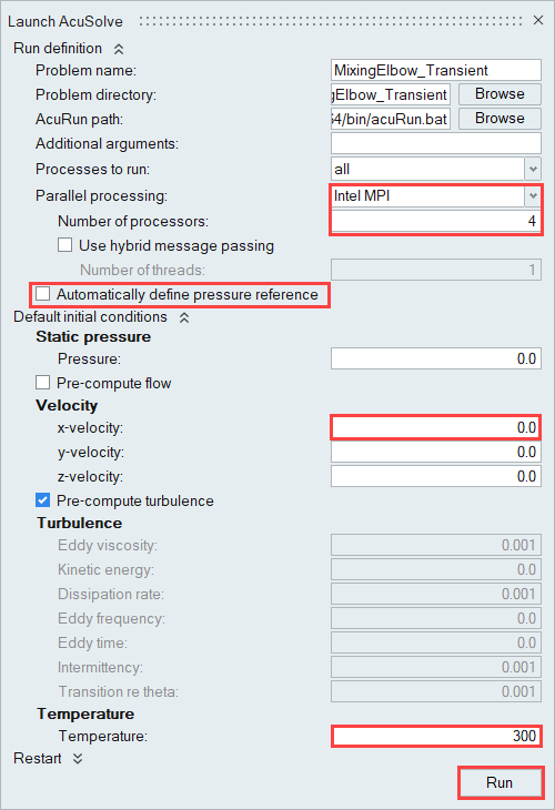

  1. From the Solution ribbon, click the Run tool.
    Figure 5.
    The Launch AcuSolve dialog opens.
  2. Set the Parallel processing option to Intel MPI.
  3. Optional: Set the number of processors to 4 or 8 based on availability.
  4. Deactivate the Automatically define pressure reference option.
  5. Expand the Default initial conditions drop-down and deactivate the Pre-compute flow option.
  6. Set the x-velocity to 0 and the Temperature to 300.
  7. Click Run to launch AcuSolve.

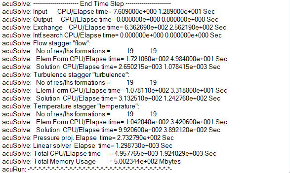

  8. In the Run Status dialog, right-click the AcuSolve run and select View log file.
  9. Once the solver run is complete, close the Run Status dialog.

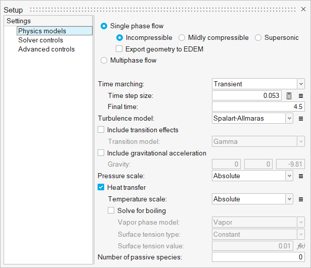

  2. Under the Physics models setting:
    1. Set Time marching to Transient.
    2. Set the Time step size to 0.053 and the Final time to 4.5.
    Figure 9.

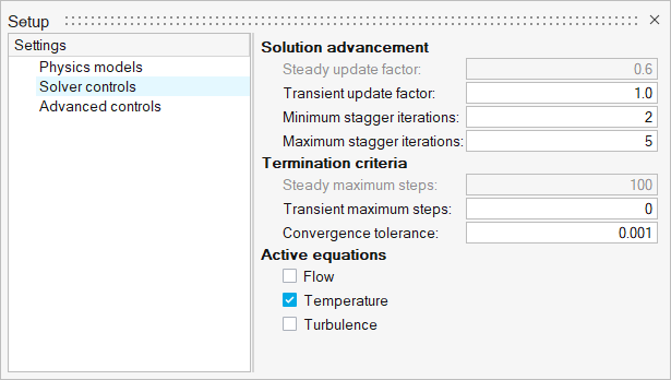

  3. Click the Solver controls setting.
  4. Set the Minimum and Maximum stagger iterations to 2 and 5, respectively.
  5. De-activate the Flow and Turbulence equations.
    By turning these options off, AcuSolve will not update the solution to these equations. Instead, the current flow and turbulence values (generated from the steady state solution for this tutorial) will be used throughout the simulation, and AcuSolve will only solve for the temperature field.
    Figure 10.

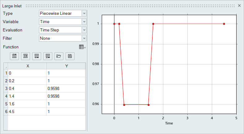

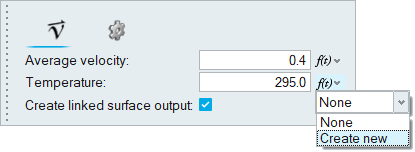

  3. In the microdialog, click multiplier function drop-down menu next to Temperature and select Create new.
    Figure 13.
  4. In the dialog that appears, edit the name of the multiplier function by clicking in the top-left corner. Set the name to Large Inlet.
  5. Set the Type to Piecewise Linear.
  6. Verify that the Variable is set to Time and Evaluation is set to Time Step.
  7. Click four times to add four new rows to the bottom of the table.
  8. Enter the table values for the multiplier function as shown in the image below.
    Figure 14.
  9. Close the dialog.

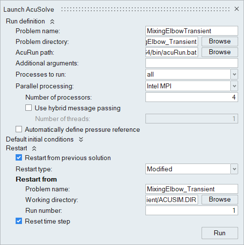

    Figure 18.
  5. Expand the Restart menu and activate the Restart from previous solution option.
  6. Set the Problem name to MixingElbow_Transient (if not set already).
  7. Verify that the Run number is set to 1 and the Reset time step option is activated.
  8. Click Run to start the transient run.

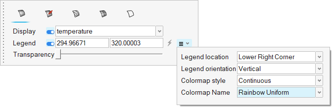

  6. Select all visible surfaces in the modeling window.
  7. In the display properties microdialog, set the display to temperature.
  8. Activate the Legend toggle and click to reset the range.
  9. Click and set the Colormap Name to Rainbow Uniform.

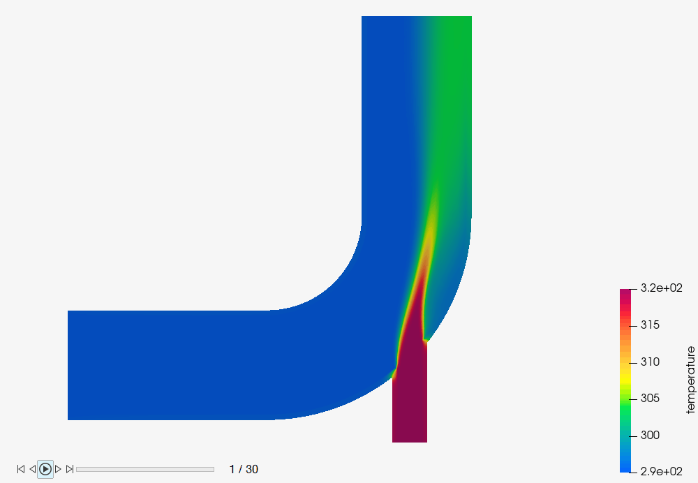

    Figure 22.
  10. Click on the guide bar.
  11. Click at the bottom of the modeling window to view an animation of the transient flow with respect to the temperature contour.
