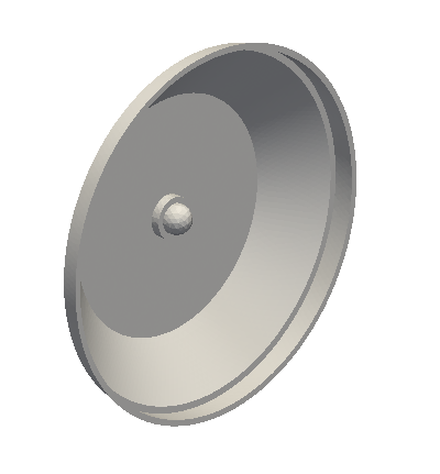

  1. From the menu bar, click File > Import > Geometry Model.
  2. In the Import File dialog, browse to your working directory and then select ACU-T3200_headlamp.x_t and click Open.
  3. In the Geometry Import Options dialog, leave all the default options unchanged and then click Import.

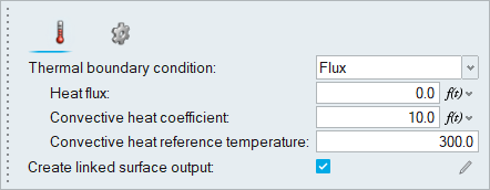

  3. In the microdialog, enter the values shown in the figure below.
    Figure 28.

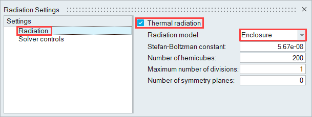

  2. Activate Thermal radiation and set the Radiation model to Enclosure (if not set already).
    Figure 30.
  3. Close the dialog.

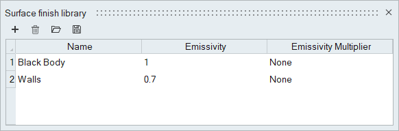

    The Surface finish library opens.
  2. Click to add a new emissivity model.
  3. Set the Name of the model to Walls and the Emissivity value to 0.7 by double-clicking on the entity fields.
    Figure 32.
  4. Close the dialog.

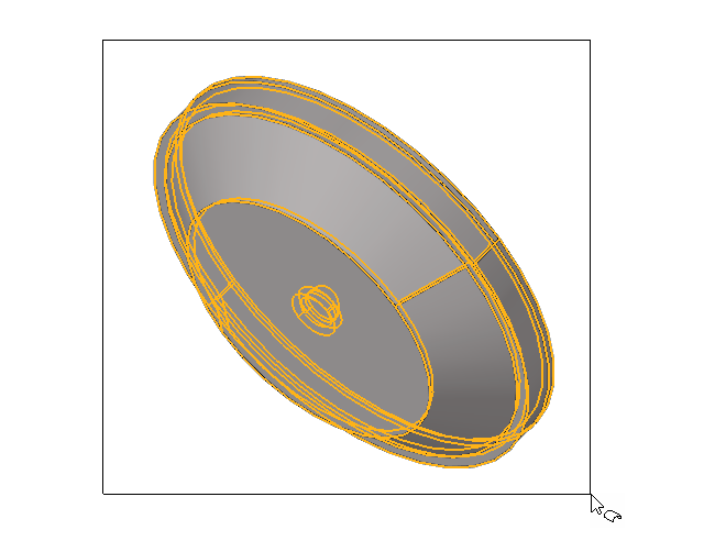

  2. Using the window selection method, select all the surfaces in the model.
    Figure 34.
  3. In the microdialog, assign the Walls emissivity model.

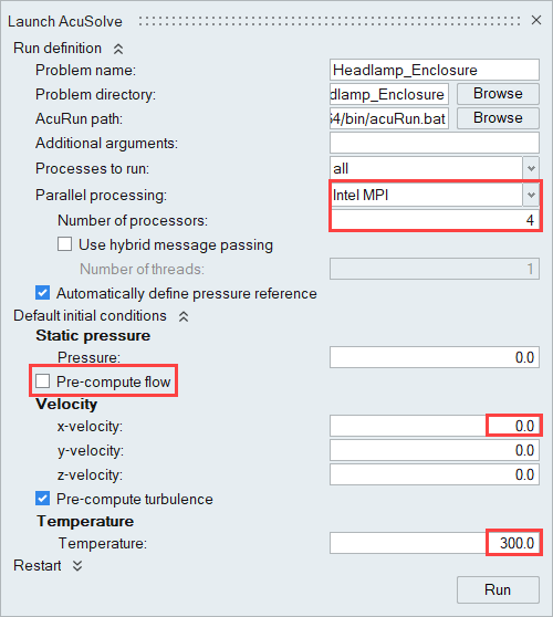

    The Launch AcuSolve dialog opens.
  2. Set the Parallel processing option to Intel MPI.
  3. Optional: Set the number of processors to 4 or 8 based on availability.
  4. Expand the Default initial conditions menu and deactivate the Pre-compute flow option.
  5. Set the x-velocity to 0 and the Temperature to 300.
  6. Leave the remaining options as default and click Run to launch AcuSolve.

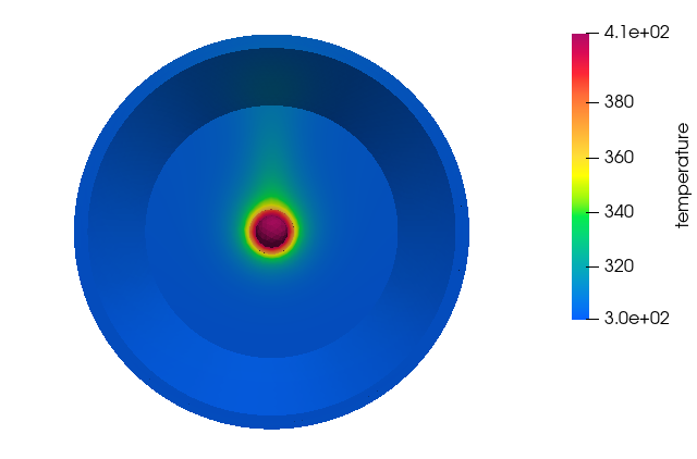

Post-Process the Results with HM-CFD Post
  1. Once the solution is completed, navigate to the Post ribbon.
  2. From the menu bar, click File > Open > Results.
  3. Select the AcuSolve .log file in your problem directory to load the results for post-processing.
    The solid and all the surfaces are loaded in the Post Browser.
  4. Hide the Outerwalls boundary surface in the Post Browser.
    Figure 44.

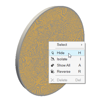

  5. Select the inner surface of the lens in the modeling window, right-click, and select Hide.
    Figure 45.
  6. Similarly, hide the outer fluid surface.
    You should end up with a view as shown below.
    Figure 46.

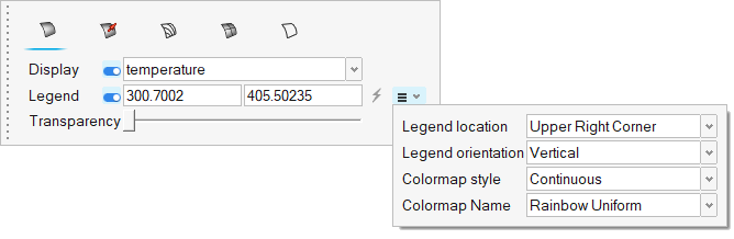

  9. In the display properties microdialog, set the display to temperature.
  10. Activate the Legend toggle and click to reset the range.
  11. Click , set the Legend location to Upper Right Corner, and the Colormap Name to Rainbow Uniform.
    Figure 48.
  12. Click on the guide bar.
  13. Click the Top face on the View Cube to align the model.
    Figure 49.
