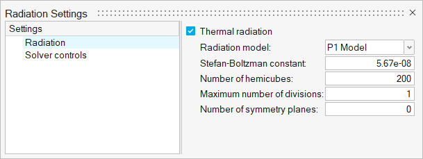

  1. From the Radiation ribbon, Thermal Radiation tools, click the Physics tool.
    Figure 13.
    The Radiation Settings dialog opens.
  2. Activate the Thermal radiation checkbox and set the Radiation model to P1 Model.
    Figure 14.

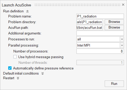

  1. From the Solution ribbon, click the Run tool.
    Figure 23.
  2. Set the Parallel processing option to Intel MPI.
  3. Optional: Set the number of processors to 4 or 8 based on availability.
  4. Leave the remaining options as default and click Run to launch AcuSolve.
    Figure 24.
