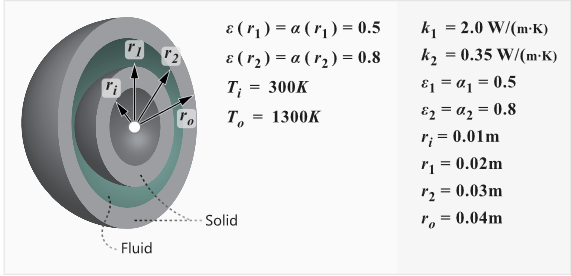

The problem to be addressed in this tutorial is shown schematically in Figure 1. In this problem, a DO radiation model is used to simulate the heat transfer due to radiation between concentric spheres. The inside surface of the inner and the outside surface of the outer sphere are both held at constant temperature while the gap between them radiates the heat from one sphere to the other.
The problem consists of a fluid region with arbitrary material properties between two concentric spheres with surfaces held at fixed temperature, as shown in the following figure, which is not drawn to scale. The radius of the outer sphere is 0.04 m and the radius of the inner sphere is 0.01 m. The inner surface of the inner sphere is defined to have a constant wall temperature at 300.0 K (26.85 ºC). The outer surface of the outer sphere is defined to have a constant wall temperature at 1300.0 K (1026.85 ºC). The fluid within the spheres is defined as a non-conducting material, allowing heat to transfer via radiation only.
The problem is solved as a steady state case to allow the heat transfer in the solid and fluid regions to reach an equilibrium.

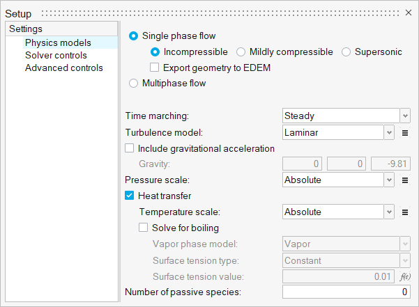

  2. Under the Physics models setting:
    1. Set Time marching to Steady.
    2. Set the Turbulence model to Laminar.
    3. Activate the Heat transfer checkbox.
    Figure 5.

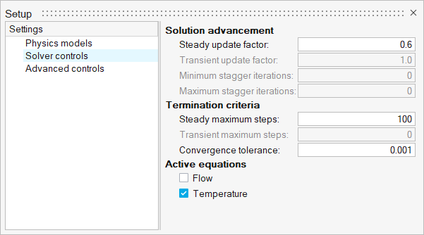

  3. Click the Solver controls setting.
  4. Deactivate the Flow checkbox.
    In this tutorial, you will only be solving for the temperature field.
    Figure 6.

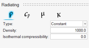

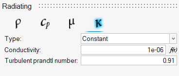

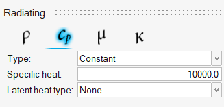

  4. In the new dialog, rename the material to Radiating by clicking the name in the top-left corner.
  5. Enter the following values for each of the material property tabs then close the dialog.
    • Density – 1000 kg/m3
    • Specific Heat – 10000 J/kg-K
    • Viscosity – 1e-5 kg/m-sec
    • Conductivity – 1e-6 W/m-K

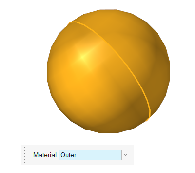

  2. Select the outer solid and assign the Outer material model from the microdialog.
    Figure 10.

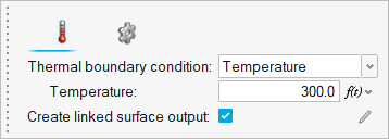

  3. Select the two faces remaining in the modeling window. In the microdialog, assign a Temperature boundary condition at 300 K.
    Figure 12.

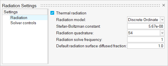

  1. From the Radiation ribbon, Thermal Radiation tools, click the Physics tool.
    Figure 13.
    The Radiation Settings dialog opens.
  2. Activate the Thermal radiation checkbox and set the Radiation model to Discrete Ordinate.
    Figure 14.
  3. Set the Radiation quadrature to S4.
  4. Verify that the Default radiation surface diffused fraction is set to 1.

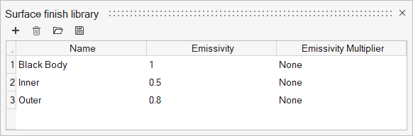

  2. Click .
  3. In the table, double-click Surface Finish, rename it to Inner, and the Emissivity to 0.5.
  4. Similarly, create another Emissivity model named Outer with an Emissivity of 0.8.

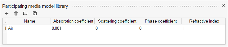

  6. Click and create a model with the following properties.
    Figure 18.

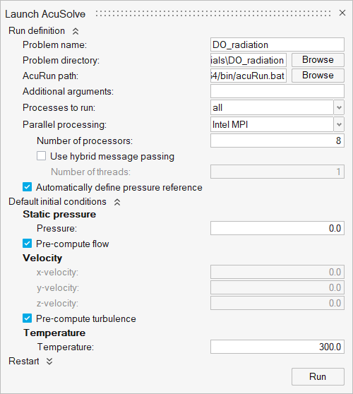

  2. Set the Parallel processing option to Intel MPI.
  3. Optional: Set the number of processors to 4 or 8 based on availability.
  4. Expand Default initial condition and set the Temperature to 300 K.
  5. Leave the remaining options as default and click Run to launch AcuSolve.

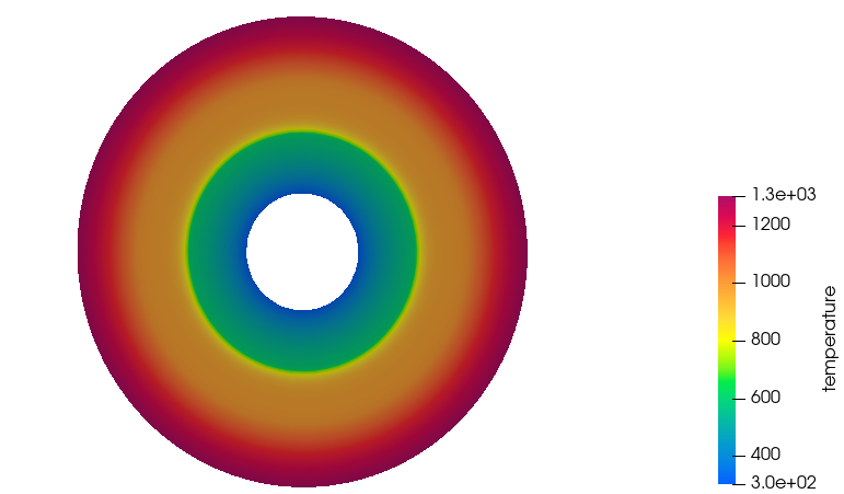

  5. Click the Slice Planes tool.
    Figure 26.
  6. Select the x-y plane in the modeling window.
  7. In the slice plane microdialog, click to create the slice plane.

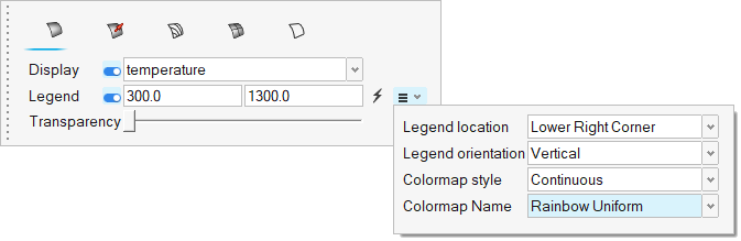

  8. In the display properties microdialog, set the display to Temperature and activate the Legend toggle.
  9. Click and set the Colormap Name to Rainbow Uniform.
    Figure 27.
  10. Click on the guide bar then press F to fit the section cut to the screen.
    Figure 28.
