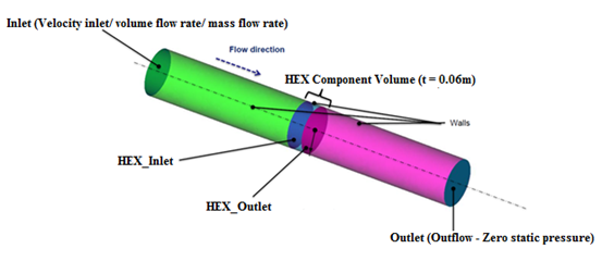

The problem to be addressed in this tutorial is shown schematically in the figure below. It consists of a cylindrical pipe channel with an interior heat exchanger component volume with thickness ‘t’. Air enters the pipe at a velocity of 0.1 m/sec and flows through the heat exchanger volume and then exits through the outlet. As the air flows through the heat exchanger component, heat is added to it from the coolant such that the total coolant heat reject is 200 W.

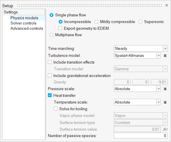

  1. From the Flow ribbon, click the Physics tool.
    Figure 4.
    The Setup dialog opens.
  2. Under the Physics models setting:
    1. Verify that Time marching is set to Steady.
    2. Select Spalart-Allmaras as the Turbulence model.
    3. Activate the Heat transfer checkbox.
    Figure 5.
  3. Close the dialog and save the model.

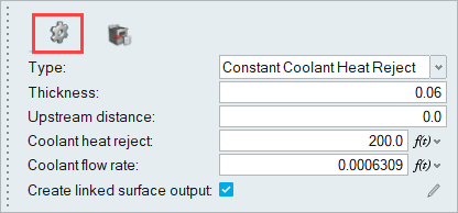

  4. In the microdialog, enter the following parameters:
    Figure 10.
    Figure 11.

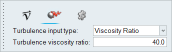

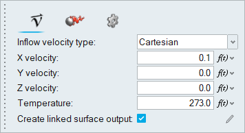

  3. In the microdialog, enter the following values for the Momentum and Turbulence tabs.
    Figure 14.
    Figure 15.

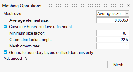

  2. In the Meshing Operations dialog, set the Mesh growth rate to 1.1 (if not set already).
    Figure 19.
  3. Click Mesh.

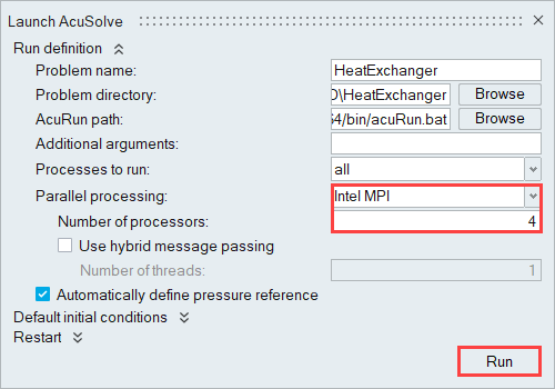

  1. From the Solution ribbon, click the Run tool.
    Figure 20.
    The Launch AcuSolve dialog opens.
  2. Set the Parallel processing option to Intel MPI.
  3. Optional: Set the number of processors to 4 or 8 based on availability.
  4. Leave the remaining options as default and click Run to launch AcuSolve.
    Figure 21.

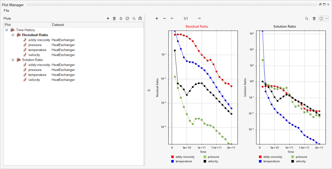

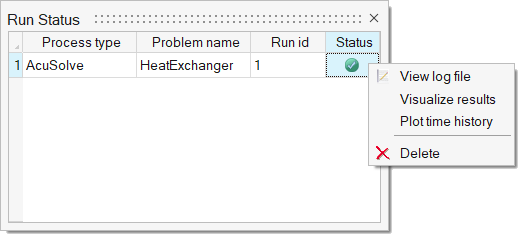

  1. In the Run Status dialog, right-click the AcuSolve run.
    Figure 22.
  2. Select Plot time history to plot the residual and solution ratios.
    Figure 23.

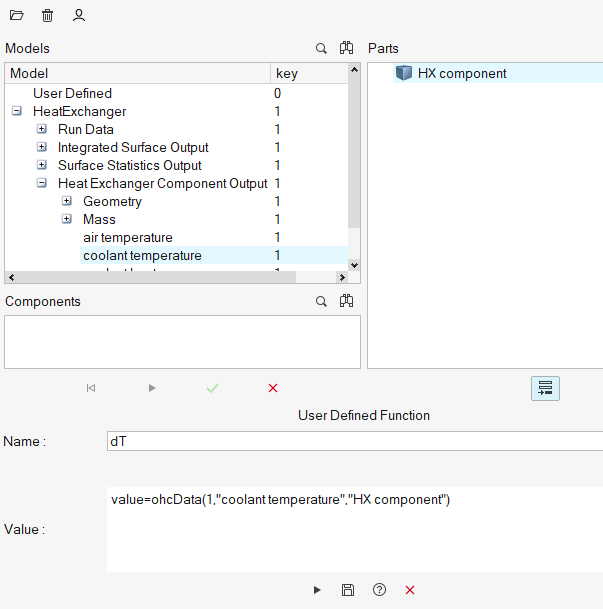

  3. Click to create a new plot.

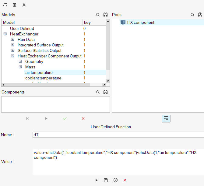

  4. Right-click User Defined under the Model panel to create a user defined function.
  5. In the Data Tree, expand Heat Exchanger Component Output and then select coolant temperature.
  6. In the Name field, enter dT.
  7. In the Value field, type value=.
  8. Under Parts, choose HX component and then click to insert the field as part of the value, as shown below.
    Figure 24.
  9. Type - at the end of the user defined function value.
  10. In the Data Tree, select air temperature, and then pick HX component and click to insert the field as part of the value.
  11. Click to add the user defined function.
    Figure 25.

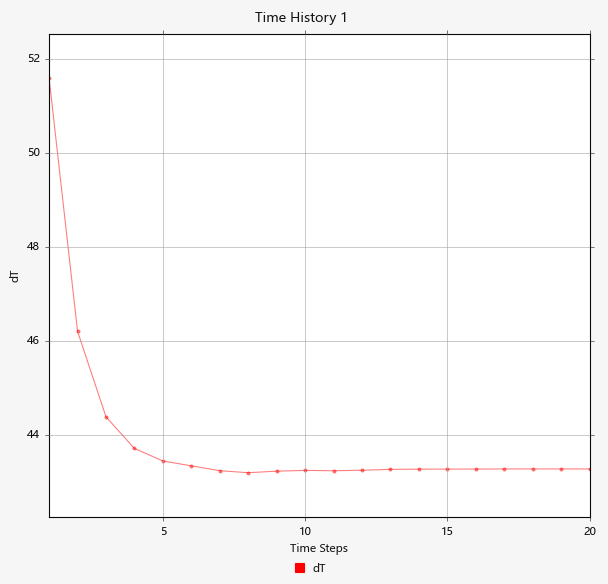

  12. Click the x axis to switch to Time Steps.
    Figure 26.
    As shown in the plot above, the temperature rise is 43.3K.
