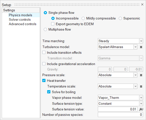

  2. Under the Physics models setting:
    1. Verify that Time marching is set to Steady.
    2. Select Spalart-Allmaras as the Turbulence model.
    3. Activate the Heat transfer checkbox.
    4. Click the Solve for boiling checkbox to activate Nucleate Boiling.
    5. Select Vapor_Therm for the Vapor phase model.
    6. Check that the Surface tension type is set to Constant and set the Surface tension value to 0.01.
    Figure 5.
  3. Close the dialog and save the model.

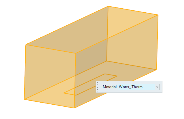

  2. Select the model solid.
  3. Select Water_Therm from the Material drop-down menu.
    Figure 7.
  4. On the guide bar, click to execute the command and exit the tool.

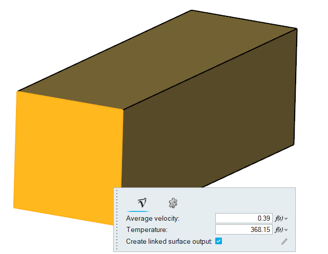

  1. From the Flow ribbon, Profiled tool group, click the Profiled Inlet tool.
    Figure 8.
  2. Click on the inlet face, highlighted in the figure below.
  3. In the microdialog, enter 0.39 for the Average velocity and 368.15 for the Temperature.
    Figure 9.

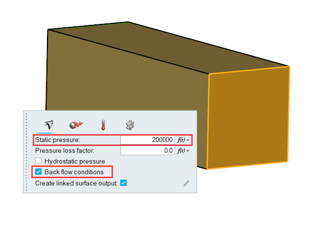

  5. Click the Outlet tool.
    Figure 10.
  6. Select the face highlighted in the figure below, set the Static pressure to 200000, and activate the Back flow conditions.
    Figure 11.

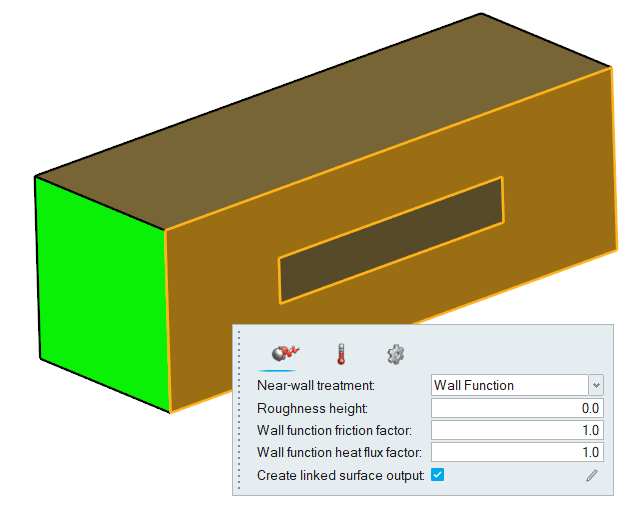

  9. Click the No Slip tool.
    Figure 13.
  10. Select the face highlighted in the figure below and then click on the guide bar.
    Figure 14.

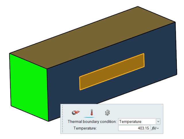

  11. Select the next face highlighted in the figure below.
  12. In the microdialog, click the Temperature tab, set the Thermal boundary condition to Temperature and set the temperature value to 403.15.
    Figure 15.
  13. Click on the guide bar.

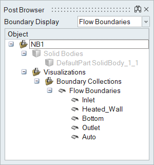

  14. In the Boundaries legend, double-click Wall 1 and rename it to Heated_Wall.
  15. Double-click Wall and rename it to Bottom.
    Figure 16.

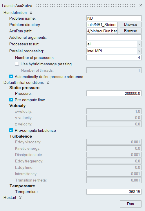

  2. Set the Parallel processing option to Intel MPI.
  3. Optional: Set the number of processors to 4 or 8 based on availability.
  4. Expand Default initial conditions and enter the values as shown below to define the initial conditions.
    Figure 20.
  5. Click Run to launch AcuSolve.
    The Run Status dialog opens. Once the run is complete, the status is updated and you can close the dialog.

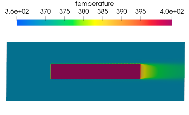

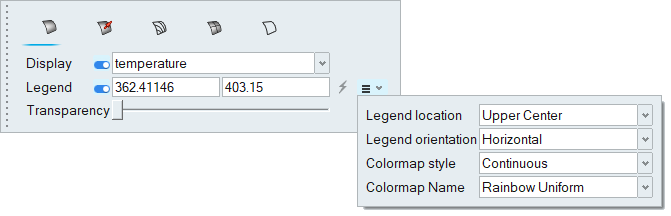

  4. To check the temperature contours on the Heated_Wall and Bottom surfaces, right-click those surfaces in the Post Browser and select Isolate.
  5. In the Post Browser, right-click Heated_Wall and Bottom again and select Edit.
    A surface coloring microdialog opens.
  6. Set the Display option to Temperature.
    Figure 23.
  7. Activate the Legend radio button and then click and set the legend properties as shown below.
    Figure 24.
    The temperature contours are displayed on the model.
    Figure 25.
