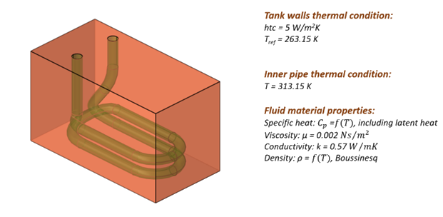

Problem Description
In this tutorial, a diesel exhaust additive, commonly known as Urea, is initially subjected to freezing conditions dictating that the fluid is frozen, T(Initial)=263.15 K. The fluid is then heated above its defined melting point by imposing a fixed thermal condition on the heating element. As the temperature within the enclosure exceeds the melting temperature of the material, the porosity effectiveness of the fluid decreases to 0.0, allowing the fluid to move under natural convection currents. Eventually the entire fluid volume becomes melted, reaching the temperature of the heating element. The time to melt is computed for the specified heating element temperature of 313.15 K. Note that the interface between the solid/fluid material is captured because of the material definition as defined with a linear temperature gradient spanning 2 degrees at the melting front.

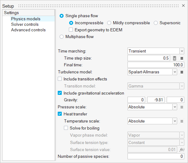

  2. Under the Physics models setting:
    1. Set Time marching to Transient.
    2. Set the Time step size to 0.5 seconds.

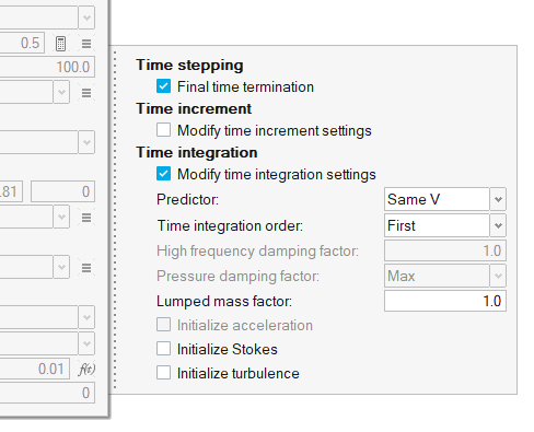

    3. Click beside the time step field and select Modify time integration settings. Set the Time integration order to First.
      Figure 5.
    4. Set the Final time to 100.0 seconds.
    5. Select Spalart-Allmaras as the Turbulence model.
    6. Activate Include Gravitational Acceleration and set it to [0.0, -9.81, 0.0] m/s2.
    7. Set the Pressure scale to Absolute.
    8. Active Heat transfer.
    9. Set the Temperature scale to Absolute.
    Figure 6.

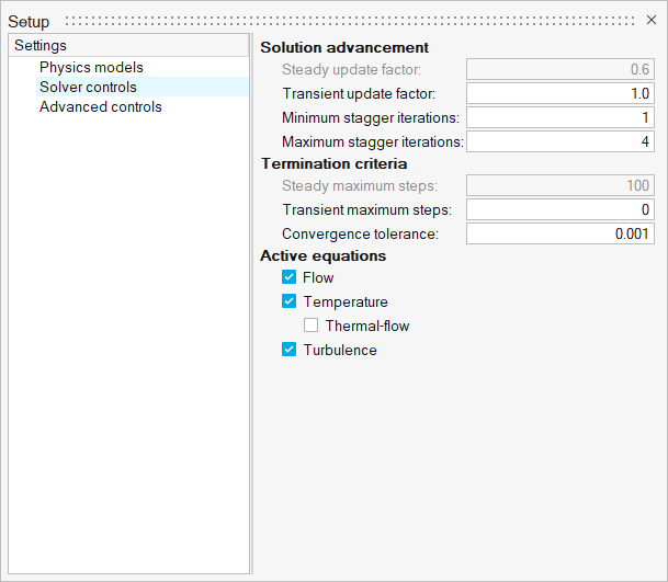

  3. Under the Advanced controls setting, set the minimum stagger iterations to 1 and the maximum to 4.
    Figure 7.

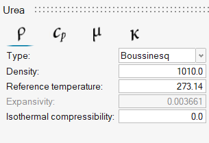

  4. Name the material Urea, set the density (ρ) type to Boussinesq and enter Density (kg/m3) and Reference temperature (K) values as shown below.
    Figure 9.

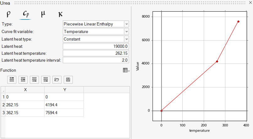

  5. Click the Specific Heat tab and set the Type to Piecewise Linear Enthalpy.
  6. Verify that the Curve fit variable is set to Temperature.
  7. Set the Latent heat type to Constant.
  8. Enter the values for Latent heat (J), Latent heat temperature (K), and Latent heat temperature interval (K) by referring to the figure below.
  9. Click three times to add three rows to the table and then enter the table values according to the figure below.
    Figure 10.

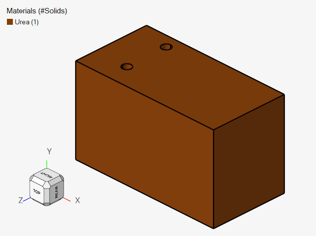

  13. From the Flow ribbon, click the Material tool.
    Figure 11.

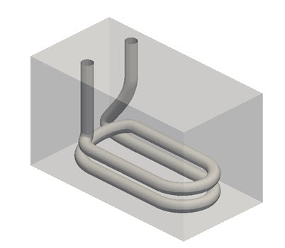

  14. Assign the Fluid material – Urea – to the tank volume, as shown in the figure below.
    Figure 12.

  2. Select the tank volume (urea fluid body).

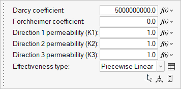

  4. Assign the Porous Media values according to the following figure.
    Figure 14.
  5. Click besides Effectiveness type.

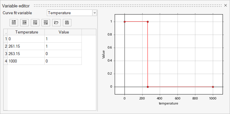

  6. In the new dialog, click four time to add four empty rows to the table then enter values according to the figure below.
    Figure 15.

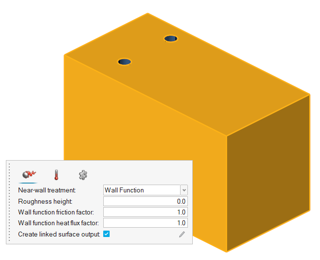

  2. Select the exterior faces of the plastic tank.
    Figure 17.

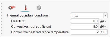

  3. In the microdialog, click the Temperature tab.
  4. Verify that the Thermal boundary condition is set to Flux.
  5. Set the Convective heat coefficient to 5.0 W/m2K.
  6. Set the Convective heat reference temperature to 263.15 K.
    Figure 18.

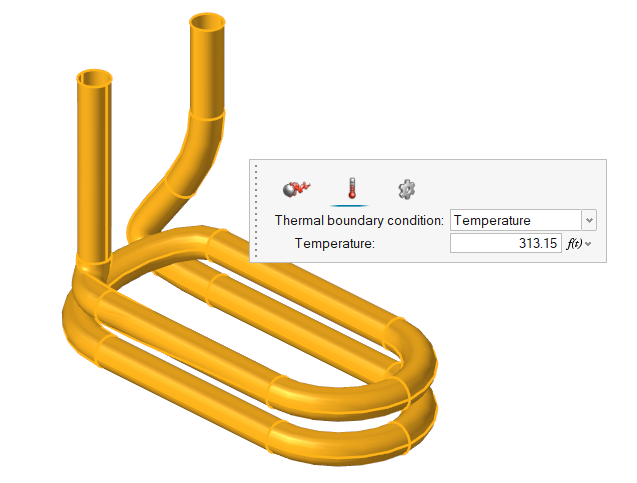

  9. Hide Exterior_Wall and select the interior faces of the heating element.
  10. In the microdialog, click the Temperature tab.
  11. Change the Thermal boundary condition to Temperature and set the Temperature (K) to 313.15.
    Figure 19.
  12. Double-click Wall in the legend and rename it to Pipe.
  13. Click on the guide bar.

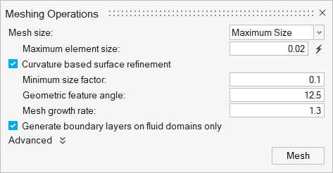

  1. From the Mesh ribbon, click the Volume tool.
    Figure 20.
  2. Set the Maximum element size (m) to 0.02 and verify the geometric feature angle (degree) is set to 12.5.
    Figure 21.
  3. Click Mesh.

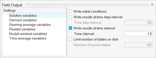

  1. Form the Solution ribbon, click the Field tool.
    Figure 22.
  2. Uncheck Write results at time step interval.
  3. Check Write results at time interval.
  4. Set the Time interval to 1 sec.
    Figure 23.

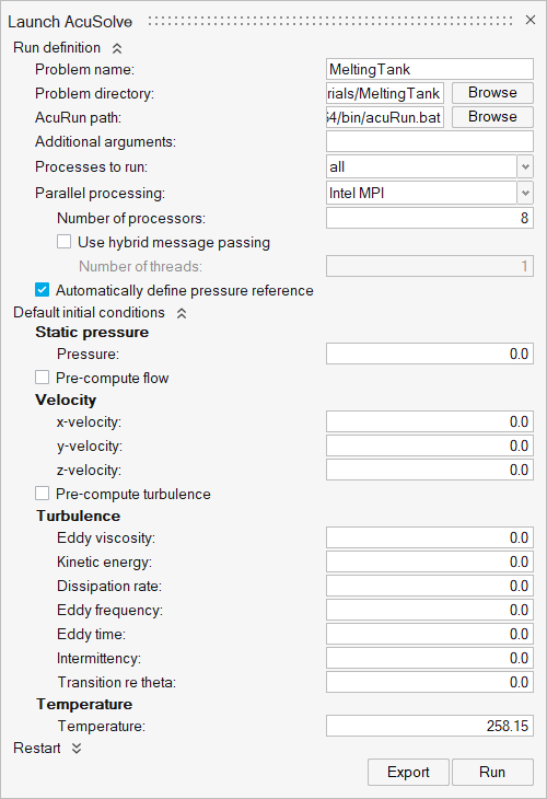

  1. From the Solution ribbon, click the Run tool.
    Figure 24.
    The Launch AcuSolve dialog opens.
  2. Set the Parallel processing option to Intel MPI.
  3. Optional: Set the number of processors to 4 or 8 based on availability.
  4. Set the Default initial conditions as in the following figure.
    Figure 25.
  5. Leave the remaining default options and then click Run to launch AcuSolve.

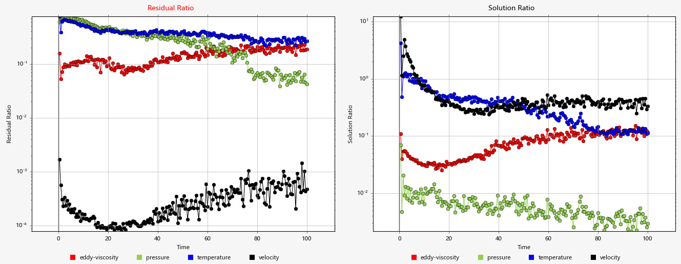

  2. In the Run Status dialog, right-click the AcuSolve run and select Plot time history to launch the Plot Manager.
    The residual and solution ratios for pressure, velocity, eddy viscosity, and temperature are shown.

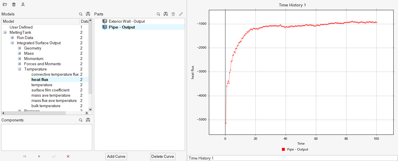

  4. Expand Integrated Surface Output > Temperature and select heat flux.
  5. Select Pipe – Output to plot the heat flux entering the domain from the heating element.
    Note: The value stabilizes near the end of the simulation, indicating that the model is approaching the prescribed thermal boundary conditions.
    Figure 28. Integrated heat flux entering the domain from the heating element surface

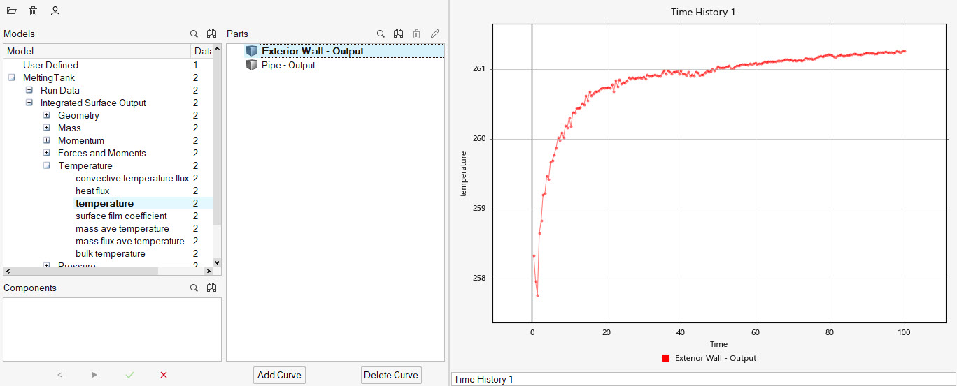

  6. Expand the Integrated Surface Output > Temperature > temperature.
  7. Select the Exterior Wall – Output to plot the temperature increase of the inside wall of the tank.
    Note: The value is not stabilized by the end of the simulation, indicating that the model has not reached the final temperature to balance the prescribed thermal boundary conditions.
    Figure 29. Integrated temperature on the interior surface of the tank wall

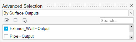

  3. Click on the guide bar to open the Advanced Selection dialog.
  4. Select Exterior_Wall - Output and then close the dialog.

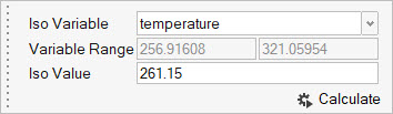

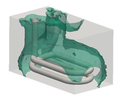

  8. Select temperature as the Iso Variable and set the Iso Value of temperature (K) to 261.15.
    Figure 33.
  9. Click Calculate.
  10. In the display properties microdialog, define the Display as constant and select a color of choice.
    Figure 34. Transparent boundary of the tank, showing an Iso-Surface of temperature T=261.15 K, Time=0.0 sec
  11. Using the results animation toolbar, skip to the end of the simulation results.
    Figure 35. Transparent boundary of the tank, showing an Iso-Surface of temperature T=261.15 K, Time=100.0 sec
