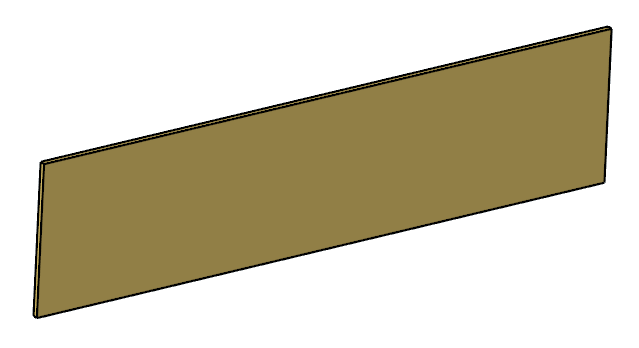

  1. From the menu bar, click File > Import > Geometry Model.
  2. In the Import File dialog, browse to your working directory and then select ACU-T4000_dambreak2D.x_t and click Open.
  3. In the Geometry Import Options dialog, leave all the default options unchanged and then click Import.
    Figure 3.
    Figure 4.

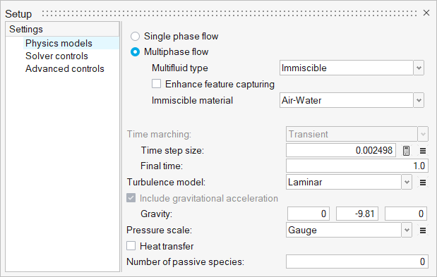

  2. Under the Physics models setting:
    1. Activate the Multiphase flow radio button.
    2. Set the Multifluid type to Immiscible and the Immiscible material to Air-Water.
    3. Set the Time step size to 0.002498 and the Final time to 1.0.
    4. Select Laminar as the Turbulence model.
    5. Set the gravity to -9.81 m/sec2 in the y direction.
    Figure 8.

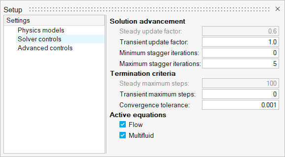

  3. Click the Solver Controls setting and set the Maximum stagger iterations to 5.
    Figure 9.

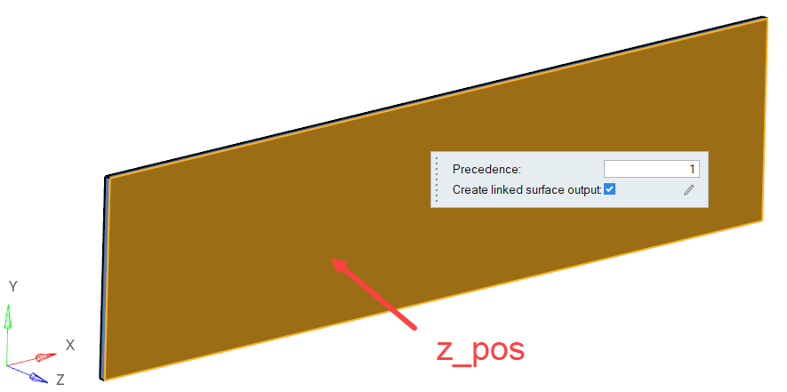

  1. From the Flow ribbon, click the Symmetry tool.
    Figure 11.
  2. Select the right most face on the positive z-axis, as shown in the figure below.
    Figure 12.
  3. In the Boundaries legend, double-click Symmetry, rename it to z_pos and press Enter.
  4. On the guide bar, click to execute the command and remain in the tool.
  5. Rotate the model and select the opposite face.
  6. In the Boundaries legend, rename Symmetry to z_neg.
  7. On the guide bar, click to execute the command and exit the tool.

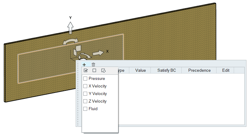

  3. In the microdialog, select Fluid and then click in empty space in the dialog. Change the Value field to Water.
    Figure 21.
  4. In the zone initialization microdialog, expand the drop-down and set the dimensions of the zone as shown in the figure below.

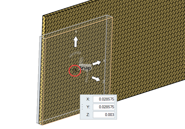

  5. Click the center of the manipulator on the model, as shown in the figure below, then enter the following coordinates for the center: 0.028575, 0.028575, 0.003.
    Figure 23.
    This will ensure that the fluid domain is initialized with a water column at the corner of the dam.

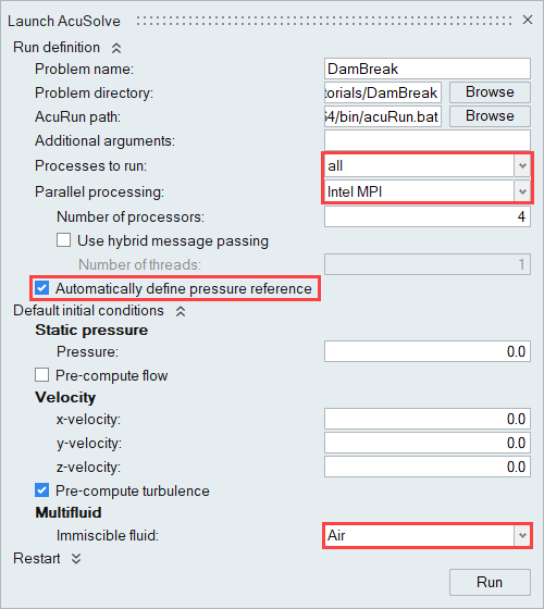

    The Launch AcuSolve dialog opens.
  2. Set the Parallel processing option to Intel MPI.
  3. Optional: Set the number of processors to 4 or 8 based on availability.
  4. Verify that the Automatically define pressure reference option is active.
  5. Expand the Default initial conditions tab and deactivate the Pre-compute flow option.
  6. Set all the velocity components to 0 and set the Immiscible fluid to Air (if not already set).
  7. Leave the remaining options as default and click Run to launch AcuSolve.
    Figure 25.

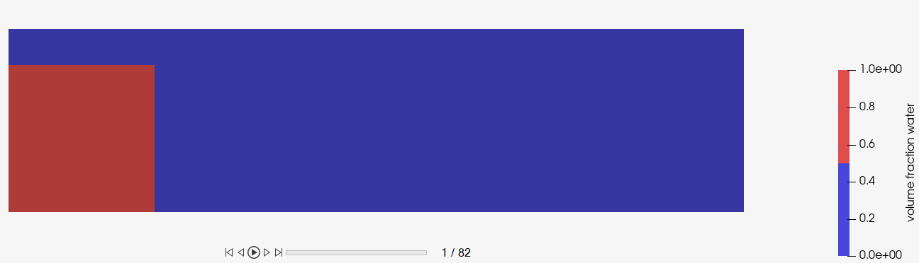

    The solid and all the surfaces are loaded in the Post Browser.
  4. Click the Top face on the View Cube to align the model.
    Figure 26.
  5. Right-click the z_pos boundary in the Post Browser and select Edit.
  6. In the display properties microdialog, set the display to volume fraction water.
  7. Activate the Legend toggle and click to refresh the range.
  8. Click , set the Colormap style to Filled, the Number of colors to 2, and the Colormap Name to Rainbow Desaturated.
    Figure 27.
  9. Click on the guide bar.
  10. Click at the bottom of the modeling window to view a live animation of the flow.
    Figure 28.
