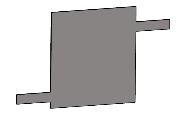

  1. From the menu bar, click File > Import > Geometry Model.
  2. In the Import File dialog, browse to your working directory then select ACU-T4001_tank2D.x_t and click Open.
  3. In the Geometry Import Options dialog, leave all the default options unchanged and then click Import.

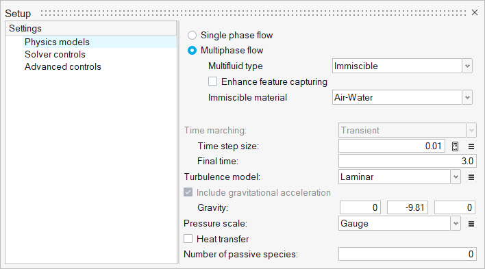

  1. From the Flow ribbon, click the Physics tool.
    Figure 7.
    The Setup dialog opens.
  2. Under the Physics models setting:
    1. Activate the Multiphase flow radio button.
    2. Set the Multifluid type to Immiscible and the Immiscible material to Air-Water
    3. Set the Time step size to 0.01 and the Final time to 3.0
    4. Select Laminar as the Turbulence model.
    5. Set the gravity to -9.81 m/sec2 in the y direction.
    Figure 8.

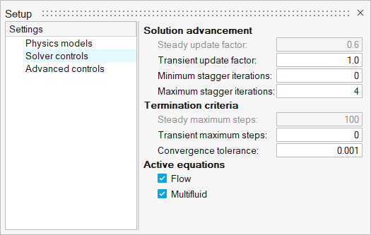

  3. Click the Solver Controls setting and set the Maximum stagger iterations to 4.
    Figure 9.

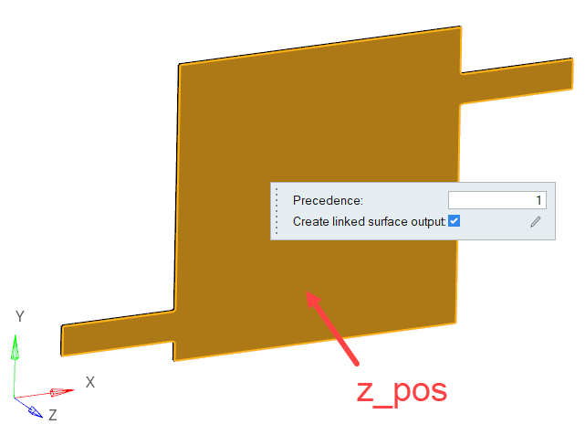

  1. From the Flow ribbon, click the Slip tool.
    Figure 11.
  2. Select the right most face on the positive z-axis, as shown in the figure below.
    Figure 12.
  3. In the Boundaries legend, double-click Slip, rename it to z_pos and press Enter.
  4. On the guide bar, click to execute the command and remain in the tool.
  5. Rotate the model and select the opposite face.
  6. In the Boundaries legend, rename Slip to z_neg.
  7. On the guide bar, click to execute the command and exit the tool.

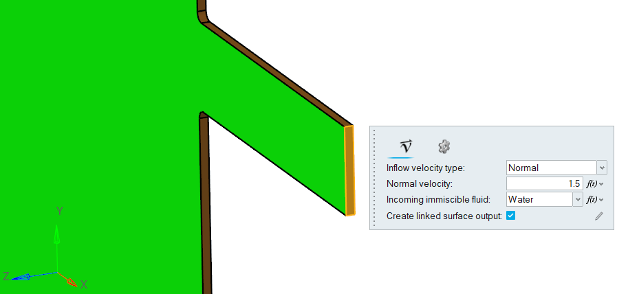

  8. Click the Constant tool.
    Figure 13.
  9. Select the inlet surface shown in the figure below.
    Figure 14.
  10. In the microdialog,
    1. Set the Inflow velocity type to Normal.
    2. Set the Normal velocity to 1.5 m/s.
    3. Select Water as the incoming immiscible fluid.
  11. On the guide bar, click to execute the command and exit the tool.

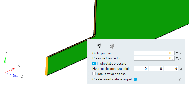

  12. Click the Outlet tool.
    Figure 15.
  13. Select the outlet surface shown in the figure below.
    Figure 16.
  14. In the microdialog, activate Hydrostatic pressure.
  15. On the guide bar, click to execute the command and exit the tool.

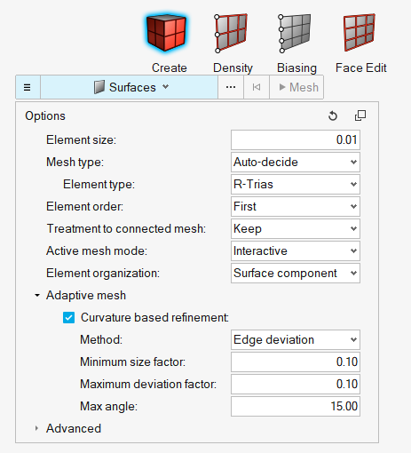

  1. From the Mesh ribbon, click the Interactive tool.
    Figure 17.
    By default, the Create should be selected from the secondary ribbon.
  2. Click on the guide bar to open the options menu, and then make the following changes:
    1. Set the Element size to 0.01.
    2. Set the Element type to R-Trias.
    3. Expand Adaptive mesh and activate the Curvature based refinement option.
      Leave the remaining settings unchanged.
    Figure 18.

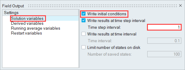

  1. From the Solution ribbon, click the Field tool.
    Figure 21.
    The Field Output dialog opens.
  2. Click the Solution variables setting.
  3. Activate the Write initial conditions option.
  4. Verify that the Write results at time step interval option is active.
  5. Set the Time step interval to 1.
    Figure 22.

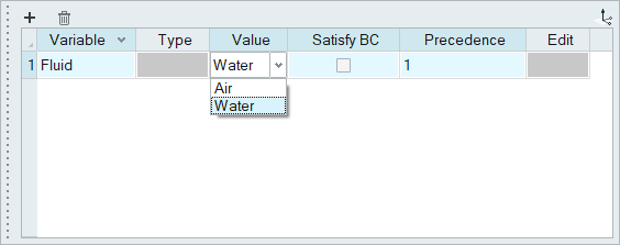

  1. From the Solution ribbon, click the Plane tool.
    Figure 23.
  2. Click the tank solid and verify the selection on the guide bar.
    Figure 24.
  3. Click Plane on the guide bar then click anywhere near the center of the solid.
  4. In the microdialog, click in the top-left corner, select Fluid, and then click in empty space in the dialog.
  5. Change the Value field to Water.
    Figure 25.

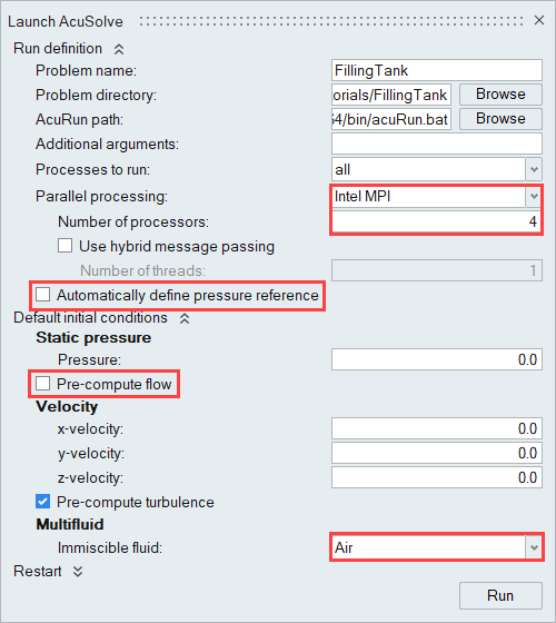

  2. Set the Parallel processing option to Intel MPI.
  3. Optional: Set the number of processors to 4 or 8 based on availability.
  4. Deactivate the Automatically define pressure reference option.
  5. Expand the Default initial conditions tab and deactivate the Pre-compute flow option.
  6. Set the x-velocity to 0.
  7. Set the Immiscible fluid to Air (if not already set).
  8. Leave the remaining options as default and click Run to launch AcuSolve.
    Figure 29.

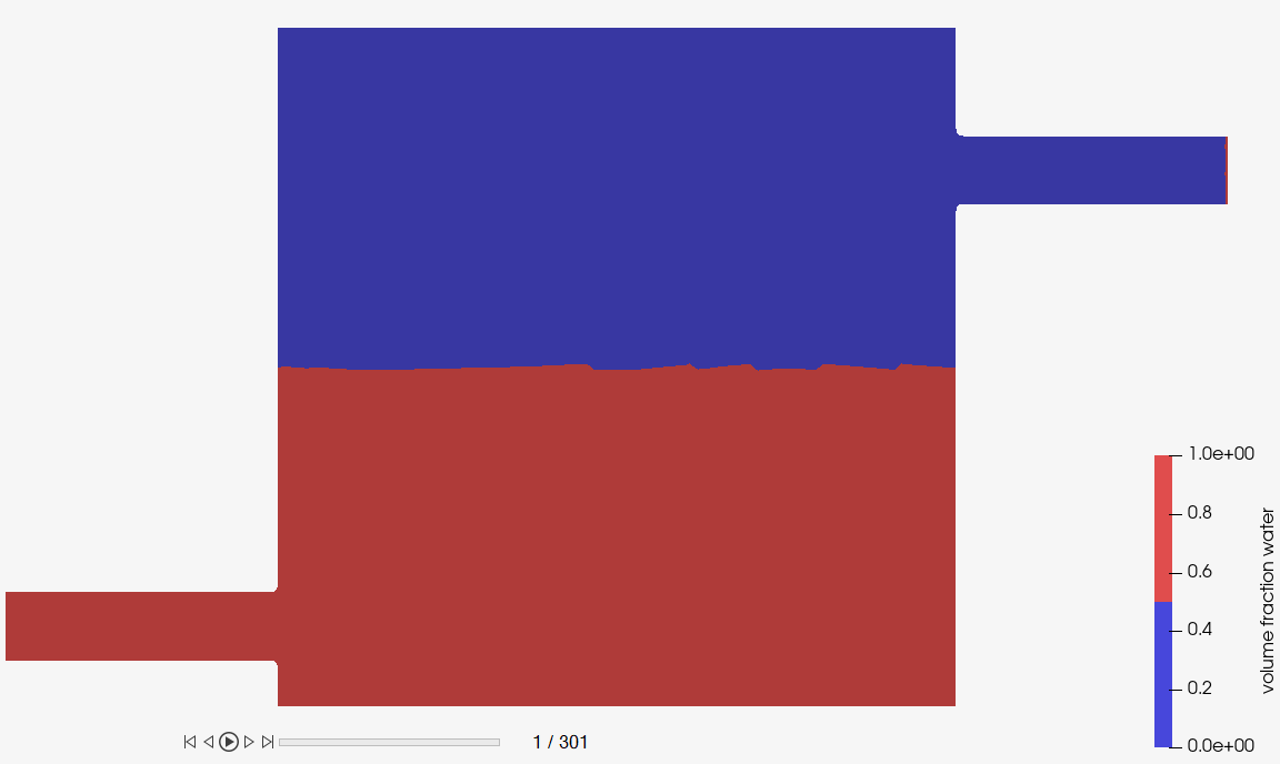

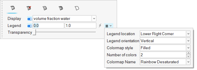

  5. Right-click the z_pos boundary in the Post Browser and select Edit.
  6. In the display properties microdialog, set the display to volume fraction water.
  7. Activate the Legend toggle and click to refresh the range.
  8. Click , set the Colormap style to Filled, the Number of colors to 2, and the Colormap Name to Rainbow Desaturated.
    Figure 31.
  9. Click on the guide bar.
  10. Click at the bottom of the modeling window to view a live animation of the flow.
    Figure 32.
