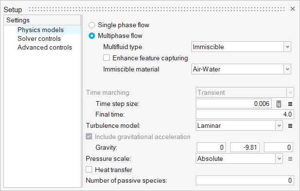

  2. Under the Physics models setting:
    1. Activate the Multiphase flow radio button.
    2. Set the Multifluid type to Immiscible and the Immiscible material to Air-Water.
    3. Set the Time step size to 0.006 and the Final time to 4.0.
    4. Select Laminar as the Turbulence model.
    5. Set the gravity to -9.81 m/sec2 in the y direction.
    6. Select Absolute for the Pressure scale.
    Figure 5.

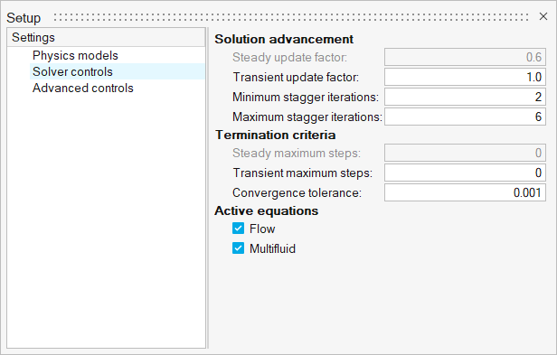

  3. Click the Solver Controls setting.
    1. Set the Minimum stagger iterations to 2.
    2. Set the Maximum stagger iterations to 6.
    Figure 6.

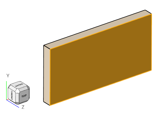

  1. From the Flow ribbon, click the No Slip tool.
    Figure 10.
  2. Select all four surfaces shown in the figure below.
    Figure 11.
  3. Click on the guide bar.

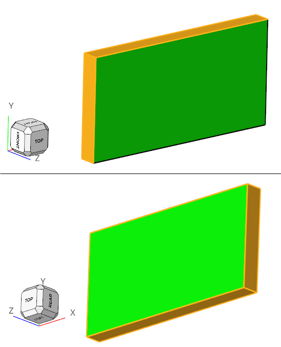

  4. Click the Slip tool.
    Figure 12.
  5. Select the right most face on the positive z-axis, as shown in the figure below.
    Figure 13.
  6. In the Boundaries legend, double-click Slip, rename it to z_pos, and then press Enter.
  7. On the guide bar, click to execute the command and remain in the tool.
  8. Rotate the model and select the opposite face.
  9. In the Boundaries legend, rename Slip to z_neg.
  10. Click on the guide bar.

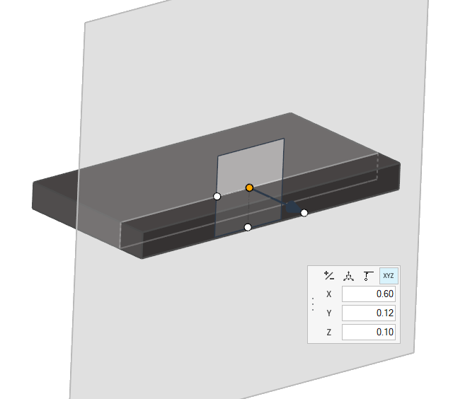

  1. From the Solution ribbon, click the Plane tool.
    Figure 14.
  2. Select the solid body.
  3. Click Plane on the guide bar.
  4. Click any point on the model to initially position the plane.
  5. Click in the microdialog and manually set the plane axis to Y.
    Figure 15.
  6. Click and set the coordinates to (0.60, 0.12, 0.10).
    Figure 16.

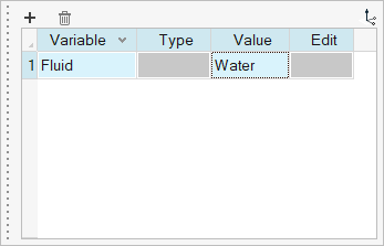

  8. Click to add a variable and then select Fluid from the list.
  9. Make sure that the Value is set to Water and then press Esc again.

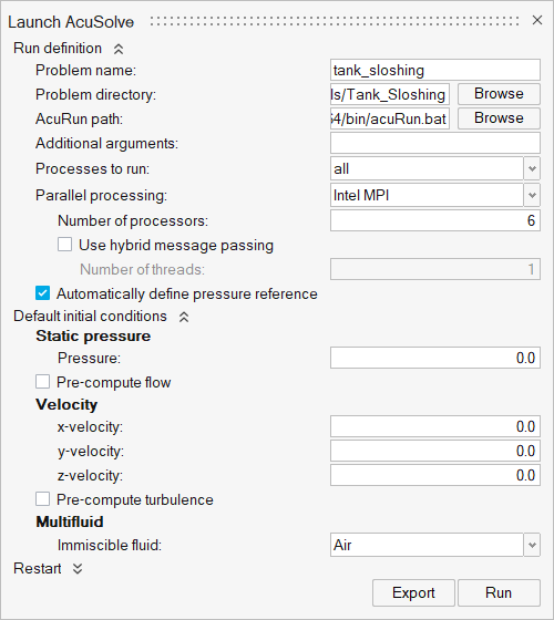

  1. From the Solution ribbon, click the Run tool.
    Figure 20.
    The Launch AcuSolve dialog opens.
  2. Set the Parallel processing option to Intel MPI.
  3. Optional: Set the number of processors to 4 or 8 based on availability.
  4. Expand the Default initial conditions tab and deactivate the Pre-compute flow and Pre-compute turbulence options.
  5. Set the x-velocity to 0.
  6. Leave the remaining options as default and click Run to launch AcuSolve.
    Figure 21.

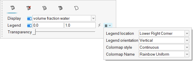

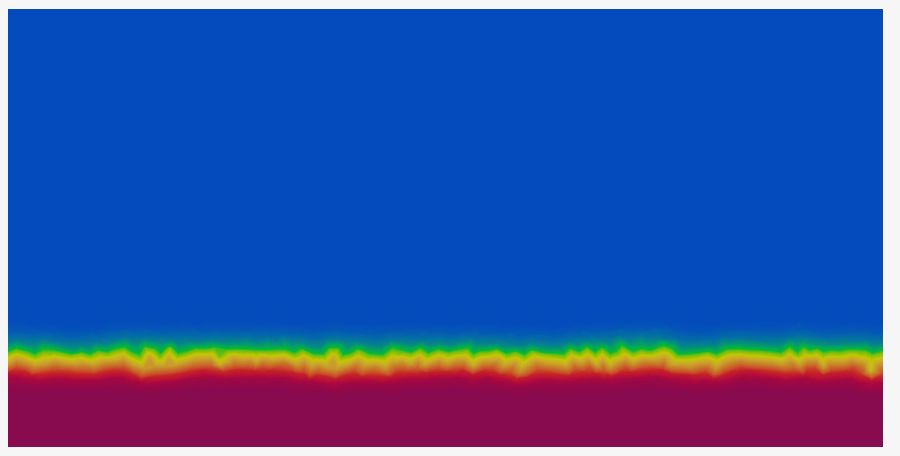

  5. Right-click on the z_pos boundary in the Post Browser and select Edit.
  6. In the display properties microdialog, set the display to volume fraction water.
  7. Activate the Legend toggle and click to refresh the range.
  8. Click , and set the Colormap Name to Rainbow Uniform.
    Figure 23.
  9. Click on the guide bar.
  10. Click at the bottom of the modeling window to view a live animation of the flow.
