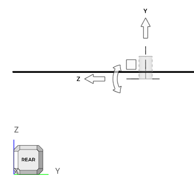

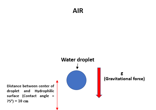

The problem to be addressed in this tutorial is shown schematically in the figure below. In this problem, a water droplet with 2 mm diameter falls freely under gravity. Given the small drop radius, surface tension and contact angle as the imposed wall treatment play a significant role to recover the drop shape after the impact. You will use AcuSolve to simulate the different developing drop shapes after impacting the wall.
Note: The schematic is not of exact scale.

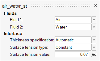

  4. In the new dialog, rename the material to air_water_st by clicking the name in the top-left corner, then enter the properties shown below.

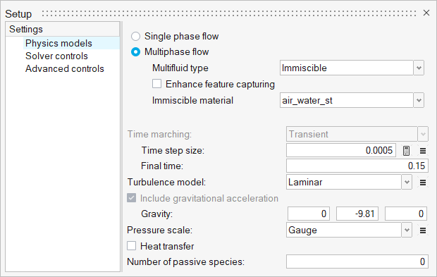

  2. Under the Physics models setting:
    1. Activate the Multiphase flow radio button.
    2. Set the Multifluid type to Immiscible and the Immiscible material to air_water_st.
    3. Set the Time step size to 0.0005 and the Final time to 0.15.
    4. Select Laminar as the Turbulence model.
    5. Set the gravity to -9.81 m/sec2 in the y direction.

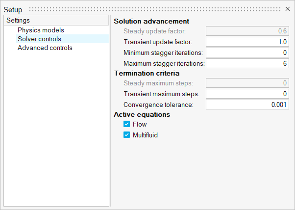

  3. Click Solver controls and verify the following:
    • Minimum stagger iterations: 0
    • Maximum stagger iterations: 6
    • The Flow and Multifluid checkboxes are activated.
    Figure 8.

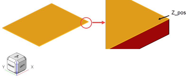

  3. Select the Z-Positive face, as highlighted below.
    Figure 11.
  4. In the Boundaries legend, double-click Symmetry and rename it to Z_pos.

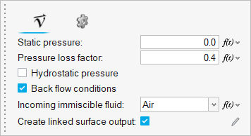

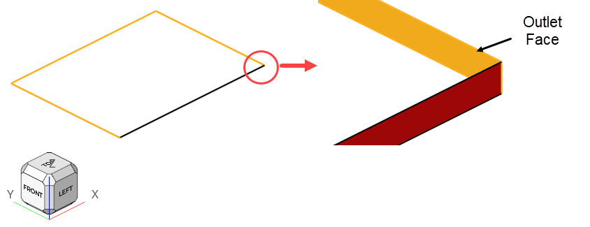

  12. Select the top and side faces, as highlighted below.
    Figure 13.
  13. In the microdialog, set the following properties and then click on the guide bar.

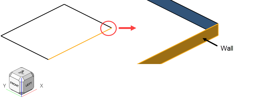

  14. Click the No Slip tool.
    Figure 15.
  15. In the Boundaries legend, Isolate the Default Wall then Show the Outlet faces.
  16. Select the face highlighted below.
    Figure 16.

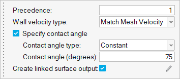

  17. In the microdialog, activate the Specify contact angle checkbox, set the Contact angle value to 75, and then click on the guide bar.

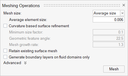

  1. From the Mesh ribbon, click the Volume tool.
    Figure 18.
    The Meshing Operations dialog opens.
  2. Check that the Average element size is 0.006.
  3. Accept all other default parameters.
    Figure 19.
  4. Click Mesh.

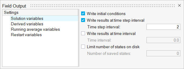

  1. From the Solution ribbon, click the Field tool.
    Figure 20.
    The Field Output dialog opens.
  2. Click the Solution variables setting.
  3. Activate the Write initial conditions checkbox.
  4. Verify that the Write results at time step interval checkbox is active.
    Figure 21.

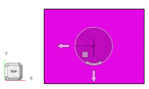

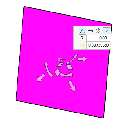

  1. From the Solution ribbon, Zones tool group, click the Cylinder tool.
    Figure 22.
  2. Select the Top face on the View Cube to orient the model.
  3. Double-click the geometry to create the cylinder-shaped zone and then press Esc.
    Figure 23.

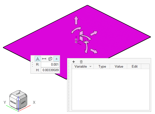

  4. To provide the dimensions of the cylinder, right-click Nodal initial condition cylinder in the legend and select Edit.

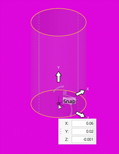

  5. In the microdialog, click the icon on the right to expand the menu, and then set the radius to 0.001 and the height to 0.00339589.
    Figure 24.
  6. Click on the View Controls toolbar and select Isometric.
    Figure 25.
  7. Zoom in on the zone and select the base point of the cylinder, as shown in the figure below. Set the coordinates to (0.06, 0.02, -0.001).

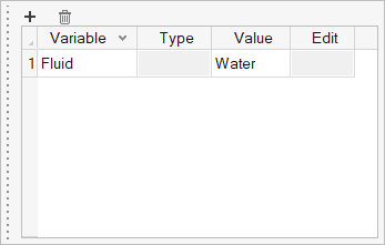

  9. In the initial condition dialog, click , select Fluid, and then left-click in empty space.
  10. Change the fluid to Water.
    Figure 28.

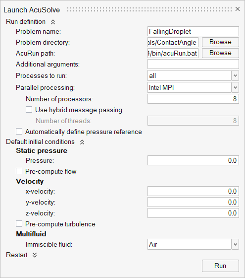

  2. Set the Parallel processing option to Intel MPI.
  3. Optional: Set the number of processors to 4 or 8 based on availability.
  4. Leave the remaining options as default and click Run to launch AcuSolve.

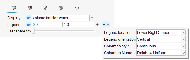

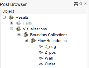

  4. To check the contours of volume fraction of water on the solid, right-click Z_pos in the Post Browser and select Isolate.
  5. Right-click Z_pos again and select Edit.
    A microdialog for surface coloring opens.

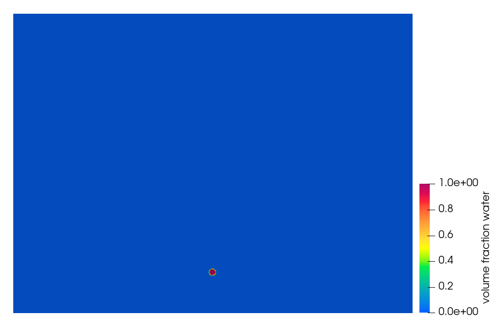

  6. Set the display to volume fraction water and toggle on the Legend radio button.
  7. Click in the same dialog to verify the legend properties shown below.
    You will be able to see the contours of volume fraction of water at time step=1.
    Figure 32.

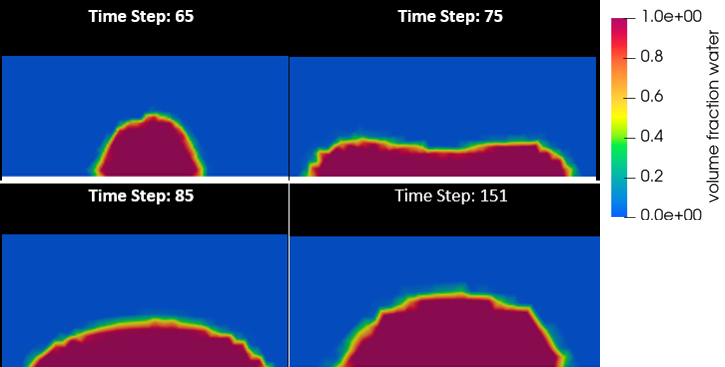

  8. Make sure the time scale at the bottom of the modeling window is at time step =1. Click the bar to see the falling of droplet and interaction of it with surface at time step = 65, 75, 85 and final time step (where 1 time step = 2 secs).
    Figure 34.
    Figure 35.
