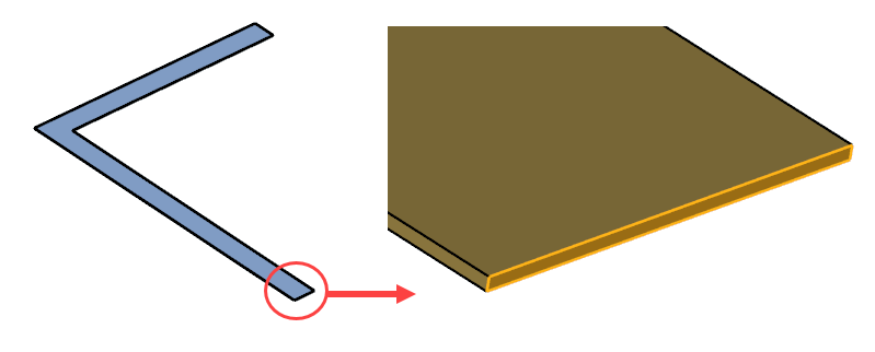

Problem Description
The problem to be addressed in this tutorial is shown schematically in Figure 1. The Algebraic Eulerian (AE) model is used to simulate the momentum exchange between a carrier field and a dispersed field. When simulating multiphase flows using the AE model, the carrier field has to be a heavier fluid (or higher density fluid).
In this problem, Water is considered a Carrier field material and Air is considered as Dispersed field material. Fluid enters the Inlet at an Average Velocity of 1 m/sec and the Water and Air volume fractions at the inlet are 96% and 4% respectively.

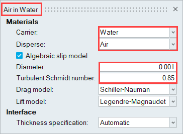

  2. Under Settings, click Disperse Multiphase, and then click the My Materials tab.
  3. Click to create a new material.
  4. Name the material Air in Water and assign the properties shown below.
    Figure 5.

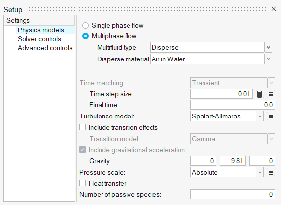

  1. From the Flow ribbon, click the Physics tool.
    Figure 6.
    The Setup dialog opens.
  2. Under the Physics models setting:
    1. Activate the Multiphase flow radio button.
    2. Set the Multifluid type to Disperse and the Disperse material to Air in Water
    3. Set the Time step size to 0.01.
    4. Select Spalart-Allmaras as the Turbulence model.
    5. Set the gravity to -9.81 m/sec2 in the y direction.
    Figure 7.

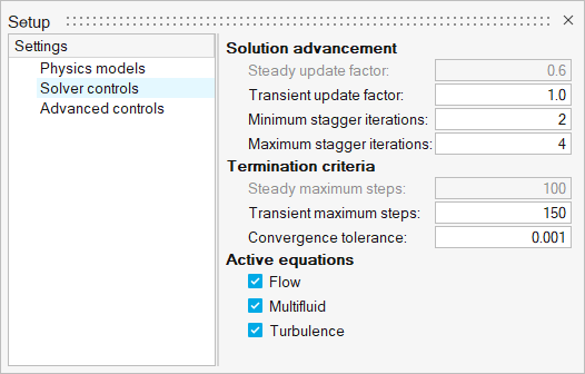

  3. Click the Solver controls setting and verify that:
    1. Minimum stagger iteration is set to 2.
    2. Maximum stagger iteration is set to 4.
    3. Transient maximum step is set to 150.
    4. The Flow, Multifluid, and Turbulence checkboxes are activated.
    Figure 8.

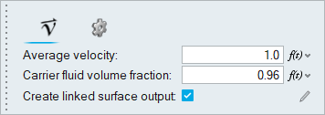

  1. From the Flow ribbon, Profiled tool group, click the Profiled Inlet tool.
    Figure 11.
  2. Click the inlet face, highlighted in the figure below.
    Figure 12.
  3. In the microdialog, enter 1.0 for the Average velocity and 0.96 for the Carrier fluid volume fraction.
    Figure 13.
  4. On the guide bar, click to execute the command and exit the tool.

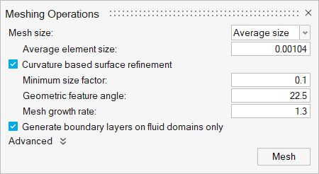

  1. From the Mesh ribbon, click the Volume tool.
    Figure 18.
  2. In the Meshing Operations dialog, set the Average Element size to 0.00104 (if not set already).
    Figure 19.
  3. Click Mesh.
    The Run Status dialog opens. Once the run is complete, the status is updated and you can close the dialog.

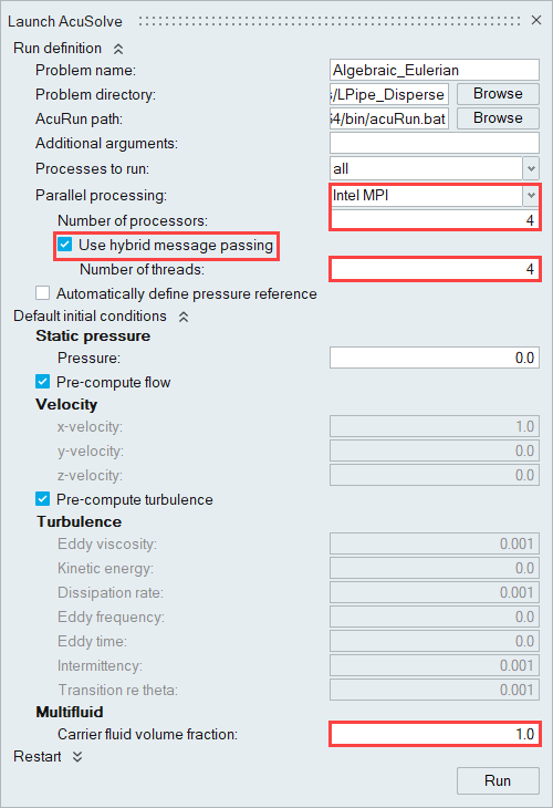

  1. From the Solution ribbon, click the Run tool.
    Figure 20.
    The Launch AcuSolve dialog opens.
  2. Set the Parallel processing option to Intel MPI.
  3. Optional: Set the number of processors to 4 or 8 based on availability.
  4. Check the box for Use hybrid message passing and set the number of threads to the same as the number of processors.
  5. Expand Default initial conditions and verify that the Carrier field volume fraction is 1.0.
    Figure 21.
  6. Click Run to launch AcuSolve.

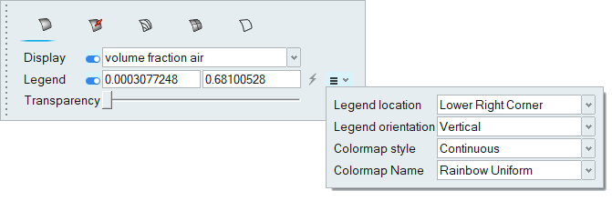

  4. In the Post Browser, right-click the Slip surface and select Isolate.
  5. Right-click Slip again and select Edit.
  6. In the microdialog, set the Display option to Volume fraction air.
  7. Activate the Legend radio button and then click and set the Colormap name to Rainbow Uniform.
    Figure 23.
    The volume fraction of air contours are displayed on the model.
    Figure 24.
