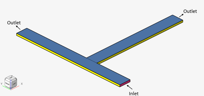

The problem to be addressed in this tutorial is shown schematically in Figure 1. An Air-Water mixture is entering a t-junction pipe through the inlet with a carrier (Water) volume fraction of 0.98. The diameter of the disperse field is 0.001 m. The velocity of the incoming carrier field (Water) is 1.5 m/s, while the velocity of the disperse field (Air) is set to 1.6 m/s. The simulation will be solved as a 2D-problem, therefore a slip condition is applied on the top and bottom surfaces.

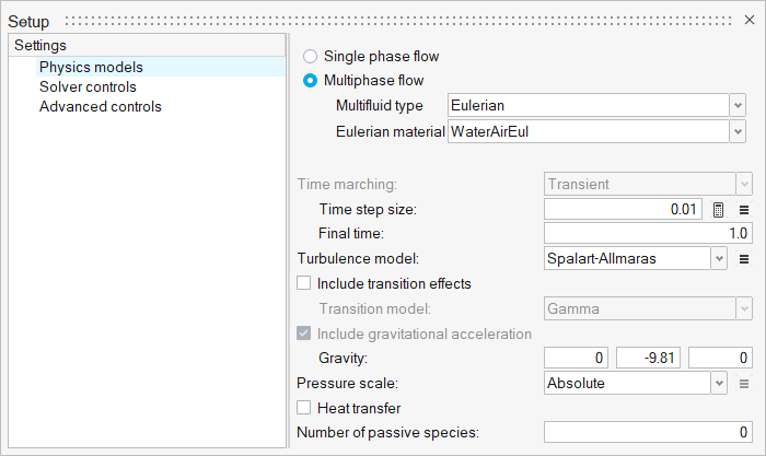

  2. Under the Physics models setting, select the Multiphase flow radio button.
  3. Change the Multifluid type to Eulerian.
  4. Click the Eulerian material drop-down menu and select Material Library from the list.
    You can create new material models in the Material Library.

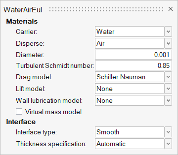

  5. In the Material Library dialog, select Eulerian Multiphase, switch to the My Material tab, and then click to add a new material.
  6. In the microdialog, click the top-left corner and change the name to WaterAirEul.
  7. Set the Carrier field to Water and the Disperse field to Air.
  8. Set the diameter, drag model, and other parameters as shown in the image below.
    Figure 5.
  9. Close the material model microdialog and then close the Material Library dialog.
  10. In the Setup dialog, set the Eulerian Material to WaterAirEul.
  11. Set Time step size and Final time to 0.01 and 1, respectively. Select Spalart-Allmaras for the Turbulence model.
  12. Set the gravity to 0, -9.81, 0 and the pressure scale to Absolute.

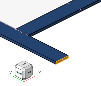

  2. Click the inlet face highlighted in the figure below.
    Figure 10.

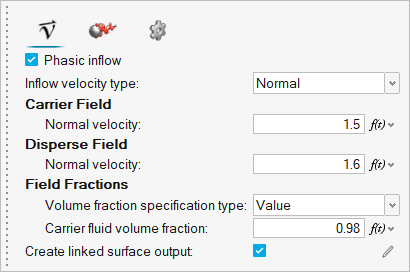

  3. In the microdialog, activate Phasic inflow and then change the inflow velocity type to Normal.
  4. Enter a value of 1.5 and 1.6 m/s for the Normal velocity of the Carrier Field and Disperse Field, respectively.
  5. Set the Volume fraction specification type to Value and set the Carrier fluid volume fraction to 0.98.
    Figure 11.

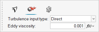

  6. Click the Turbulence tab in the microdialog. Set the Turbulence input type to Direct and the Eddy viscosity to 0.001.
    Figure 12.
    Note: When phasic inflow is active, Turbulence input type = Direct should be used.

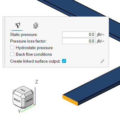

    Figure 13.
  9. Select the face highlighted below and verify the settings in the microdialog.
    Figure 14.
  10. On the guide bar, click to execute the command and remain in the tool.

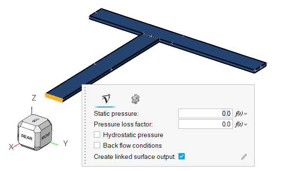

  11. With the Outlet tool still active, select the face highlighted below after rotating the model. Then click on the guide bar.
    Figure 15.

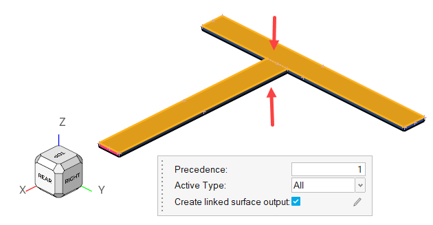

    Figure 16.
  13. Select the top and bottom faces highlighted below and then click on the guide bar.
    Figure 17.

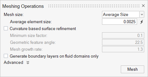

  2. In the Meshing Operations dialog, check that the Average Element size is set to 0.0025.
    Figure 19.
  3. Click Mesh.
    The Run Status dialog opens. Once the run is complete, the status is updated and you can close the dialog.

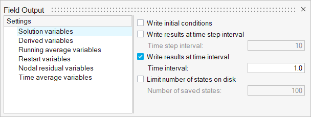

  2. Check the box for Write Initial Conditions.
  3. Set the time interval to 1.
    Figure 21.

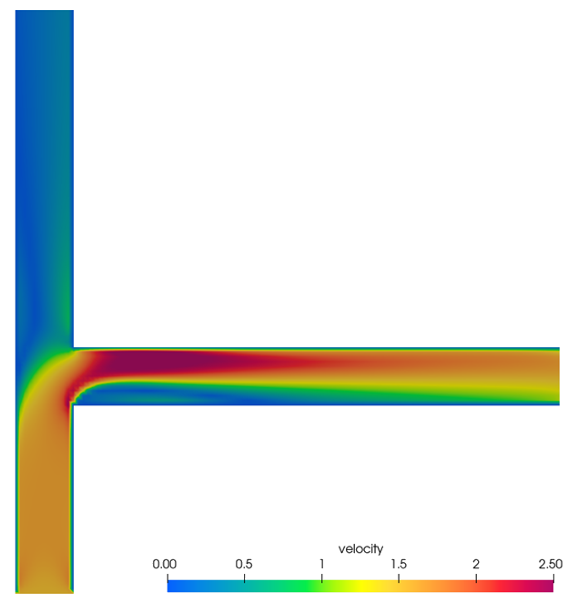

  4. In the modeling window, select the top slip surface.

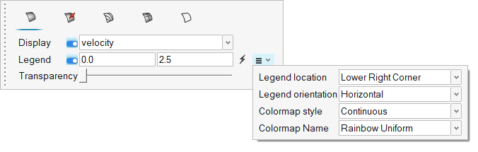

  5. In the microdialog, set the display variable to velocity.
  6. Activate the Legend toggle and set the legend limits to 0 and 2.5, respectively.
  7. Click and set the colormap properties as shown below.
    Figure 25.
  8. Click on the guide bar to create the velocity contour plot.
    Figure 26.

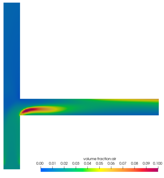

  10. In the microdialog, change the display variable to volume fraction: air and set the legend limits to 0 and 0.1.
  11. Click on the guide bar to create the volume fraction contour plot.
    Figure 27.
