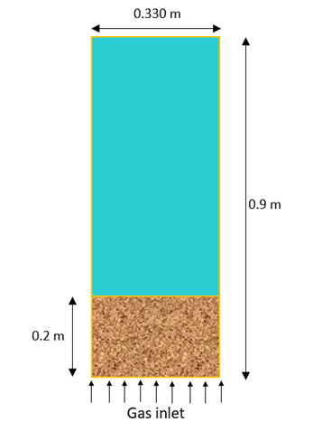

The problem to be addressed in this tutorial is shown schematically in . Some of the most common applications of the granular multiphase model are fluidized beds, mixing tanks, sedimentation of particles in liquid columns, and so on. In this tutorial, you will set up and run a gas-particle fluidized bed. The inlet velocity used for the simulation is 0.3 m/s and the initial bed height is 0.2 m. The initial solid packing fraction is set to 0.63.

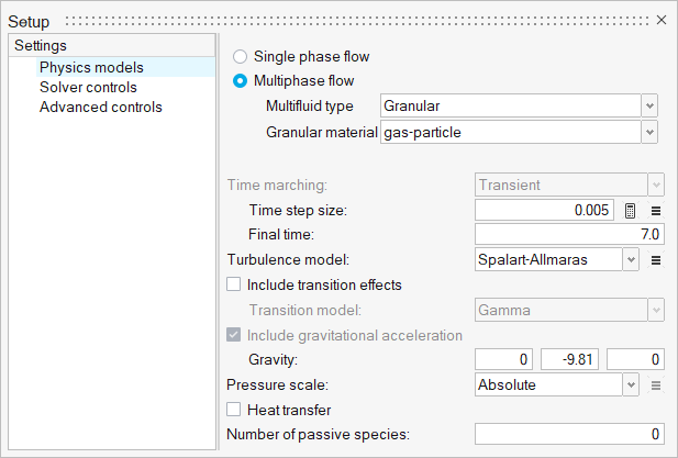

  2. Under the Physics models setting, select the Multiphase flow radio button.
  3. Change the Multifluid type to Granular.
  4. Click the Granular material drop-down menu and select Material Library from the list.
    You can create new material models in the Material Library.
  5. In the Material Library dialog, select Granular Multiphase, switch to the My Material tab, and then click to add a new material.
  6. In the microdialog, click on the top-left corner and change the name to gas-particle.
  7. Set the Carrier field to gas and the Disperse field to particle.
    Note: The input file provided with the tutorial has a predefined gas and particle material models in it.

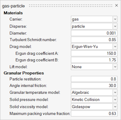

  8. Set the diameter, drag model, and other granular parameters as shown in the image below.
    Figure 5.
  9. Close the material model microdialog and then close the Material Library dialog.
  10. In the Setup dialog, set the Granular Material to gas-particle.
  11. Set Time step size and Final time to 0.005 and 7, respectively. Select Spalart-Allmaras for the Turbulence model.
  12. Set the gravity to 0, -9.81, 0 and the pressure scale to Absolute.

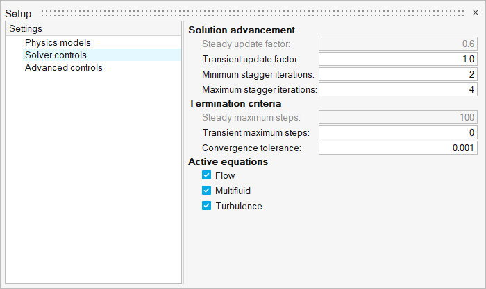

  13. Click the Solver controls setting and set the Minimum and Maximum stagger iterations to 2 and 4, respectively.
    Figure 7.

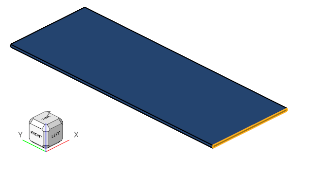

  1. From the Flow ribbon, click the Constant tool.
    Figure 9.

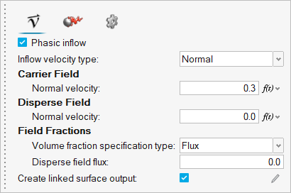

  2. Click the inlet face highlighted in the figure below.
    Figure 10.
  3. In the microdialog, enter the values shown in the figure below.
    Figure 11.

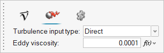

  4. In the turbulence tab, set the turbulence input type to Direct and set the eddy viscosity value to 0.0001.
    Figure 12.

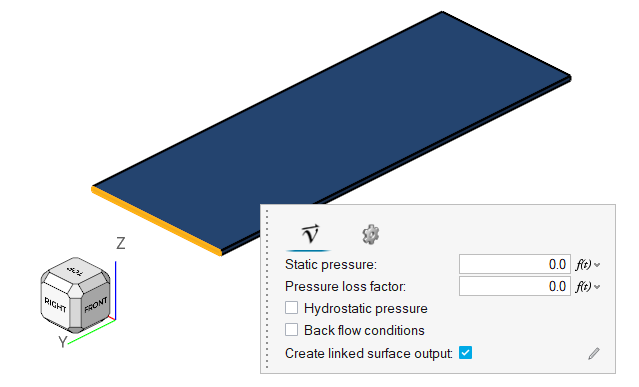

  6. Click the Outlet tool.
    Figure 13.
  7. Select the face highlighted below and verify the settings in the microdialog.
    Figure 14.
  8. Click on the guide bar.

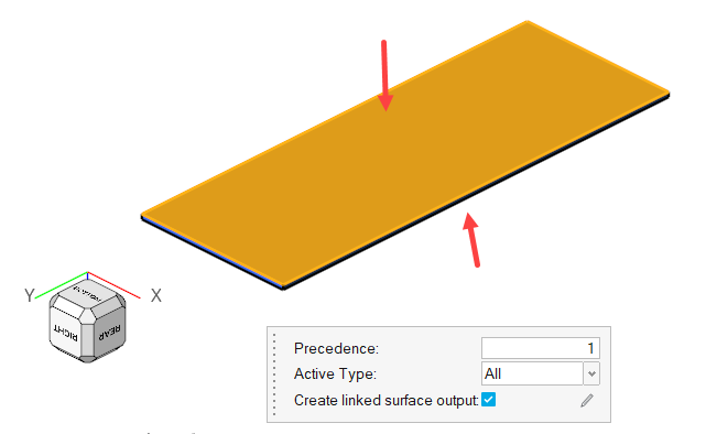

  9. Click the Slip tool.
    Figure 15.
  10. Select the top and bottom faces highlighted below and then click on the guide bar.
    Figure 16.

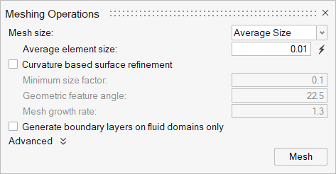

  1. From the Mesh ribbon, click the Volume tool.
    Figure 17.
    Note: If the model has not been validated, you are prompted to create the simulation model before running the batch mesh.
  2. In the Meshing Operations dialog, check that the Average Element size is set to 0.01.
    Figure 18.
  3. Click Mesh.

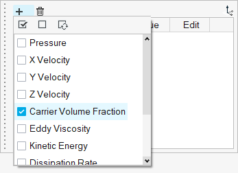

  5. In the variable dialog, click in the top-left corner and select Carrier Volume Fraction.
    Figure 22.
  6. Click on the white space in the dialog and set the value of the carrier volume fraction to 0.37.

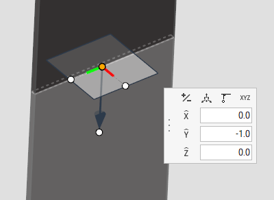

    The Vector tool appears, which can be used change the location and orientation of the plane defining the initial condition.

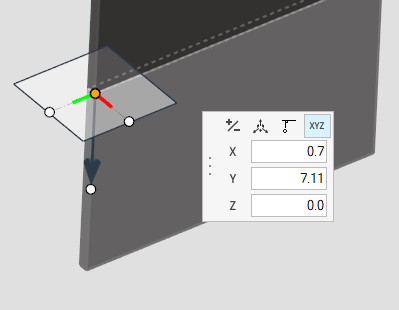

  8. In the Vector tool, verify that the orientation of the tool is along the negative y-axis and then click XYZ.
    Figure 23.
  9. Enter the coordinates of the center of plane as shown in the figure below.

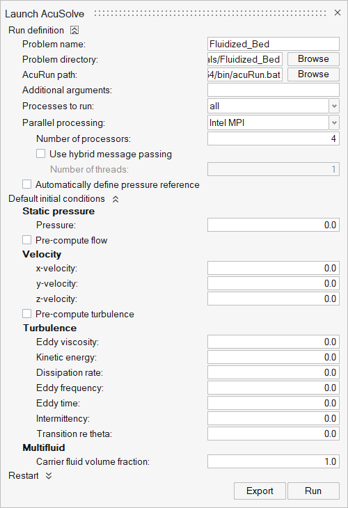

  1. From the Solution ribbon, click the Run tool.
    Figure 25.
    The Launch AcuSolve dialog opens.
  2. Set the Parallel processing option to Intel MPI.
  3. Optional: Set the number of processors to 4 or 8 based on availability.
  4. Expand Default initial conditions, uncheck Pre-compute flow, and set the velocity values to 0. Uncheck Pre-compute Turbulence.
    Figure 26.
  5. Click Run to launch AcuSolve.

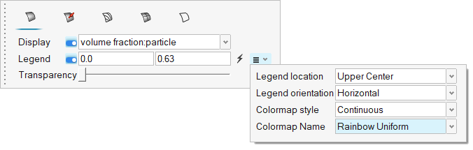

  5. In the microdialog, set the display variable to volume fraction:particle.
  6. Activate the Legend toggle and set the legend limits to 0 and 0.63, respectively (if not already set).
  7. Click and set the colormap properties as shown below.
    Figure 28.

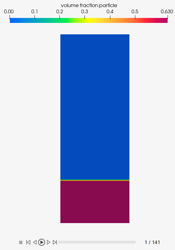

  8. Click on the guide bar to create the volume fraction contour plot.
  9. Click the play icon at the bottom of the modeling window to play the animation.
    Figure 29.
