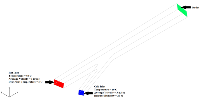

The problem to be addressed in this tutorial is shown schematically in Figure 1. As an example, a pipe junction problem is attached here to show the capability of the Humidity modelling in AcuSolve. In this problem, there are two inlets with different flow, thermal, and humidity conditions. As the flow proceeds downstream of the pipe, two pipes merge into a single pipe to create a single outlet and a distinct profile of temperature and humidity is attained. The geometry is symmetric about the XZ midplane of the pipe, as shown in the figure.

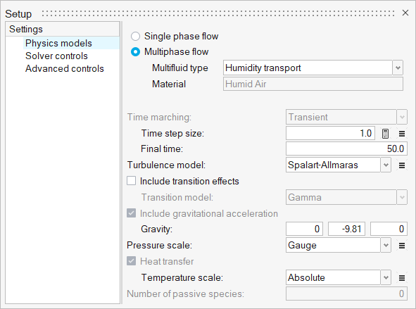

  2. Under the Physics models setting:
    1. Select the Multiphase flow radio button.
    2. Set the Multifluid type to Humidity transport.
    3. Set the Time step size to 1 s and the Final time to 50 s.
    4. Set the Turbulence model to Spalart-Allmaras.
    5. Set the Gravity to (0,-9.81,0).
    6. Set the Pressure scale to Gauge and click . In the microdialog, set the Absolute pressure offset to 101325 Pa and then press Esc.

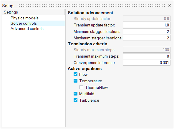

  3. Click the Solver controls setting.
  4. Set both the Minimum and Maximum stagger iterations to 2.
    Figure 6.
  5. Close the dialog and save the model.

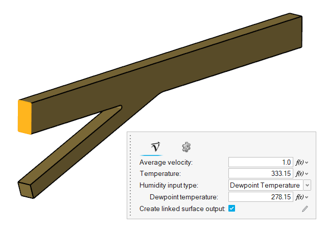

  1. From the Flow ribbon, Profiled tool group, click the Profiled Inlet tool.
    Figure 7.
  2. Select the surface highlighted in the figure below.
  3. In the microdialog:
    1. Set the Average velocity to 1 m/sec.
    2. Set the Temperature to 333.15 K.
    3. Set the Humidity input type to Dewpoint Temperature.
    4. Set the Dewpoint temperature to 278.15 K.
    Figure 8.
  4. In the Boundaries legend, double-click Inlet, change the name to Hot_inlet, and then press Enter.

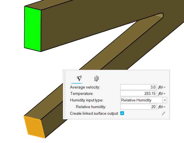

  6. Select the surface highlighted in the figure below.
  7. In the microdialog:
    1. Set the Average velocity to 3 m/sec.
    2. Set the Temperature to 283.15 K.
    3. Set the Humidity input type to Relative Humidity.
    4. Set the Relative humidity to 20.
    Figure 9.
  8. In the Boundaries legend, double-click Inlet, change the name to Cold_inlet, and then press Enter.

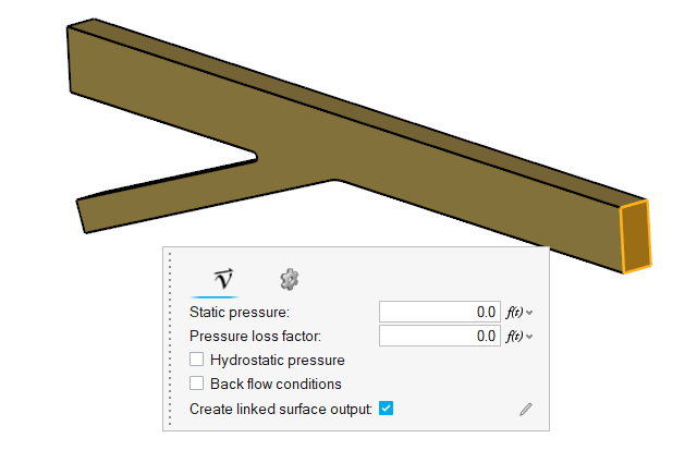

    Figure 10.
  11. Select the surface highlighted in the figure below and then click on the guide bar.

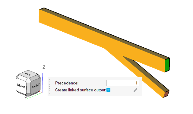

  12. Click the Slip tool.
    Figure 12.
  13. Select the surface highlighted in the figure below (the surface with the minimum y-coordinate).
    Figure 13.
  14. In the Boundaries legend, double-click Slip, change the name to y_neg, and then press Enter.
  15. Click on the guide bar.

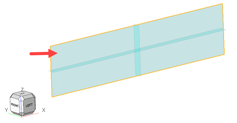

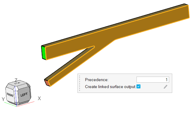

  16. Select the surface highlighted in the figure below (the surface with the maximum y-coordinate).
    Figure 14.
  17. In the Boundaries legend, double-click Slip, change the name to y_pos, and then press Enter.
  18. Click on the guide bar.

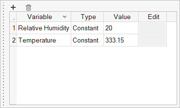

  3. In the dialog, click , select Relative Humidity and Temperature from the list of variables, and then click the white space in the dialog.
  4. Set the initial values of Relative Humidity and Temperature to 20 and 333.15 K, respectively.
    Figure 16.

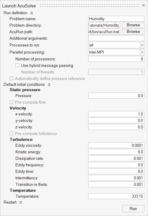

  1. From the Solution ribbon, click the Run tool.
    Figure 17.
  2. Set the Parallel processing option to Intel MPI.
  3. Optional: Set the number of processors to 4 or 8 based on availability.
  4. Expand Default initial conditions.
  5. Set the Temperature to 333.15 K and the remaining fields as shown in the figure below.
  6. Click Run to launch AcuSolve.
    Figure 18.

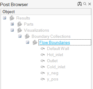

    The solid and all the surfaces are loaded in the Post Browser.
  4. In the Post Browser, click the icon beside Flow Boundaries to turn off the display of all the surfaces.
    Figure 19.

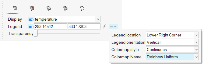

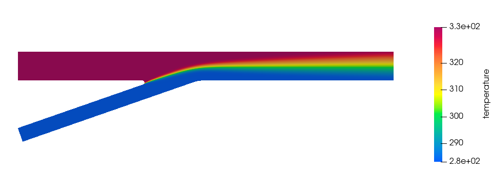

  8. In the display properties microdialog, set the display to temperature.
  9. Click then activate the Legend toggle.
  10. Click and set the Colormap Name to Rainbow Uniform.
    Figure 22.
  11. On the guide bar, click to create the temperature contour plot.

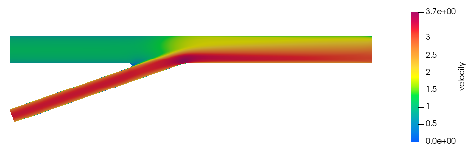

    Figure 23.

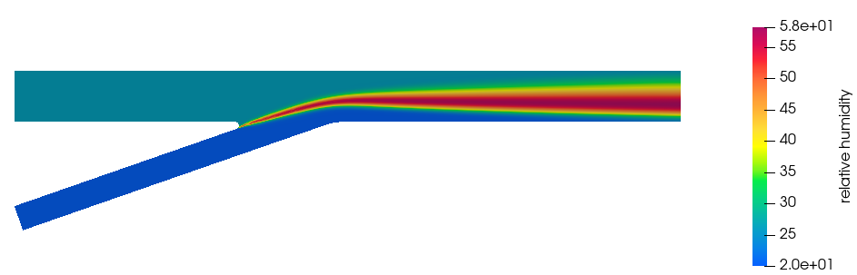

  12. Hide the temperature contour and repeat the steps 5-11 to create a similar contour plot for relative humidity.
    Figure 24.

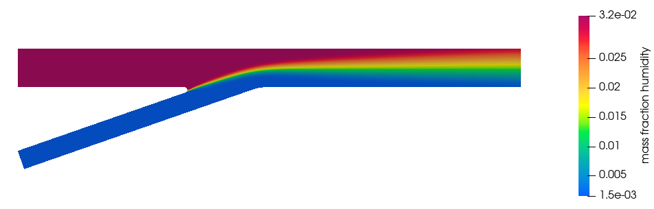

  13. Hide the relative humidity contour and repeat the steps 5-11 to create a similar contour plot for mass fraction humidity.
    Figure 25.
  14. Hide the mass fraction humidity contour and repeat the steps 5-11 to create a similar contour plot for velocity.
    Figure 26.
