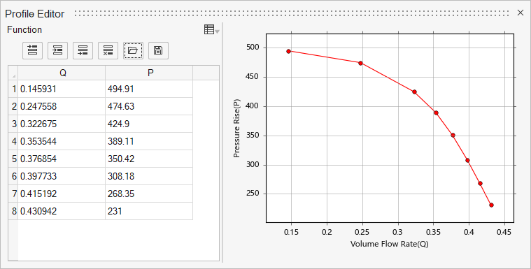

    Figure 13.
  8. Click beside P-Q Curve Type to open the Profile Editor.
  9. Click , browse to the location where you saved fanPQcurve.csv, and open it.
    Figure 14.
    Note: Units for volume flow (Q) and Pressure Rise (P) are, respectively, m3/sec and Pa.

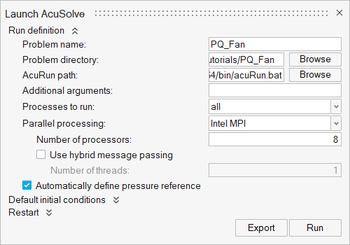

  10. From the Solution ribbon, click the Run tool.
    Figure 28.
    The Launch AcuSolve dialog opens.
  11. Set the Parallel processing option to Intel MPI.
  12. Optional: Set the number of processors to 4 or 8 based on availability.
  13. Leave the remaining options as default and click Run to launch AcuSolve.

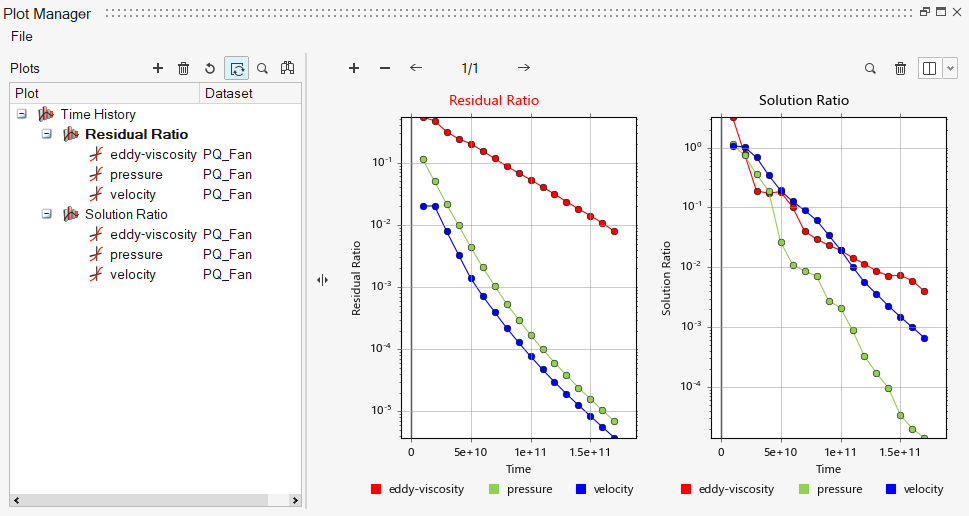

Post-Process with the Plot Tool
  1. From the Solution ribbon, click the Plot tool.
    Figure 30.
    Figure 31.

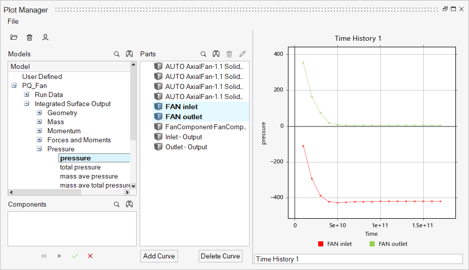

  2. Click to create a new plot.
  3. In the Data Tree, expand Integrated Surface Output > Pressure and then select pressure.
  4. Under Parts, select Fan_inlet and Fan_oultet to display pressure at the inlet and outlet.
    Figure 32.

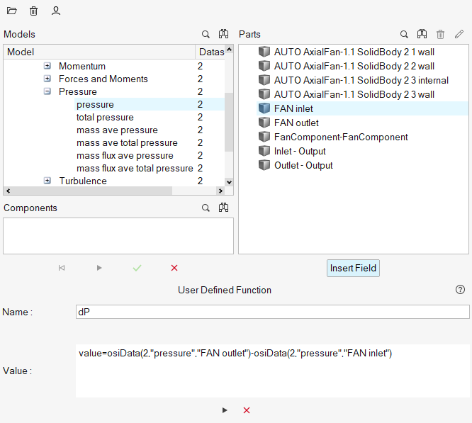

  5. Right-click User Defined under the Model panel to create a user-defined function.
  6. In the Data Tree, expand Integrated Surface Output > Pressure and then select pressure.
  7. In the Name field, enter dP.
  8. In the Value field, type value=.
  9. Under Parts, choose FAN outlet and then click Insert Field to insert the field as part of the value, as shown below.
    Figure 33.
  10. Type - at the end of the user-defined function value.
  11. Under Parts, choose FAN inlet and then click Insert Field to insert the field as part of the value.
  12. Click to add the user defined function.
    Figure 34.

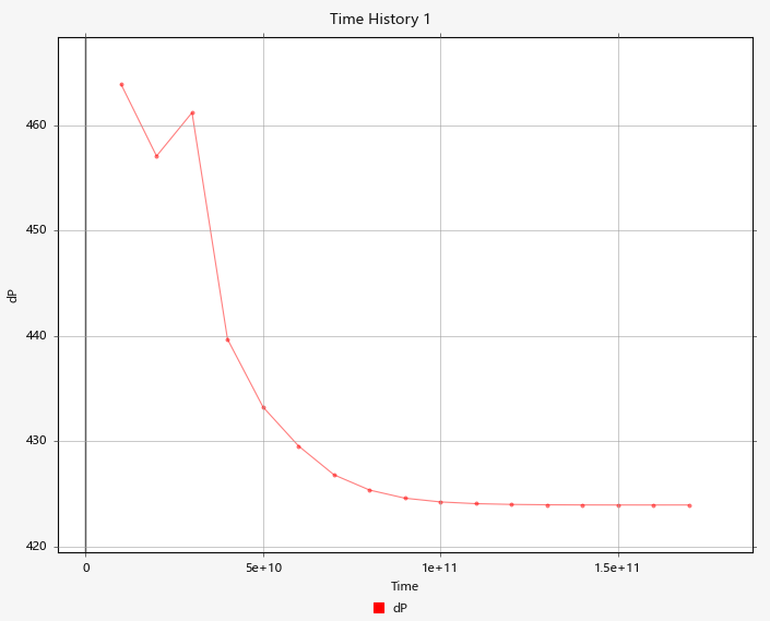

  13. Click the x axis to switch to Time Steps.
    Figure 35.
    From the above figure, the pressure got stabilized at around the 6th iteration and remains constant with pressure difference between the FAN_inlet and FAN_outlet of 423.97 Pa for a given volume flow rate 0.322675 m3/sec, which is very near compared to the reference pressure increase of 424.9 Pa.
