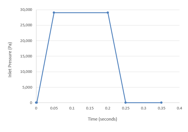

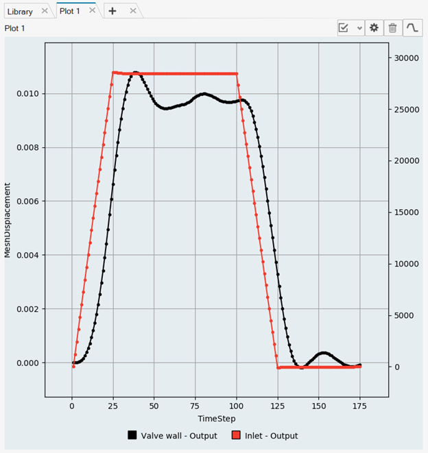

The initial inlet pressure is 0 Pa. At 0.002 s the pressure begins to ramp up and reaches 29,000 Pa at 0.05 s. The pressure is held at 29,000 Pa and begins to ramp back down starting at 0.2 s, reaching the initial pressure at 0.25 s where it remains for the rest of the simulation.
Figure 2. Transient pressure at the inlet
Prior simulations of this geometry indicate that the average velocity at the inlet reaches a maximum of 0.98 m/s. At this velocity, the Reynolds number for the flow is 78,400. When the Reynolds number is above 4,000 it is generally accepted that flow should be modeled as turbulent.
Note that the initial conditions of the flow are actually laminar; however, the increase in flow velocity and flow around the valve shutter is expected to cause a rapid transition to turbulent conditions. Therefore, the simulation will be set up to model transient, turbulent flow. When performing a transient analysis, convergence is achieved at every time step based on the defined stagger criteria. Mesh motion will be modeled using arbitrary mesh movement (arbitrary Lagrangian-Eulerian mesh motion).
For this case, the transient behavior of interest occurs in the time it takes for the pressure to ramp up and ramp back down, which is given by the transient pressure profile. To allow time for the spring to recover additional time will be simulated. For this tutorial 0.1 s is added after the pressure drops back to initial conditions for a total duration of 0.35 s.

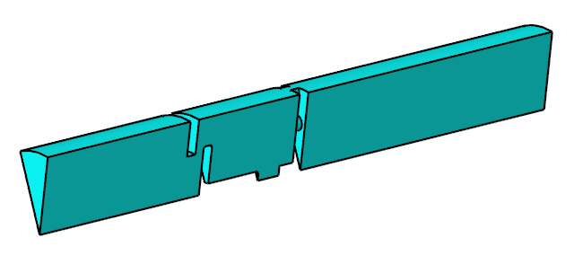

Validate the Geometry
  1. From the Geometry ribbon, click the Validate tool.
    Figure 6.
    The current model does not have any of the issues mentioned above. Alternatively, if any issues are found, they are indicated by the number in the brackets adjacent to the tool name.
    Observe that a blue check mark appears on the top-left corner of the Validate icon. This indicates that the tool found no issues with the geometry model.
    Figure 7.
  2. Press Esc or right-click in the modeling window and swipe the cursor over the green check mark from right to left.
  3. Save the database.

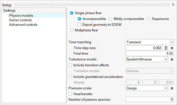

  2. Under the Physics models setting:
    1. Set Time marching to Transient.
    2. Set the Time step size to 0.002 and the Final time to 0.35.
    3. Select Spalart-Allmaras as the Turbulence model.
    Figure 9.

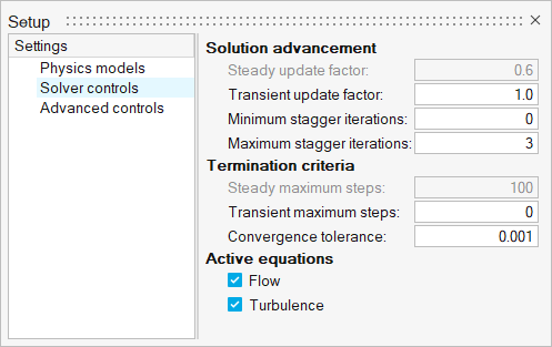

  3. Click the Solver controls setting and set the Maximum stagger iterations to 3.
    Figure 10.

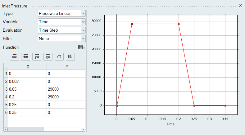

Create a Multiplier Function for the Inlet Pressure
  1. From the Flow ribbon, click the arrow next to the Setup tool set, and then select Multipliers.
    Figure 11.
  2. Click in the Multiplier Library dialog.
  3. In the multiplier creation dialog, change the name of the multiplier function to Inlet Pressure by clicking the top-left corner.
  4. Set the Type to Piecewise Linear.
  5. Verify that the Variable is set to Time and Evaluation is set to Time Step.
  6. Click four times to add four rows to the bottom of the table.
  7. Enter the table values according to the image below.
    Figure 12.

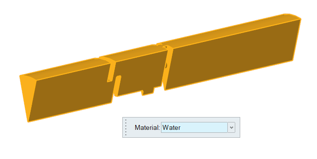

Assign Material Properties
  1. From the Flow ribbon, click the Material tool.
    Figure 13.
  2. Click anywhere on the pipe geometry.
    The entire geometry is highlighted.
    Figure 14.
  3. In the microdialog, select Water from the Material drop-down menu.
  4. On the guide bar, click to execute the command and exit the tool.
  5. Save the model.

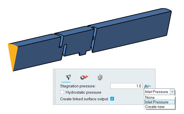

  2. In the modeling window, click the inlet surface, as shown in Figure 16.
  3. In the microdialog, enter a value of 1 N/m2 for the Stagnation pressure.
  4. Click the Multiplier function drop-down and select the function Inlet Pressure from the list.
    Figure 16.

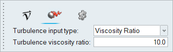

  5. Click the Turbulence icon on the microdialog, set the Turbulence input type to Viscosity Ratio, and then enter a value of 10 for the Turbulence viscosity ratio.
    Figure 17.
  6. On the guide bar, click to execute the command and remain in the tool.

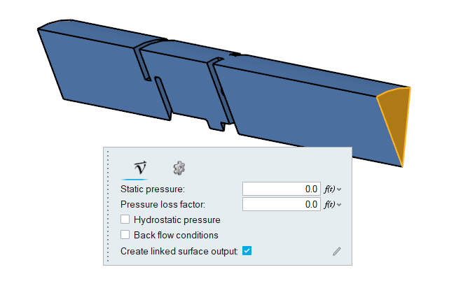

  9. Click the outlet surface shown in the figure below.
    Figure 19.
  10. On the guide bar, click to execute the command and exit the tool.

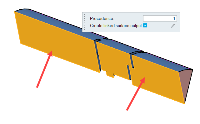

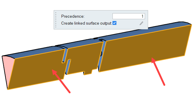

  11. Click the Symmetry tool.
    Figure 20.
  12. Select the two surfaces shown in the figure below.
    Figure 21.
  13. On the guide bar, click to execute the command and remain in the tool.
  14. In the Boundaries legend, rename Symmetry to Front_symmetry.
  15. Rotate the model and select the other two symmetry faces.
    Figure 22.
  16. On the guide bar, click to execute the command and remain in the tool.
  17. In the Boundaries legend, rename Symmetry to Back_symmetry.
  18. Save the model.

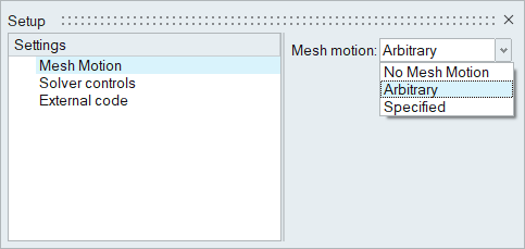

  1. From the Motion ribbon, click the Settings tool.
    Figure 23.
  2. In the Setup dialog, change the Mesh motion to Arbitrary.
    Figure 24.

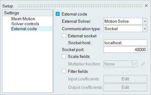

  3. Click the External code setting and activate the External code option.
  4. Set the External Solver to MotionSolve and the Communication type to Socket.
  5. Deactivate the External socket option and set the Socket host to localhost.
  6. Set the Socket port to 48000.
    Figure 25.
  7. Close the dialog.

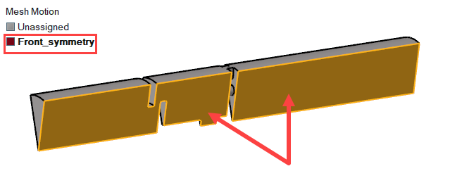

Define the Mesh Displacement Boundary Conditions
  1. From the Motion ribbon, click the Planar Slip tool.
    Figure 26.
  2. Select the two front symmetry surfaces shown Figure 27.
  3. In the Mesh Motion legend, rename Planar Slip to Front_symmetry by double-clicking the name.
    Figure 27.
  4. On the guide bar, click to execute the command and remain in the tool.
  5. Rotate the model and select the two back symmetry faces.
  6. In the Mesh Motion legend, rename Planar Slip to Back_symmetry.
  7. On the guide bar, click to execute the command and exit the tool.

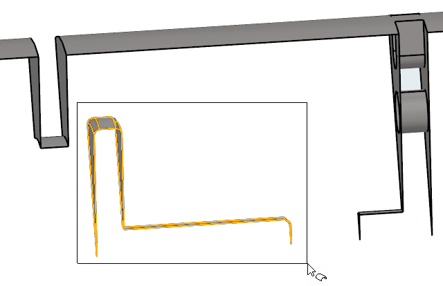

  12. Zoom in on the valve region and select all the valve wall surfaces using the window selection method.
    Figure 29.
  13. In the microdialog, set the Coupling direction to Both and enter Model-Shutter Body as the name of the Rigid body.

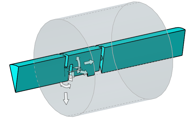

  1. From the Mesh ribbon, Zones tool group, click the Cylinder tool.
    Figure 32.

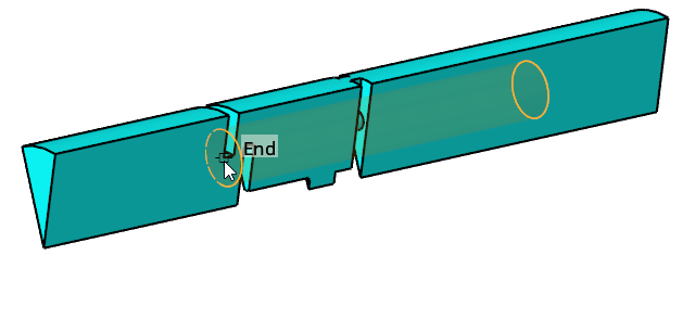

  2. In the modeling window, hover the mouse around the point shown in the figure below. When the preview cylinder zone is parallel to the axis of the pipe, click the model near the point shown below.
    This point will be the center of the front face of the cylinder. In the next few steps you will edit the coordinates of this point manually.
    Figure 33.
  3. Move the mouse cursor away from the center and then click again.
    A preview of the zone should be displayed on the screen along with the manipulator. The manipulator allows you to modify the location and orientation of the zone.
    Figure 34.

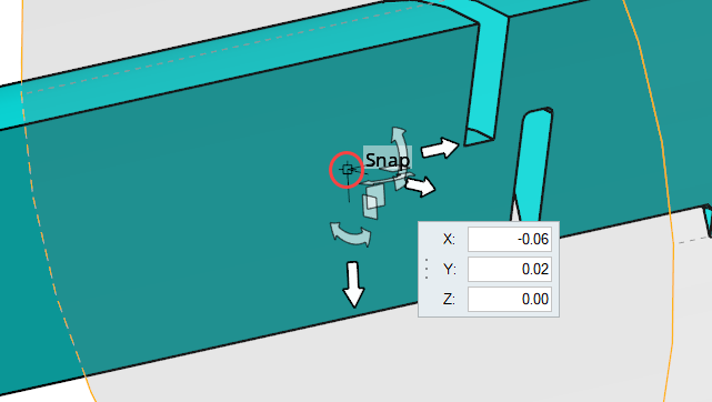

  4. Click the center of the manipulator and enter the following coordinates for the center (-0.06, 0.02, 0).
    Figure 35.

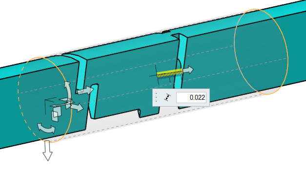

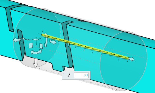

  5. Double-click the cylindrical surface of the zone and enter 0.022 m as the radius of the cylinder.
    Figure 36.
  6. Double-click the base of the cylinder and enter 0.1 m as the height of the cylinder.
    Figure 37.

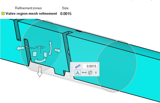

  7. Click anywhere in the empty space in the modeling window.
  8. Enter a value of 0.0015 m for the mesh size in the microdialog.
  9. In the Refinement zones legend, rename the zone to Valve region mesh refinement.
    Figure 38.

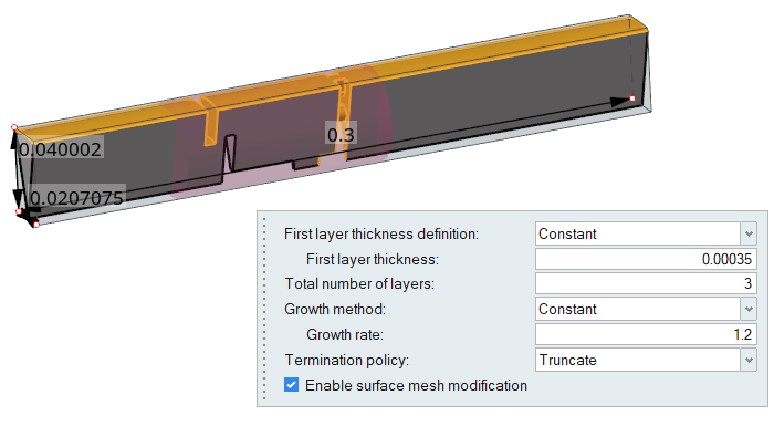

  2. Right-click in the modeling window and go to Select > Advanced Select > By Boundaries > Default Wall.
    All the wall surfaces should be highlighted and a dialog for BL specification appears.
  3. Enter the following values in the dialog:
    1. First layer thickness: 0.00035
    2. Total number of layers: 3
    3. Growth method: Constant
    4. Initial growth rate: 1.2
    5. Termination policy: Truncate
    6. Activate Enable surface mesh modification.
    Figure 40.
  4. In the BL Controls legend, rename the BL control to Pipe walls BL.

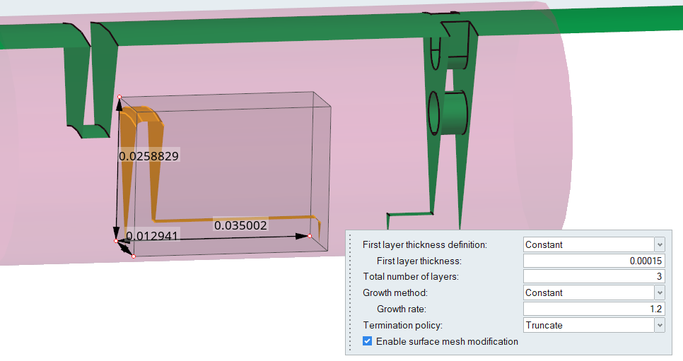

  6. In the next few steps, you will define the boundary layer mesh control for the valve walls. For convenience, hide the front and back symmetry faces.
  7. Select the valve wall surfaces using the box selection method.
  8. In the dialog that appears, enter the following values for the BL specification:
    1. First layer thickness: 0.00015

  9. In the BL Controls legend, rename the BL control to Valve walls BL.
  11. Click the drop-down next to the Mesh Controls tool set and select Advanced.
    Figure 42.

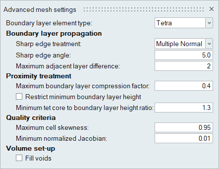

  12. In the Advanced mesh settings dialog, change the Boundary layer element type to Tetra and then close the dialog.
    Figure 43.
  13. Turn on the display of all the surfaces and save the model.

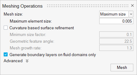

  1. From the Mesh ribbon, click the Volume tool.
    Figure 44.
  2. In the Meshing Operations dialog, set the Mesh size option to Maximum size and set the Maximum element size to 0.005.
  3. Deactivate Curvature based surface refinement.
  4. Click Mesh to generate the mesh.
    Figure 45.

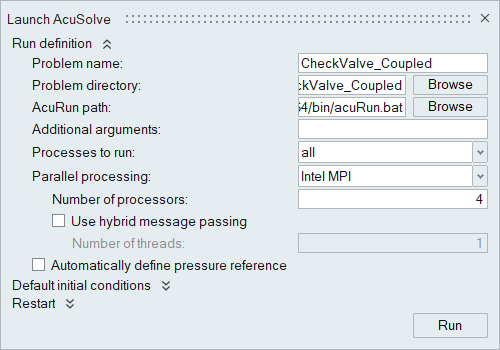

  1. From the Solution ribbon, click the Run tool.
    Figure 48.
  2. Set the Parallel processing option to Intel MPI.
  3. Optional: Set the number of processors to 4 or 8 based on availability.
  4. Deactivate the Automatically define pressure reference option.
  5. Leave the remaining options as default and click Run to launch AcuSolve.
    Figure 49.

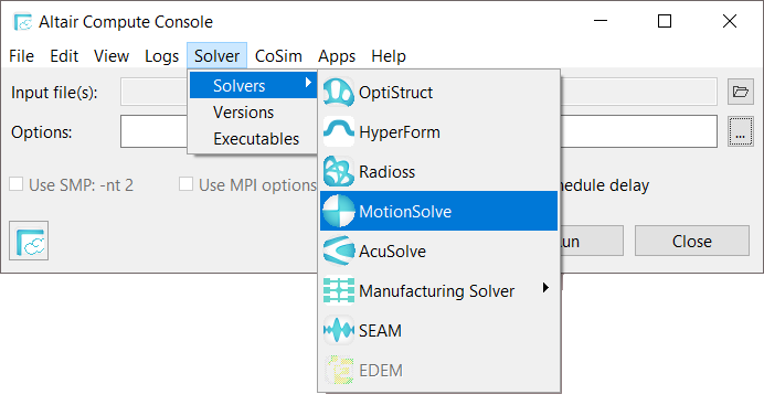

Run MotionSolve
  1. Run Start > All Programs > Altair <version> > Compute Console.
  2. From the menu bar select Solver > MotionSolve.
    Figure 50.

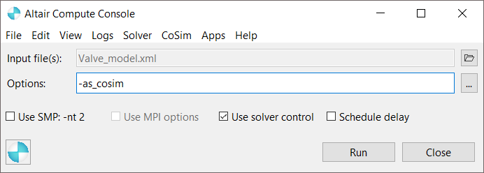

  3. Click besides the Input file(s) field, browse to the location where you saved Valve_model.xml, and open it.
  4. For Options, type -as_cosim to indicate coupling between MotionSolve and AcuSolve.
    Figure 51.
  5. Click Run to start MotionSolve.
Monitor the Results

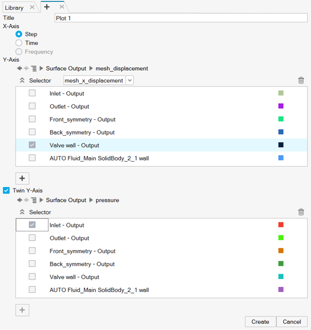

  1. From the Solution ribbon, click the Plot tool.
    Figure 52.
  2. Click next to the Library tab.
  3. Keep the X-axis set to Step. For the Y-axis, click the tree browser and select mesh_displacement under Surface Output.
    mesh_x_displacement is selected by default for the coordinate direction.
  4. Check the box for Valve wall - Output under Selector.
  5. Check the box for Twin Y-Axis.
  6. Click the tree browser for the second Y-axis and select pressure under Surface Output.
  7. Check the box for Inlet - Output under Selector.
    Figure 53.
  8. Click Create.
    Figure 54.
    Note: The valve motion lags behind the pressure changes at the inlet. Note also the spike around the 37th time step. This represents the collision of the valve stem with the stop and the subsequent rebound of the valve.

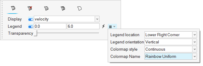

    Figure 55.

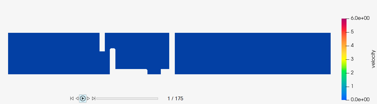

  5. In the Post Browser, right-click Front_symmetry and select Isolate.
  6. Right-click Front_symmetry once more and select Edit.

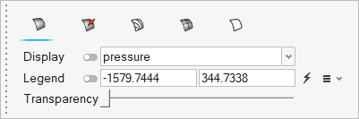

  7. In the display properties microdialog, set the display to velocity.
  8. Activate the Legend toggle and set the max velocity to 6.0.
  9. Click and set the Colormap Name to Rainbow Uniform.
    Figure 56.
  10. Click on the guide bar.
  11. Click at the bottom of the modeling window to view a live animation of the flow.
    Figure 57.

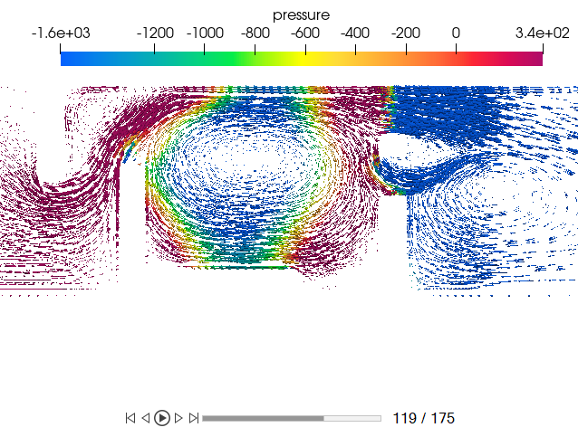

    Figure 60.
  7. Click the Vector Display tab.

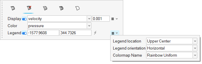

  8. Turn the Display on, set the variable to velocity, and the value to 0.001.
  9. Set the Coloring to pressure.
  10. Activate the Legend toggle and click to reset the range.
  11. Click , set the Legend location to Upper Center, the Legend orientation to Horizontal, and the Colormap Name to Rainbow Uniform.
    Figure 61.
  12. Click on the guide bar.
  13. In the Post Browser, right-click Slice Plane 1 and select Isolate.
    Figure 62.
