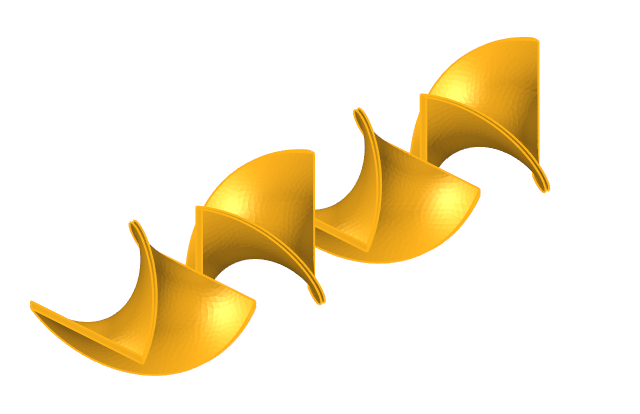

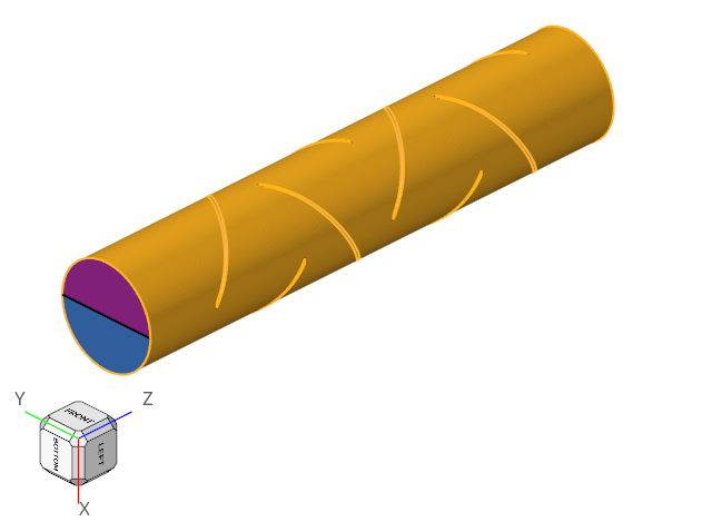

Validate the Geometry
To focus on the physics part of the simulation, this tutorial input file contains geometry which has already been validated. Observe that a blue check mark appears on the top-left corner of the Validate icon on the Geometry ribbon. This indicates that the geometry is valid, and you can go to the flow set up.
Figure 3.

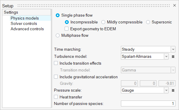

  2. Under the Physics models setting:
    1. Verify that the Time marching is set to Steady.
    2. Select Spalart-Allmaras as the Turbulence model.
    3. Set the Number of passive species to 1.
    Figure 5.

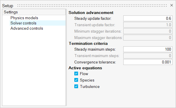

  3. Click the Solver controls setting and verify that the parameters are set as shown in the figure below.
    Figure 6.

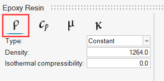

  5. In the Density tab:
    1. Set the Type to Constant.
    2. Set the Density value to 1264 kg/m3.
    3. Set the Isothermal compressibility value to 0.
    Figure 8.

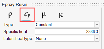

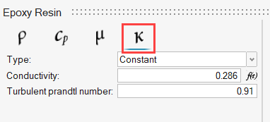

  6. Click the Specific Heat tab and set the Specific heat value to 2386 J/kg-K.
    Figure 9.
  7. Click the Viscosity tab and set the Viscosity value to 1.49 kg/m-s.
    Figure 10.
  8. Click the Conductivity tab and set the Conductivity value to 0.286 W/m-K and Turbulent Prandtl number to 0.91.
    Figure 11.

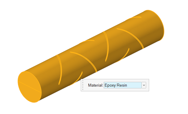

  1. From the Flow ribbon, click the Material tool.
    Figure 12.
  2. Select the solid model and then select Epoxy_Resin as the fluid medium.
    Figure 13.
  3. On the guide bar, click to execute the command and exit the tool.

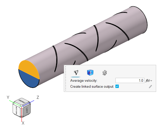

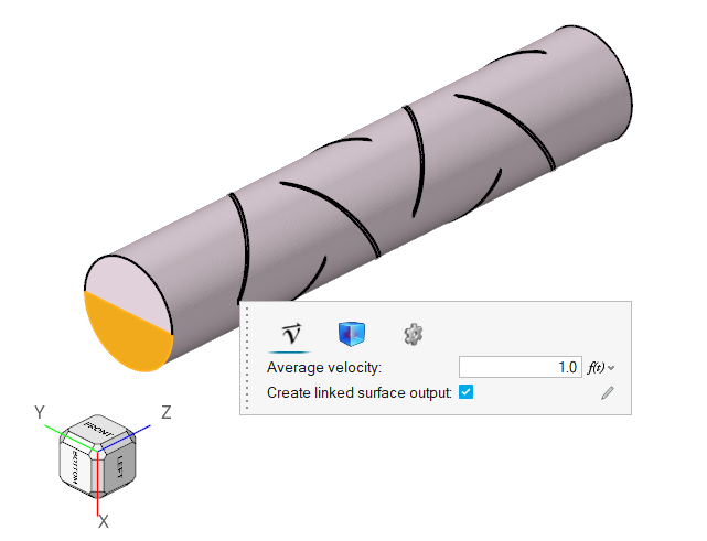

  1. From the Flow ribbon, Profiled tool group, click the Profiled Inlet tool.
    Figure 14.
  2. In the modeling window, click the inlet surface highlighted in the figure below.
    Figure 15.
  3. In the microdialog, set the Average velocity to 1.0 m/s.
  4. Click the Species tab and enter a value of 1.0 for Species 1.
    Figure 16.
  5. On the guide bar, click to execute the command and remain in the tool.

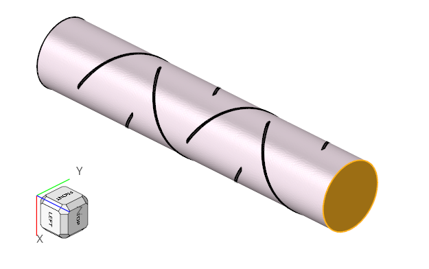

  15. Select the wall of the tube highlighted in the figure below and then click on the guide bar.
    Figure 21.
  16. Rename the surface group from Wall to Pipe Wall.

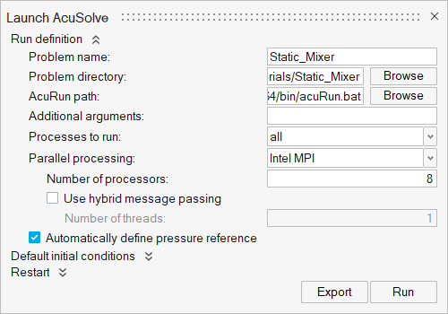

  4. From the Solution ribbon, click the Run tool.
    Figure 25.
    The Launch AcuSolve dialog opens.
  5. Make sure the problem directory is set to the correct location. If not, use the Browse option to select the correct directory.
  6. Set the Parallel processing option to Intel MPI.
  7. Optional: Set the number of processors to 4 or 8 based on availability.
  8. Leave the remaining default options and then click Run to launch AcuSolve.

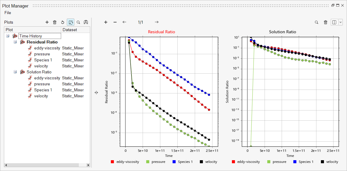

Post-Process With the Plot Tool
  1. From the Solution ribbon, click the Plot tool.
    Figure 27.
  2. Observe the residual and solution ratios as the simulation progresses.
    Figure 28.

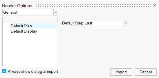

  3. Open the AcuSolve .log file in your problem directory to load the results for post-processing.
  4. Verify that the default step is set to Last in the Reader Options dialog and then click Import.
    Figure 30.

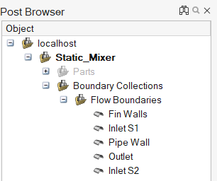

    The solid and all the surfaces are loaded in the Post Browser.
    Figure 31.

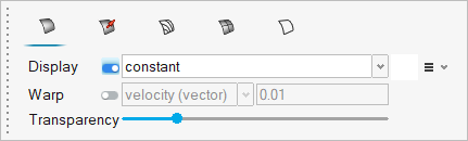

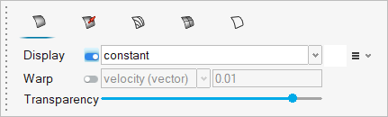

  5. In the Post Browser, right-click Pipe Wall and select Edit. Set the transparency to around 80%.
    Figure 32.
  6. Similarly, edit the transparency of Fin Walls to around 30% .

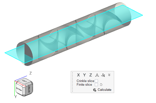

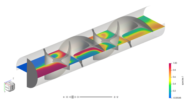

    Figure 34.
  9. Select the x-z plane in the modeling window and then click Calculate.
    Figure 35.

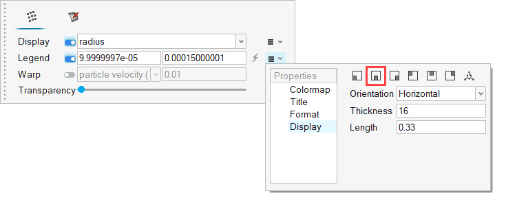

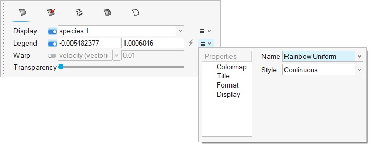

  10. In the display properties microdialog, set the display to species 1 and activate the Legend toggle.
  11. Click to reset the legend.
  12. Click and set the Colormap name to Rainbow Uniform.
    Figure 36.
  13. Click on the guide bar.
    The plot below shows the mixing effectiveness as the maximum value of species 1 is reduced to 0.7 at the outlet, while the minimum value of species 1 is increased to 0.3.
    Figure 37.

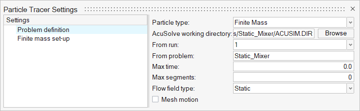

  3. Click Problem definition and set the Particle type to Finite Mass.
  4. For the AcuSolve working directory, select the ACUSIM.DIR (flow results) folder in your problem directory.
  5. Make sure the Flow field type set to Static.
  6. Disable Mesh motion if it not disabled already.
    Figure 39.

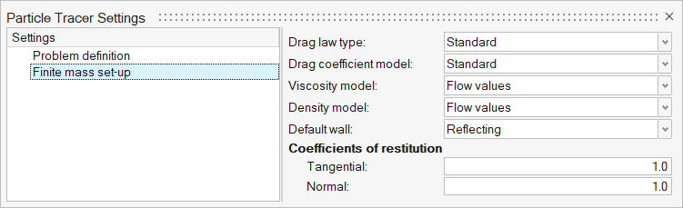

  7. Click Finite mass set-up and leave all the parameters as shown below.
    Figure 40.

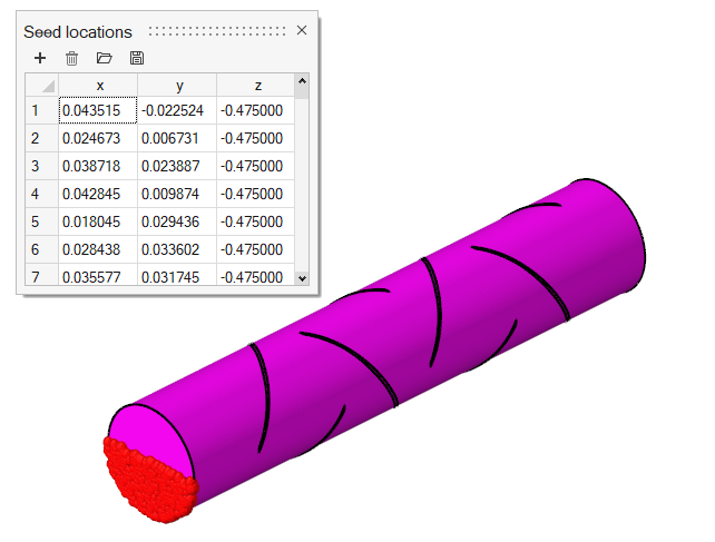

In the next steps, you will define the particle seeds that are moving into the flow regime.
  1. Click the Seeds tool.
    Figure 41.

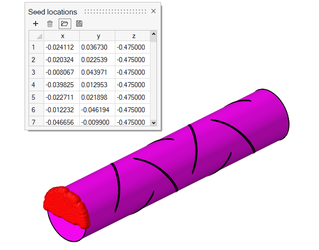

  2. In the Seed location window, click .
  3. Browse to the location where you saved seeds1.csv and seeds2.csv.
  4. Select seeds1.csv file and click Open.
    This accounts for the particles being fed from Inlet S1.
    Figure 42.

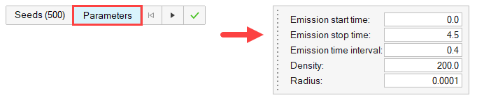

  5. Click Parameters on the guide bar and enter the following details.
    Figure 43.
  6. Click on the guide bar to execute the changes.
  7. Right-click Particle Seeds in the legend and select Rename. Change the name to Inlet S1 Seeds.

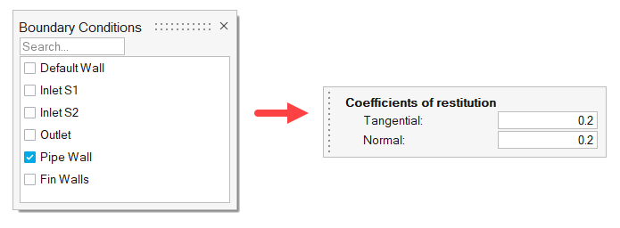

  1. Click the Reflecting tool.
    Figure 46.
  2. In the Boundary Conditions window, select the Pipe Wall and then set the Coefficients of restitution values to 0.2.
    Figure 47.
  3. Click on the guide bar to execute the changes.
  4. Right-click Reflecting Wall in the legend and select Rename. Change the name to Pipe Wall.

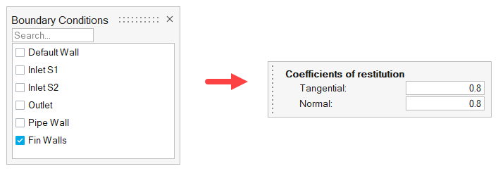

  5. In the Boundary Conditions window, select the Fin Walls and then set the Coefficients of restitution values to 0.8.
    Figure 48.

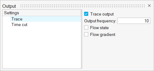

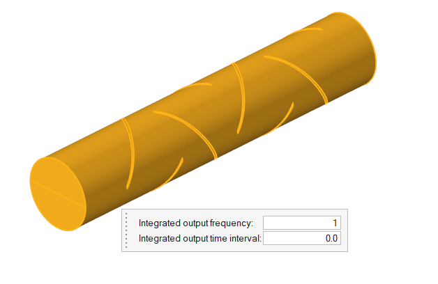

  1. Click the Output tool.
    Figure 50.
  2. Check Trace output and enter the values shown below.
    Figure 51.

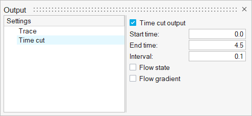

  3. Click the Time cut setting and enter the values shown below.
    Figure 52.

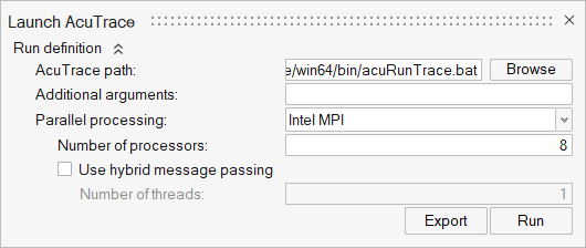

  1. Click the Run tool.
    Figure 53.
  2. Check that acuRunTrace.bat is pointing to the correct path: <installation_directory>\hwcfdsolvers\acusolve\win64\bin\acuRunTrace.bat.
  3. Set the Parallel processing option to Intel MPI.
  4. Optional: Set the number of processors to 4 or 8 based on availability.
  5. Leave the remaining options as default and click Run to launch AcuTrace.

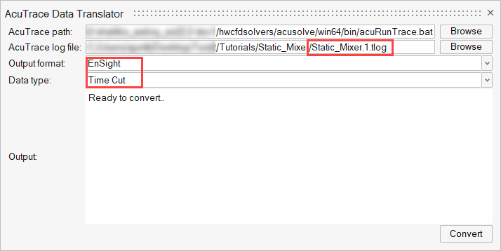

Convert Results for Ensight
Once the run is complete, you need to convert the results so that they can be read in HyperMesh CFD Post. To do this, run the AcuTransTrace utility. This tool can be used to convert data for Ensight.

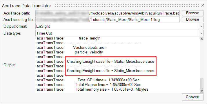

  1. Click the Convert tool.
    Figure 55.
    The AcuTrace Data Translator window opens.
  2. Browse to the location where the AcuTrace .log file (*.tlog) is located.
  3. Set the Output format to Ensight.
  4. Set Data type to Time Cut.
    Figure 56.
  5. Click Convert.
    Once the conversion is successful, it generates two Ensight result files.
    Figure 57.

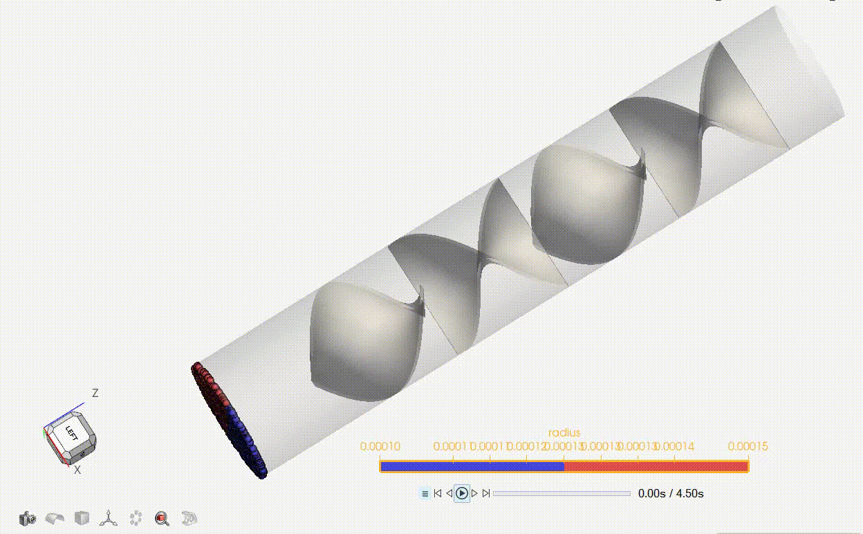

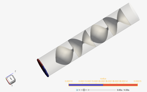

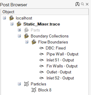

  3. Open the Ensight case file (static_mixer.trace.case) in your problem directory to load the results for post-processing.
    Note: A warning opens wherein if some results were previously loaded it will try to remove the results first then load the current results. Click Continue.
    The solid and all the surfaces along with the Particles are loaded in the Post Browser.

  4. In the Post Browser, turn off the display for all surfaces except for Pipe Wall and Fin Walls.
  5. Set the transparency for Fin Walls to around 30% and the transparency for Pipe Wall to around 80%.

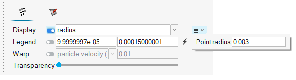

  6. Right-click Block8 under Particles and select Edit.
  7. Set the display to Radius. Click and set the point radius to 0.003.
    Figure 60.

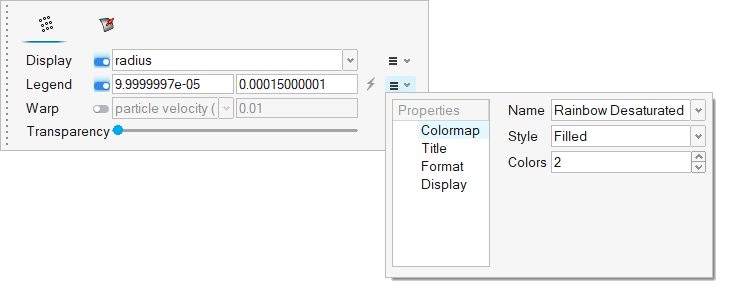

  8. Activate the Legend toggle and click to refresh the range.
  9. Click and set the colormap name to Rainbow Desaturated, the colormap style to Filled, and the number of colors to 2.
    Figure 61.
  10. Switch to the Display properties. Set the Orientation to Horizontal and select the Lower Center button.
    Figure 62.

  12. Rotate the model as shown in below figure such that you can view the particles movement inside the domain more precisely.
    Figure 64.
  13. Click at the bottom of the modeling window to view a live animation of the flow.
    Figure 65.
