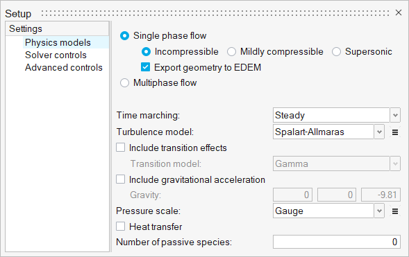

  2. Under the Physics models setting:
    1. Verify that the Incompressible option is selected under Single phase flow.
    2. Activate the Export geometry to EDEM check-box.
    3. Set Time marching to Steady.
    4. Select Spalart-Allmaras as the Turbulence model.
    Figure 6.

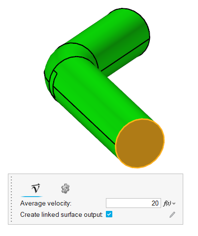

  1. From the Flow ribbon, Profiled tool group, click the Profiled Inlet tool.
    Figure 8.
  2. Click on the inlet face highlighted in the figure below and enter a value of 20 m/s for the Average velocity in the microdialog.
    Figure 9.
  3. On the guide bar, click to execute the command and exit the tool.

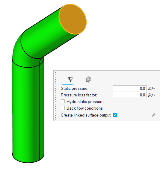

  4. Click the Outlet tool.
    Figure 10.
  5. Select the face highlighted in the figure below and then click on the guide bar.
    Figure 11.

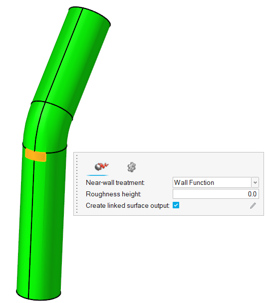

  6. Click the No Slip tool.
    Figure 12.
  7. Select the face highlighted in the figure below.
    Figure 13.
  8. In the Boundaries legend, double-click Wall and rename it to Particle_inlet.
    You will use this surface as a reference geometry to create a particle factory in EDEM. Hence, you are placing this surface in a different geometry group.

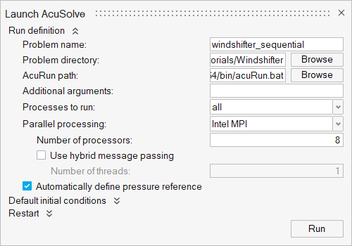

    The Launch AcuSolve dialog opens.
  2. Set the Parallel processing option to Intel MPI.
  3. Optional: Set the number of processors to 4 or 8 based on availability.
  4. Click Run to launch AcuSolve.
    Figure 17.

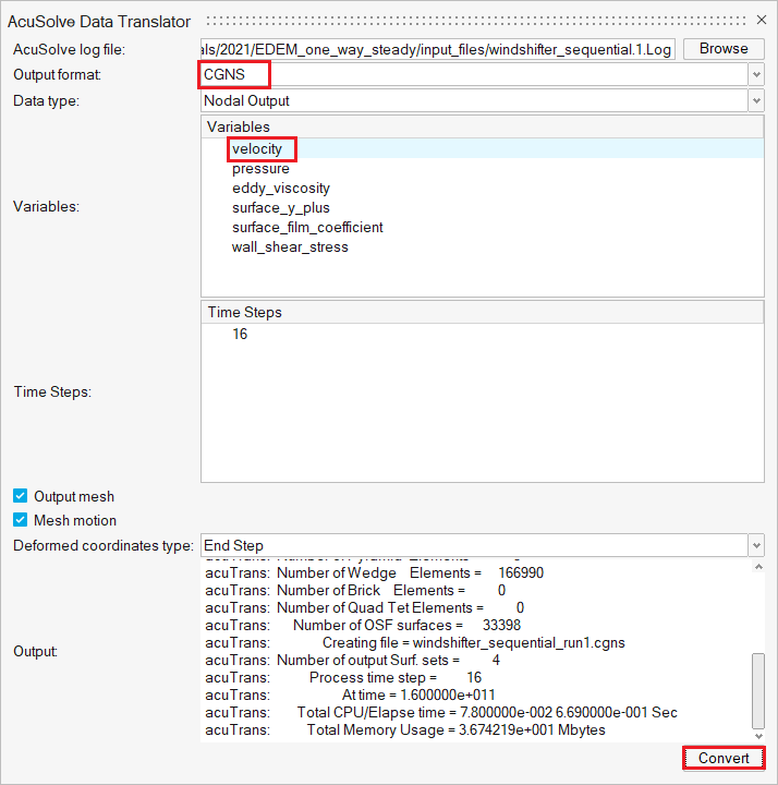

Export Velocity Field Data
  1. From the Solution ribbon, click the Convert tool.
    Figure 18.
    The AcuSolve Data Translator dialog opens.
  2. In the dialog, click Browse, navigate to the AcuSolve problem directory, and open the windshifter_sequential.1.Log file.
  3. Set the Output format to CGNS.
  4. Select velocity from the list of variables.
  5. Click Convert to export the velocity nodal data in CGNS format.
    Figure 19.
    Once the process is successful, the same information is printed in the Output field and a CGNS file is created in the AcuSolve problem directory.

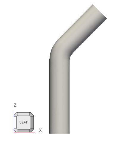

  4. Select the Left face on the view cube to align the model to the x-z plane.
    Figure 20.

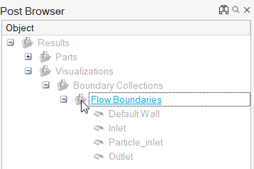

  5. In the Post Browser, turn off the display of the boundary surfaces by clicking the icon next to Flow Boundaries.
    Figure 21.

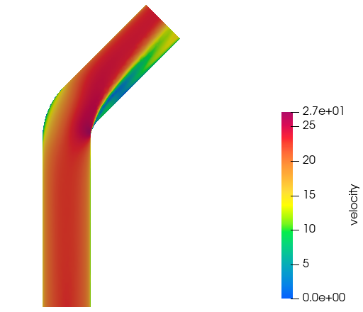

  6. Click the Slice Planes tool.
    Figure 22.
  7. In the modeling window, click on the plane that is parallel to the screen (the x-z plane).
  8. In the slice plane microdialog, click to create the slice plane.
  9. In the display properties microdialog, set the display to velocity and activate the Legend toggle.
  10. Click and set the Colormap name to Rainbow Uniform.
    Figure 23.
  11. Click on the guide bar.
    Figure 24.

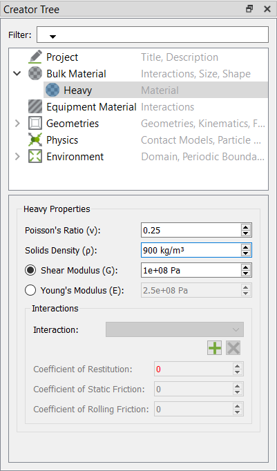

  1. In the Creator Tree, right-click Bulk Material and select Add Bulk Material.
  2. Rename the material to Heavy.
  3. In the Creator Tree, set the Solids Density property to 900 kg/m3.
    You will use the default values for other properties for this tutorial.

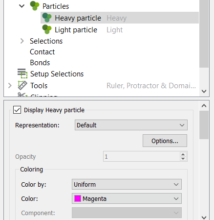

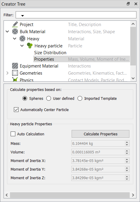

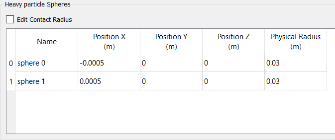

  5. In the Creator Tree, right-click Heavy and select Add Shape from Library > Dual Sphere Shape.
  6. Rename the particle to Heavy particle.
  7. Under Heavy particle, click Properties.
  8. In the Heavy particle Spheres panel, set the Physical Radius of both the spheres to 0.03 m and press Enter.
    Figure 28.
  9. In the Creator Tree, click Calculate Properties.
    Figure 29.

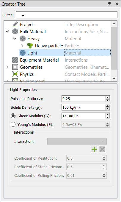

  10. In the Creator Tree, right-click Bulk Material and select Add Bulk Material.
  11. Rename the material to Light.
  12. In the Creator Tree, set the Solids Density property to 100 kg/m3.
    Figure 30.

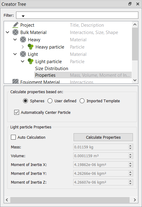

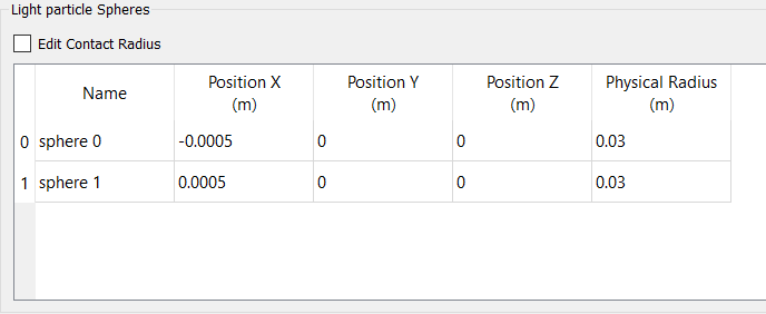

  15. In the Creator Tree, right-click Light and select Add Shape from Library > Dual Sphere Shape.
  16. Rename the particle to Light particle.
  17. Under Light particle, click Properties.
  18. In the Light particle Spheres panel, set the Physical Radius of both the spheres to 0.03 m and press Enter.
    Figure 31.
  19. In the Creator Tree, click Calculate Properties.
    Figure 32.

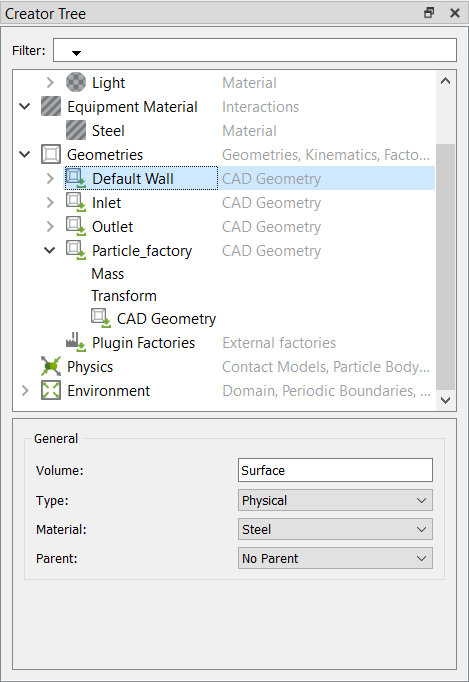

  1. Expand Geometries under the Creator Tree tab. Next, right-click the Particle inlet surface group and select Copy Geometry > Single Copy.
  2. Rename the new geometry section to Particle_factory.
  3. Right-click the Default Wall geometry section in the Creator Tree and select Merge Geometry(s).
  4. In the Merge Geometry dialog, select the Particle_inlet and then click OK.
  5. Click the Default Wall geometry section, set the Type to Physical, and the Material to Steel (if not set already).
    Figure 33.

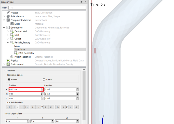

  6. In the Creator Tree, click the Inlet section and change the Type to Virtual.
  7. Similarly, change the Type to Virtual for the Outlet and Particle_factory sections.
  8. Under Particle_factory, click Transform. Set the X-Position to 0.035 m.
    Figure 34.
    Note: Set the Opacity value to 0.2 to see the transformed surface location inside the pipe geometry.
    This is done to make sure that the particles are generated inside the fluid domain.

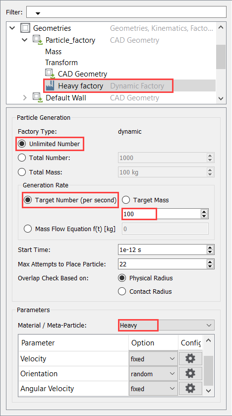

  1. In the Creator Tree, right-click Particle_factory and select Add Factory.
  2. Rename the new factory to Heavy factory.
  3. Set the particle generation parameters as shown in the figure below.
    Figure 35.
  4. Click besides Velocity, set the X-velocity to 1 m/s, and then click OK.

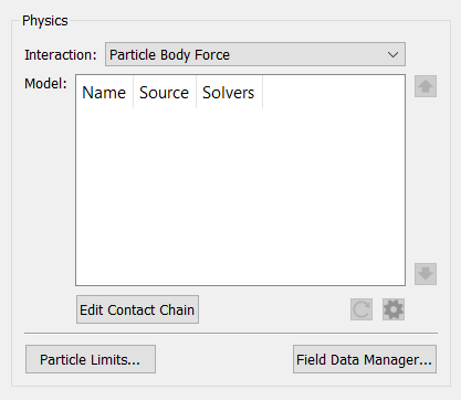

  1. In the Creator Tree, click Physics.
  2. Click the Interaction drop-down menu and select Particle Body Force.
    Figure 36.
  3. Click Edit Contact Chain.
  4. In the dialog, select the Schiller and Naumann Drag model and then click OK.

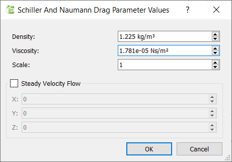

  5. In the Physics tab, click Schiller and Naumann Drag and then click .
  6. In the Schiller and Naumann Drag Parameter Values dialog, enter the values as shown in the figure below and then click OK.
    Figure 37.

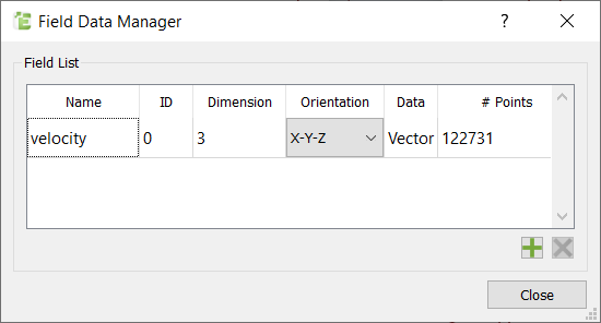

  7. In the Physics tab, click the Field Data Manager.
  8. In the Field Data Manager dialog, click then browse to the AcuSolve problem directory where you saved the CGNS file exported using the CFD field data. Open windshifter_sequential_run1.cgns.
  9. Once the data import is complete, double-click Velocity and rename it to velocity. (The letter ‘v’ should be in lower case). Then, close the dialog.
    Figure 38.

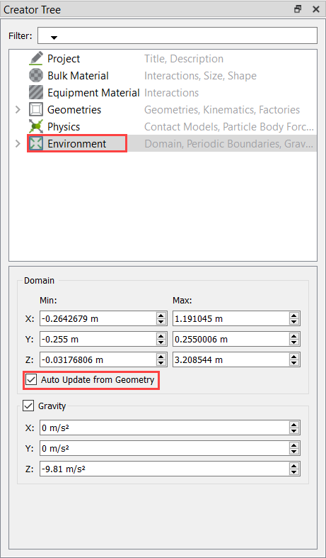

Define the Environment
In this step, you will define the extents of the domain for the EDEM simulation and the direction of gravitational acceleration.

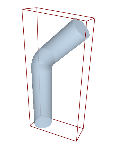

  1. In the Creator Tree, click Environment.
  2. Activate the checkbox for Auto Update from Geometry (if not already selected).
    When a moving particle touches the bounding faces of the domain (environment), it will be removed from the simulation.
  3. Activate Gravity and set the z-value to -9.81 m/s2.
  4. Save the EDEM deck.

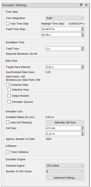

Define the Simulation Settings and Run the Simulation
  1. Click in the top-left corner to go to the EDEM Simulator tab.
  2. In the Simulator Settings tab, set the Time Integration scheme to Euler and activate the Auto Time Step checkbox (if not set already).
  3. Set the Total Time to 1 s and the Target Save Interval to 0.01 s.
  4. Set the Cell Size to 4 R min.
    Generally, a value in the range of 3-6 Rmin is recommended as the optimum cell size. The cell size in EDEM doesn’t have any impact on the accuracy of the simulation and affects only the run time.
  5. Set the Selected Engine to CPU Solver and set the Number of CPU Cores based on availability.
    Figure 39.
  6. Once the simulation settings have been defined, click to start the EDEM simulation.

  4. In the Analyst Tree, expand Particles and click Heavy particle.
  5. Change the display color to Magenta.

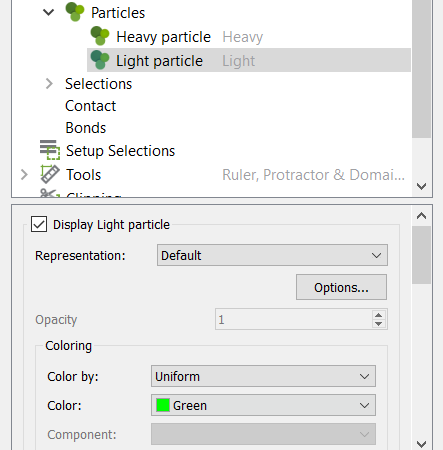

  6. Click Light particle and set the display color to Green.
    Figure 42.

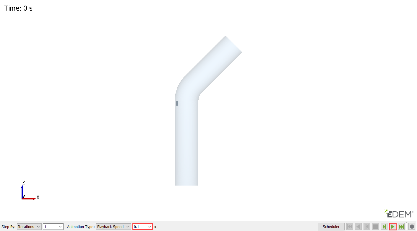

  7. On the menu bar, set the time to 0 by clicking:
    Figure 43.
  8. Set the View plane to + Y.
    Figure 44.
  9. In the Viewer window, set the Playback Speed to 0.1x then click on the play icon to play the particle flow animation.
    Figure 45.
    Figure 46.

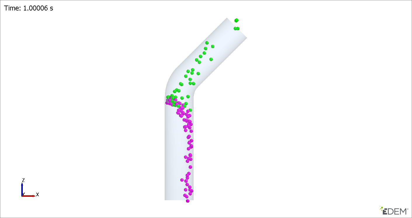

    Observe that the lighter particles (green) get carried by the fluid and escape the domain through the outlet at the top and the heavier particles (magenta) stay inside the domain for a longer time while some of them fall through the bottom of the pipe.
