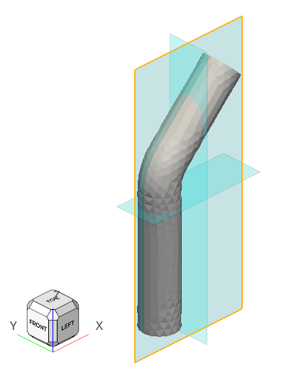

The problem to be solved is shown schematically in Figure 1. It is a windshifter model in which air enters the domain from the inlet at the bottom at a velocity of 20 m/sec and exits through the outlet. The temperature of the incoming fluid is 293 K. Particles at a temperature of 363 K are introduced into the fluid domain. As the particles move through the fluid domain, they exchange energy with the surrounding fluid and as a result their temperature drops down before they exit the fluid domain. The walls of the pipe are maintained at a constant temperature of 293 K.
The model consists of a cylindrical pipe with a 45-degree bend. The radius of the pipe is 0.25 m and the particle inlet is located midway through the length of the pipe.

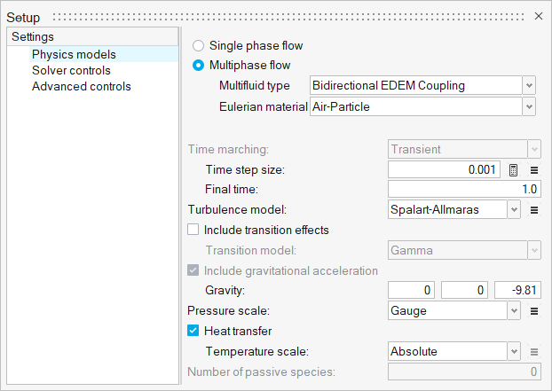

  1. From the Flow ribbon, click the Physics tool.
    Figure 5.
    The Setup dialog opens.
  2. Under the Physics models setting, select the Multiphase flow radio button.
  3. Change the Multifluid type to Bidirectional EDEM Coupling.
  4. Click the Eulerian material drop-down menu and select Material Library from the list.
    You can create new material models in the Material Library.
  5. In the Material Library dialog, select EDEM 2 Way Multiphase, switch to the My Material tab, then click to add a new material model.
  6. In the microdialog, click EDEM Bidirectional Material in the top-left corner and change the name to Air-Particle.
  7. Set the Carrier field to Air (if not set already).

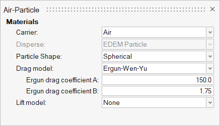

  8. Set the drag model and the drag coefficients as shown in the figure below.
    Figure 6.
  9. Close the material model microdialog and then close the Material Library dialog.
  10. In the Setup dialog, set the Eulerian Material to Air-Particle.
  11. Set Time step size and Final time to 0.001 and 1, respectively. Select Spalart-Allmaras for the Turbulence model.
  12. Verify that Gravity is set to 0, 0, -9.81.
  13. Activate the Heat transfer checkbox.

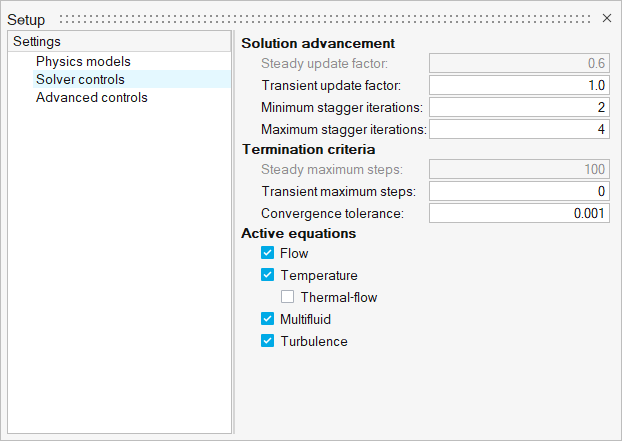

  14. Click the Solver controls setting and set the Minimum and Maximum stagger iterations to 2 and 4, respectively.
    Figure 8.

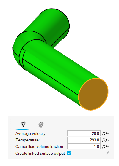

  1. From the Flow ribbon, Profiled tool group, click the Profiled Inlet tool.
    Figure 10.
  2. Click on the inlet face highlighted in the figure below. In the microdialog, enter a value of 20 m/s for the Average velocity, 293 K for Temperature, and 1.0 for the Carrier fluid volume fraction.
    Figure 11.
  3. On the guide bar, click to execute the command and exit the tool.

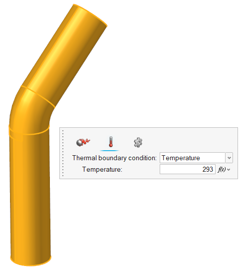

  8. In the microdialog, click the Temperature tab and set the parameters as shown in the figure below.
    Figure 15.

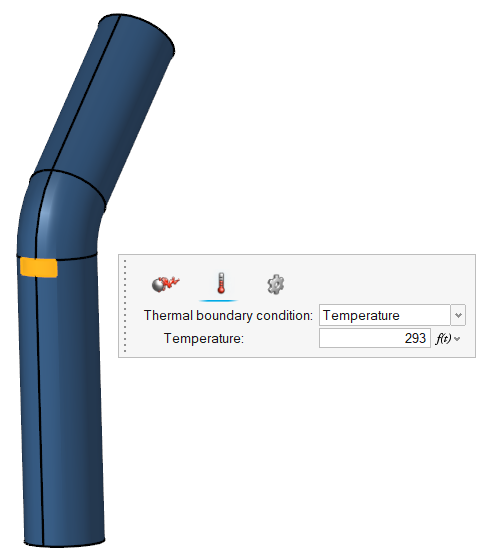

  10. Select the face highlighted in the figure below. In the microdialog, click the Temperature tab and set the parameters as shown.
    Figure 16.

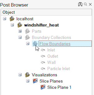

  12. In the Boundaries legend, right-click Wall 1 and rename it to Particle Inlet.
    You will use this surface as a reference geometry to create a particle factory in EDEM. Hence, you are placing this surface in a different geometry group.

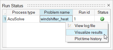

    The Run Status dialog opens. Once the run is complete, the status is updated and you can close the dialog.
    Tip: Right-click the mesh job and select View log file to view a summary of the meshing process.

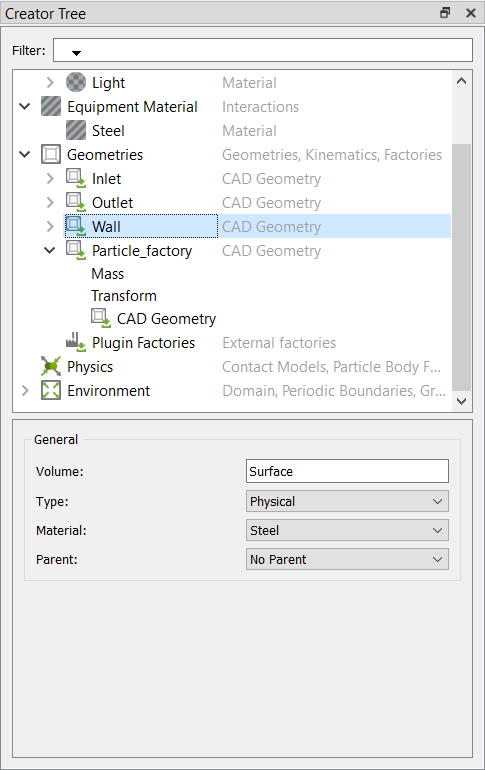

  1. Expand Geometries under the Creator Tree tab. Next, right-click the Particle Inlet surface group and select Copy Geometry > Single Copy.
  2. Rename the new geometry section to Particle_factory.
  3. Right-click the Wall geometry section in the Creator Tree and select Merge Geometry(s).
  4. In the Merge Geometry dialog, select the Particle Inlet and then click OK.
  5. Click the Wall geometry section, set the Type to Physical, and the Material to Steel (if not set already).

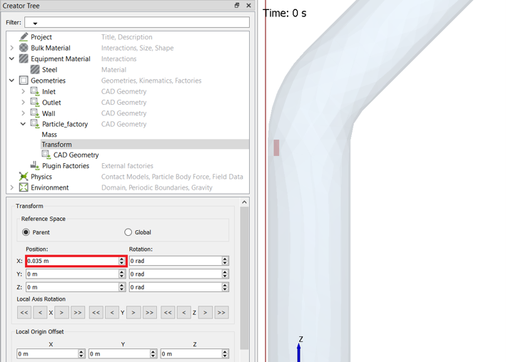

  8. Under Particle_factory, click Transform. Set the X-Position to 0.035 m.
    Figure 30.
    Note: Set the Opacity value to 0.2 to see the transformed surface location inside the pipe geometry.
    This is done to make sure that the particles are generated inside the fluid domain.

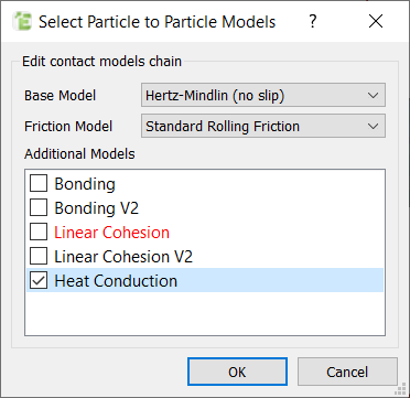

  2. Set the Interaction drop-down to Particle to Particle and click Edit Contact Chain.
  3. In the dialog, activate Heat Conduction and click OK.

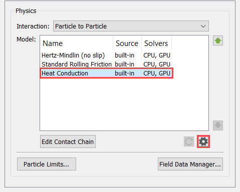

  4. In the Physics tab, click Heat Conduction and then click .

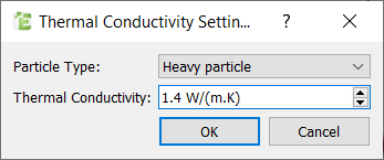

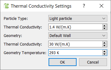

  5. In the dialog, set the Thermal conductivity of both Heavy and Light particles to 1.4 W/mK and then click OK.
    Figure 33.

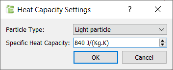

  14. In the dialog, set the specific heat capacity for both the particle types to 840 J/kgK and then click OK.

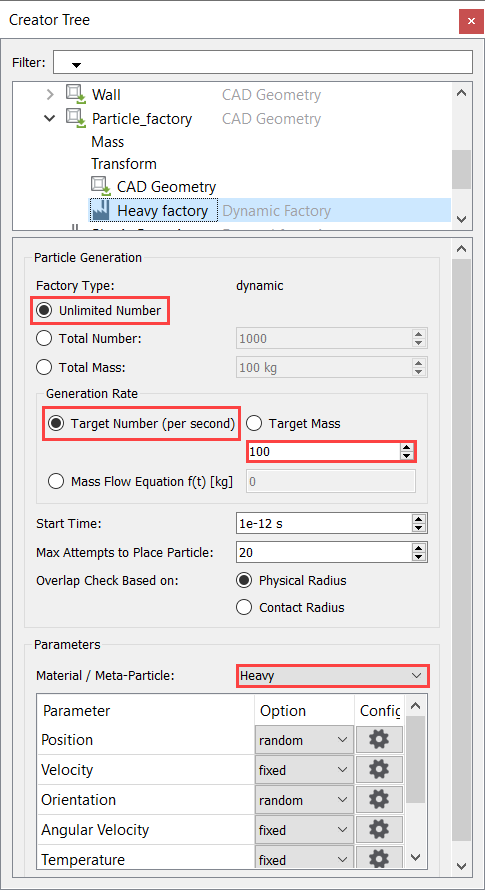

  1. In the Creator Tree, right-click Particle_factory and select Add Factory.
  2. Rename the new factory to Heavy factory.
  3. Set the particle generation parameters as shown in the figure below.
    Figure 36.

    When a moving particle touches the bounding faces of the domain (environment), it will be removed from the simulation.
  3. Activate Gravity and set the z-value to -9.81 m/s2.
  4. Save the EDEM deck.

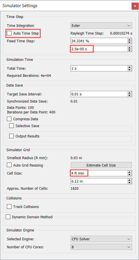

  1. Click in the top-left corner to go to the EDEM Simulator tab.
  2. In the Simulator Settings tab, set the Time Integration scheme to Euler and de-activate the Auto Time Step checkbox.
  3. Set the Fixed Time Step to 2.5e-5 s.
    Note: Generally, a value of 20-40% of the Rayleigh Time Step is recommended as the time step size to ensure stability of the DEM simulation.
  4. Set the Total Time to 1 s and the Target Save Interval to 0.01 s.
  5. Set the Cell Size to 4 R min.
    Generally, a value in the range of 3-6 Rmin is recommended as the optimum cell size.
  6. Set the Selected Engine to CPU Solver and set the Number of CPU Cores based on availability.
    Figure 37.
  7. Once the simulation settings have been defined, save the model.

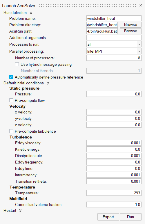

  2. Return to HyperMesh CFD.
  3. From the Solution ribbon, click the Run tool.
    Figure 40.
    The Launch AcuSolve dialog opens.
  4. Set the Parallel processing option to Intel MPI.
  5. Optional: Set the number of processors to 4 or 8 based on availability.
  6. Expand Default initial conditions, uncheck Pre-compute flow and set the velocity values to 0. Uncheck Pre-compute Turbulence.
  7. Set the Temperature to 293 K.
  8. Click Run to launch AcuSolve.
    Figure 41.
    Once the AcuSolve run is launched, the Run Status dialog opens.

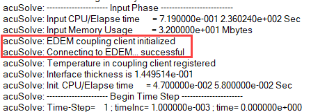

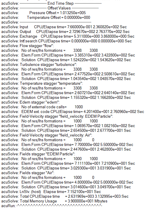

  9. In the dialog, right-click the AcuSolve run and select View log file.
    If the coupling with EDEM is successful, that information is printed in the .log file.
    Figure 42.
    Once the simulation is complete, the summary of the run time is printed at the end of the .log file.
    Figure 43.

  1. In HyperMesh CFD, right-click the AcuSolve run in the Run Status dialog and select Visualize results.
    Figure 44.
    The results are loaded in the Post ribbon.
  2. Click the Slice Planes tool.
    Figure 45.
  3. Select the x-z plane as highlighted in the figure below.
    Figure 46.
  4. In the slice plane microdialog, click to create the slice plane.

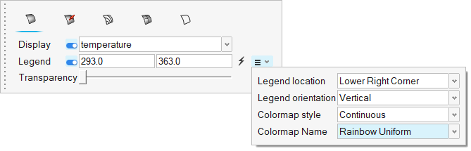

  5. In the display properties microdialog, set the display to temperature and activate the Legend toggle.
  6. Change the bounds of the legend to 293 and 363.
  7. Click and set the Colormap name to Rainbow Uniform.
    Figure 47.
  8. Click on the guide bar.
  9. In the Post Browser, turn off the visibility of Flow Boundaries by clicking its icon.

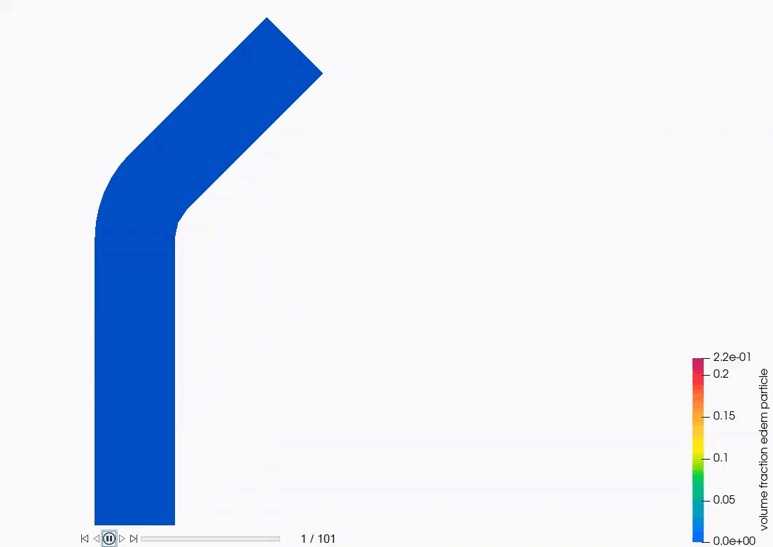

  12. To plot the volume fraction edem particle variable, right-click Slice Plane 1 in the Post Browser and select Edit.
  13. In the display properties microdialog, change the display variable from temperature to volume fraction edem particle and the legend bounds to 0 and 0.2190.
  14. Click on the guide bar.
  15. Click to start the animation.
    Figure 51.

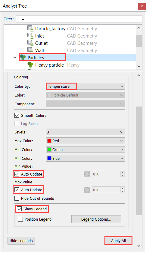

  4. In the Analyst Tree, click Particles.
  5. Set the coloring to Temperature.
  6. Activate the Auto Update checkboxes for both the Min and Max Value.
  7. Activate the Show Legend checkbox.
  8. Click Apply All.
    Figure 53.
