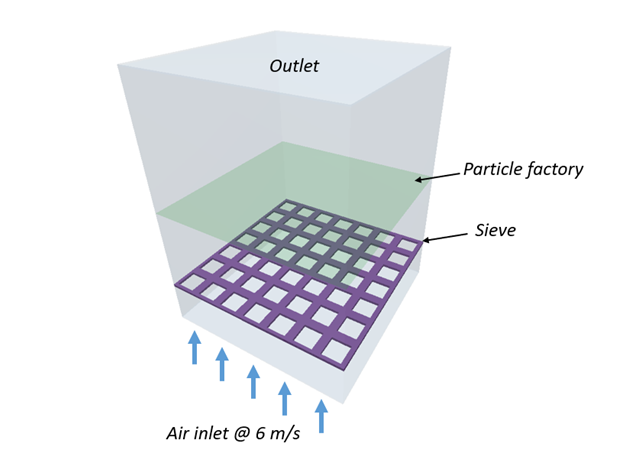

The problem to be solved is shown schematically in the figure below. The model consists of a simple sieve which oscillates at a frequency of 5 Hz and has an amplitude of 0.02 m. Particles are introduced into the system from the top at a velocity of 1 m/s. The particles fall through the openings in the sieve and as air is blown from the inlet at the bottom, the lighter bar-shaped particles get separated from the heavier spherical particles. An average velocity of 6 m/s is applied on the inlet face and the Arbitrary Lagrangian Eulerian approach is used for the mesh motion.
A sinusoidal motion along the z-axis is assigned to the sieve. The motion profile is shown below:
AcuSolve-EDEM bidirectional coupling is used to model the interaction between the fluid and particles. In this tutorial, non-spherical drag force models are used to accurately predict the drag forces on the particles by taking the shape of particles into consideration. The length scale used for factoring in the shape of the particles is the aspect ratio. Bar shaped particles with an aspect ratio of 2.75 and spherical particles with aspect ratio 1 are used for this simulation. The Rong drag model is used in conjunction with the Holzer-Sommerfeld non-spherical drag coefficient model.

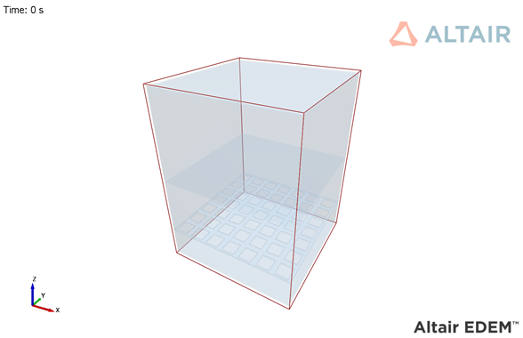

  2. In the dialog, browse to your problem directory and open the sieve.dem file.
    The geometry is loaded.

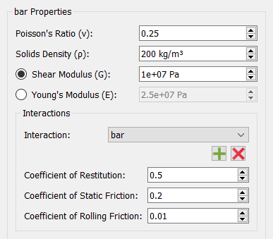

  1. In the Creator Tree, right-click Bulk Material and select Add Bulk Material.
  2. Rename the material to bar.
  3. In the Creator Tree, set the Solids Density property to 200 kg/m3 and the Shear Modulus to 1e7 Pa.
  4. Click below Interaction to define the interaction properties for collisions among the bar shaped particles. In the dialog, click OK.
  5. Set the interaction coefficients as shown in the figure below.
    Figure 4.

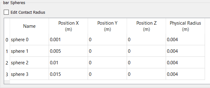

  9. In the bar Spheres panel, set the Physical Radius and the XYZ positions as shown in the figure below.
    Figure 5.

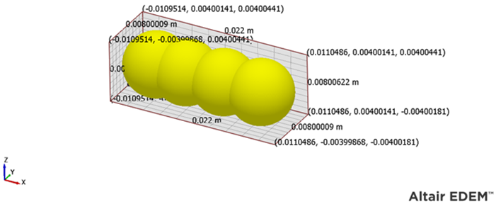

    Note: When defining non-spherical shapes, you need to make sure that the principal axis of the particle is aligned with the x-axis, as shown in the figure below. The principal axis definition for some standard shapes is explained later in this tutorial.
    Figure 6.

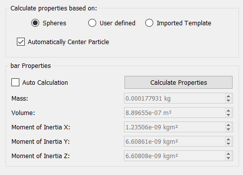

  10. In the Creator Tree, click Calculate Properties.
    Figure 7.
    Note: Since the "Automatically Center Particle" option is active, EDEM will internally adjust the positions of the spheres in the particle. Although you might see minor changes in the location of the spheres, the overall dimensions of the particle stay the same.

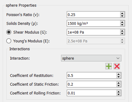

  14. Click below Interaction to define the interaction properties for collisions with sphere particles. In the dialog, select sphere and then click OK.
  15. Set the interaction coefficients as shown in the figure below.
    Figure 8.

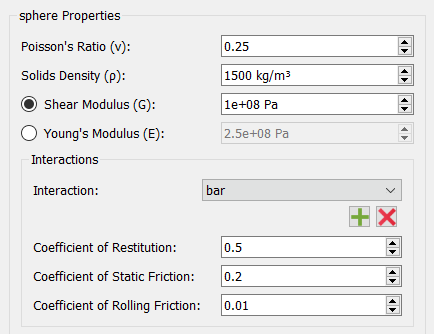

  16. Click again to define the interaction properties for collisions with bar particles. In the dialog, select bar and then click OK.
  17. Set the interaction coefficients as shown in the figure below.
    Figure 9.

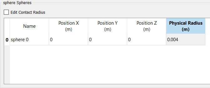

  18. In the Creator Tree, right-click sphere and select Add Shape from Library > Single Sphere Shape.
  19. Rename the particle to sphere.
  20. Under bar, click Properties.

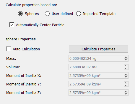

  21. In the sphere Spheres panel, set the Physical Radius of the sphere to 0.004 m and then press Enter.
    Figure 10.
  22. In the Creator Tree, click Calculate Properties.
    Figure 11.

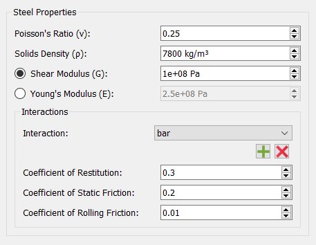

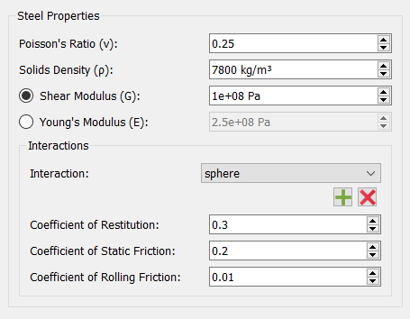

  23. Right-click Equipment Material and select Add Equipment Material.
  24. Rename the material to Steel.
  25. Set the Solids Density property to 7800 kg/m3.
  26. Click below Interaction to define the interaction properties for collisions with bar particles. In the dialog, select bar and then click OK.
  27. Set the interaction coefficients as shown in the figure below.
    Figure 12.
  28. Click again to define the interaction properties for collisions with sphere particles. In the dialog, select sphere and then click OK.
  29. Set the interaction coefficients as shown in the figure below.
    Figure 13.

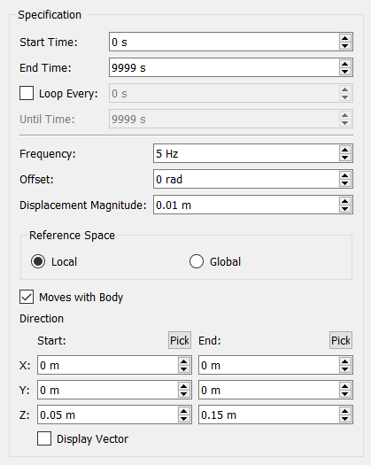

  3. Right-click Sieve and select Add Motion > Add Sinusoidal Translation Kinematic.
  4. Name it oscillation and specify the parameters as shown in the figure below.
    Figure 14.

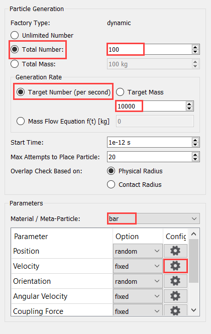

  8. Right-click factory and select Add Factory. Name it bar factory.
  9. Set the particle generation parameters as shown in the figure below.
    Figure 15.
  10. Click besides Velocity, set the Z-velocity to -1 m/s, and then click OK.
  11. Repeat steps 8-10 to create another factory named sphere factory. Use the same parameters but set the Total Number to 200 and the Material to sphere.

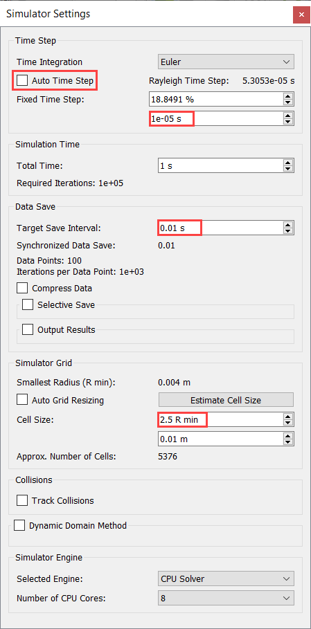

Define the Simulation Settings
  1. Click in the top-left corner to go to the EDEM Simulator tab.
  2. In the Simulator Settings tab, set the Time Integration scheme to Euler and de-activate the Auto Time Step checkbox.
    Note: The Auto time step should never be used for AS-EDEM bidirectional coupled simulations.
  3. Set the Fixed Time Step to 1e-5 s.
    Note: Generally, a value of 20-40% of the Rayleigh Time Step is recommended as the time step size to ensure stability of the DEM simulation. When setting the time step for the DEM model, make sure that the CFD time step is an integer multiple of DEM time step. In this case, the CFD time step is 1e-3, which is 50 times the DEM time step. This ensures that the physical time in both the solvers match at the end of each data exchange interval. Also, the recommended range for the CFD-to-DEM time step ratio is 50-200 for most cases.
  4. Set the Total Time to 1 s and the Target Save Interval to 0.01 s.
  5. Set the Cell Size to 2.5 R min.
    Generally, a value in the range of 2-6 Rmin is recommended as the optimum cell size.
  6. Set the Selected Engine to CPU Solver and set the Number of CPU Cores based on availability.
    Figure 16.
  7. Once the simulation settings have been defined, save the model.

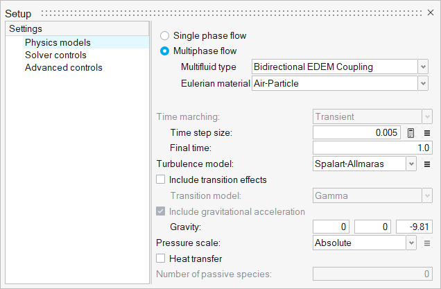

  1. From the Flow ribbon, click the Physics tool.
    Figure 19.
    The Setup dialog opens.
  2. Under the Physics models setting, select the Multiphase flow radio button.
  3. Change the Multifluid type to Bidirectional EDEM Coupling.
  4. Click the Eulerian material drop-down menu and select Material Library from the list.
    You can create new material models in the Material Library.
  5. In the Material Library dialog, select EDEM 2 Way Multiphase, switch to the My Material tab, and then click to add a new material model.
  6. In the microdialog, click EDEM Bidirectional Material in the top-left corner and change the name to Air-Particle.

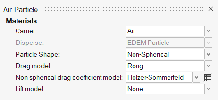

  7. Set the Carrier field to Air (if not set already).
  8. Set the particle shape to Non-Spherical.
  9. Set the drag model to Rong.
  10. Set the Non spherical drag coefficient model to Holzer-Sommerfeld.
    Figure 20.
  11. Click the table icon beside the drag coefficient model drop-down.
  12. In the new dialog, click to add a new row, and then enter the values for Aspect Ratio and Volume as shown in the figure below.
    Figure 21.

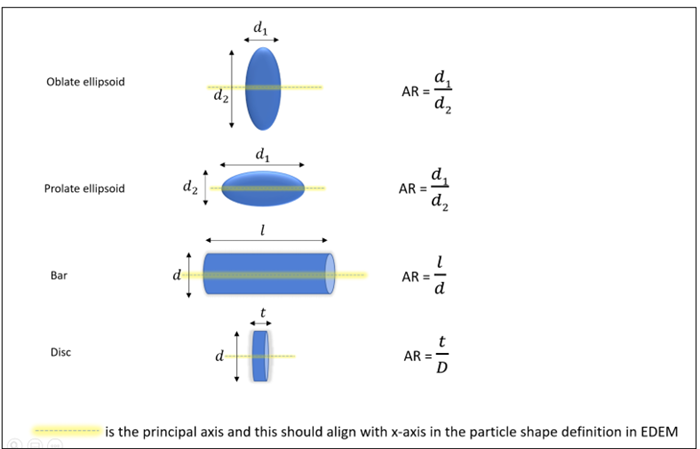

    Note: The volumes entered here should be obtained from EDEM under particle properties. There might be slight variation in the volume values that you may see in your EDEM model but that is fine.
    Here the aspect ratios are calculated based on the ratio of the length to diameter of the particles. The AR of 2.75 and 1 are for bar and sphere-shaped particles respectively. The volume of the particles can be obtained from EDEM under the particle properties. If the simulation has particles of a single shape, then the volume field can be set to zero.
    The image below explains the aspect ratio definition for some standard non-spherical particle shapes.
    Figure 22.
  13. Press Esc to close the dialog and then close the material model and Material Library dialogs as well.
  14. In the Setup dialog, set the Eulerian Material to Air-Particle.
  15. Set Time step size and Final time to 0.005 and 1, respectively. Select Spalart-Allmaras for the Turbulence model.
  16. Verify that Gravity is set to 0, 0, -9.81.
  17. Set the Pressure scale to Absolute.
    Figure 23.

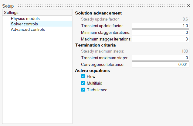

  18. Click the Solver controls setting and set the Maximum stagger iterations to 3.
    Figure 24.
  19. Close the dialog and save the model.

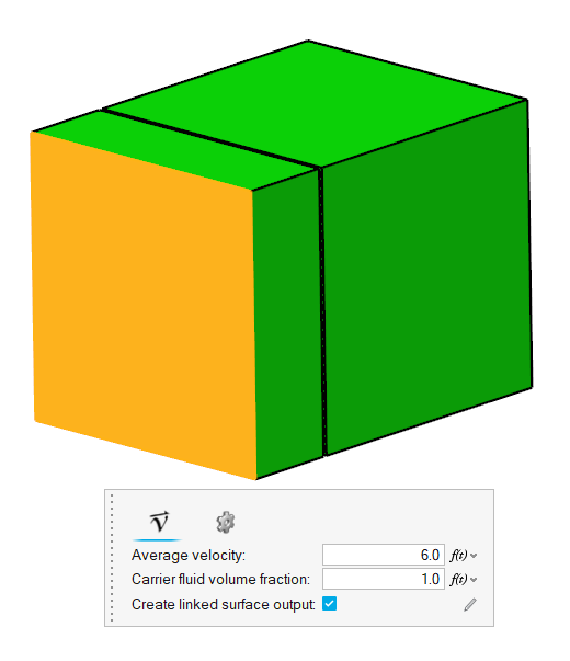

  1. From the Flow ribbon, Profiled tool group, click the Profiled Inlet tool.
    Figure 26.
  2. Click the inlet face highlighted in the figure below. In the microdialog, enter a value of 6 m/s for the Average velocity and 1.0 for the Carrier fluid volume fraction.
    Figure 27.
  3. On the guide bar, click to execute the command and exit the tool.

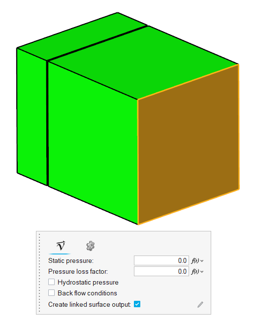

  4. Click the Outlet tool.
    Figure 28.
  5. Select the face highlighted in the figure below and then click on the guide bar.
    Figure 29.

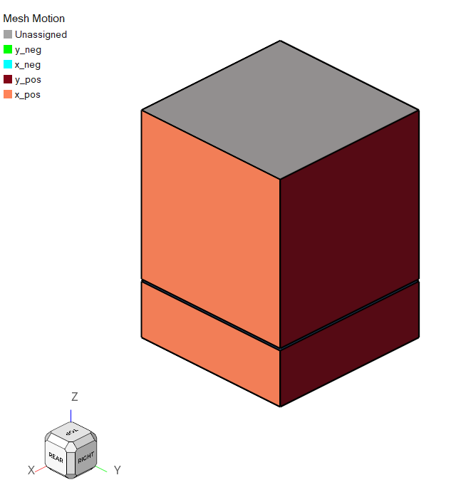

Define the Mesh Boundary Conditions
  1. From the Motion ribbon, click the Planar Slip tool.
    Figure 31.
  2. Select the two surfaces highlighted in the figure below.
    The surfaces selected have the minimum y-coordinate.
    Figure 32.
  3. In the Mesh Motion legend, double-click Planar Slip and change the name to y_neg.
  4. On the guide bar, click to execute the command and remain in the tool.
  5. Repeat steps 2-4 to create three more planar slip boundary conditions for the surfaces with the maximum y-coordinates, and the minimum and maximum x-coordinates. Name these groups y_pos, x_neg, and x_pos respectively.
    Once the four planar slip conditions are defined, the Mesh Motion legend should look like the one shown below.
    Figure 33.
  6. Save the model.

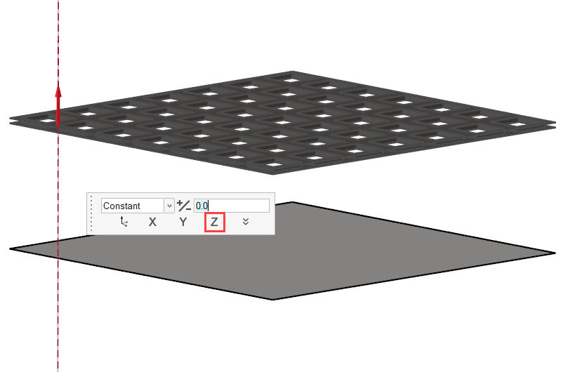

  1. From the Motion ribbon, click the Translation tool.
    Figure 34.

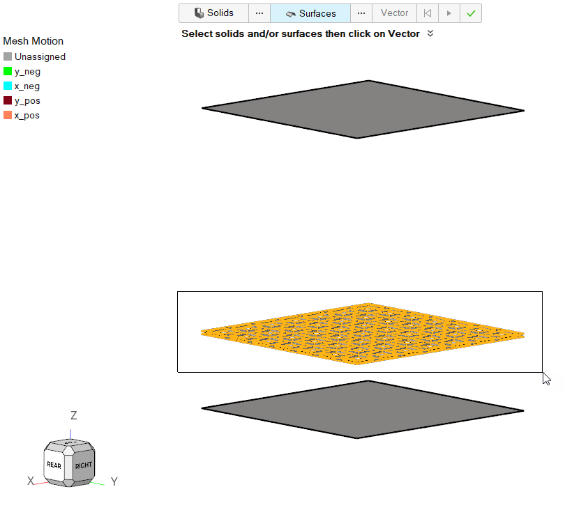

  2. In the Mesh Motion legend, right-click Unassigned and select Isolate.
  3. On the guide bar, change the active selector to Surfaces.
  4. Using box selection, select all the sieve surfaces as shown in the figure below.
    Ensure that you are not selecting the inlet or outlet faces.
    Figure 35.
  5. Click Vector on the guide bar.
  6. Click anywhere on the sieve surfaces in the modeling window.

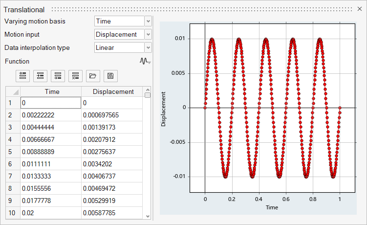

  7. In the microdialog, click Z to align the axis to the global z axis.
    Figure 36.

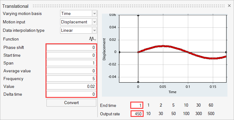

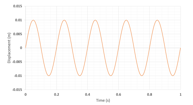

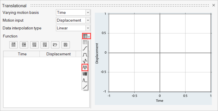

  8. In the microdialog, change the type to Time-varying and click the plot icon.
    Figure 37.
  9. In the new plot dialog, click the drop-down beside the table icon for function specification and select the oscillating option.
    Figure 38.
  10. Enter the values for the sine function as shown in the figure below.
    Figure 39.
  11. Click Convert to transform the sine function into an array for the multiplier function.
    The motion profile for the translation motion should look like the one shown below.

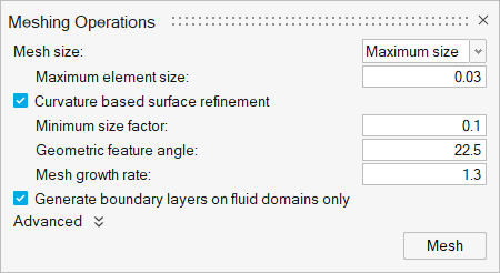

  2. Set the Mesh size to Maximum size and change the Maximum element size to 0.03.
    Figure 42.
  3. Click Mesh.
    The Run Status dialog opens. Once the run is complete, the status is updated and you can close the dialog.
    Tip: Right-click the mesh job and select View log file to view a summary of the meshing process.

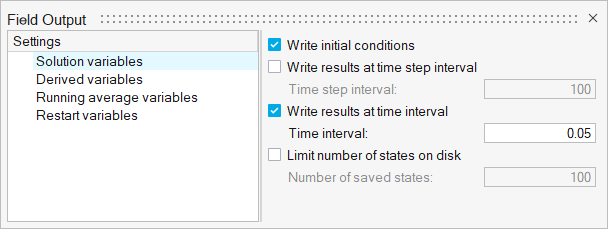

Define Nodal Outputs
Once the meshing is complete, you are automatically taken to the Solution ribbon.
  1. From the Solution ribbon, click the Field tool.
    Figure 43.
    The Field Output dialog opens.
  2. Check the box for Write Initial Conditions.
  3. Uncheck the box for Write results at time step interval
  4. Check the box for Write results at time interval.
  5. Set the Time step interval to 0.05.
    Figure 44.

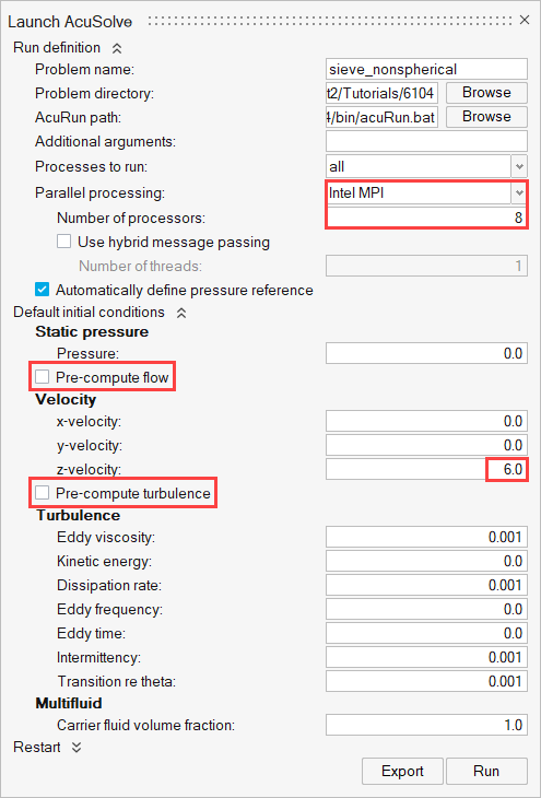

  3. From the Solution ribbon, click the Run tool.
    Figure 47.
    The Launch AcuSolve dialog opens.
  4. Set the Parallel processing option to Intel MPI.
  5. Optional: Set the number of processors to 4 or 8 based on availability.
  6. Expand Default initial conditions, uncheck Pre-compute flow and set the z-velocity value to 6. Uncheck Pre-compute Turbulence.
  7. Click Run to launch AcuSolve.
    Figure 48.

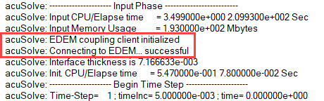

  8. In the dialog, right-click the AcuSolve run and select View log file.
    If the coupling with EDEM is successful, that information is printed in the .log file.
    Figure 49.

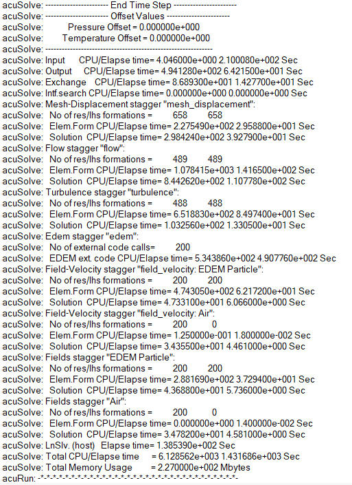

    Once the simulation is complete, the summary of the run time is printed at the end of the .log file.
    Figure 50.

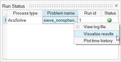

AcuSolve Post-Processing
  1. In HyperMesh CFD, right-click the AcuSolve run in the Run Status dialog and select Visualize results.
    Figure 51.

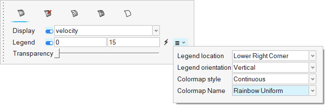

  5. In the display properties microdialog, set the display to velocity and activate the Legend toggle.
  6. Change the bounds of the legend to 0 and 15.
  7. Click and set the Colormap name to Rainbow Uniform.
    Figure 54.

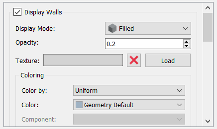

  2. In the Analyst Tree, expand Display > Geometries and then select all geometries by holding the Ctrl key.
  3. Verify that the Display Mode is set to Filled and set the Opacity to 0.2.
    Figure 58.

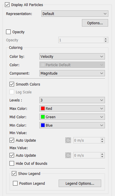

  4. In the Analyst Tree, click Particles.
  5. Set the coloring to Velocity.
  6. Activate the Auto Update checkboxes for both the Min and Max Value.
  7. Activate the Show Legend checkbox.
  8. Click Apply All.
    Figure 59.

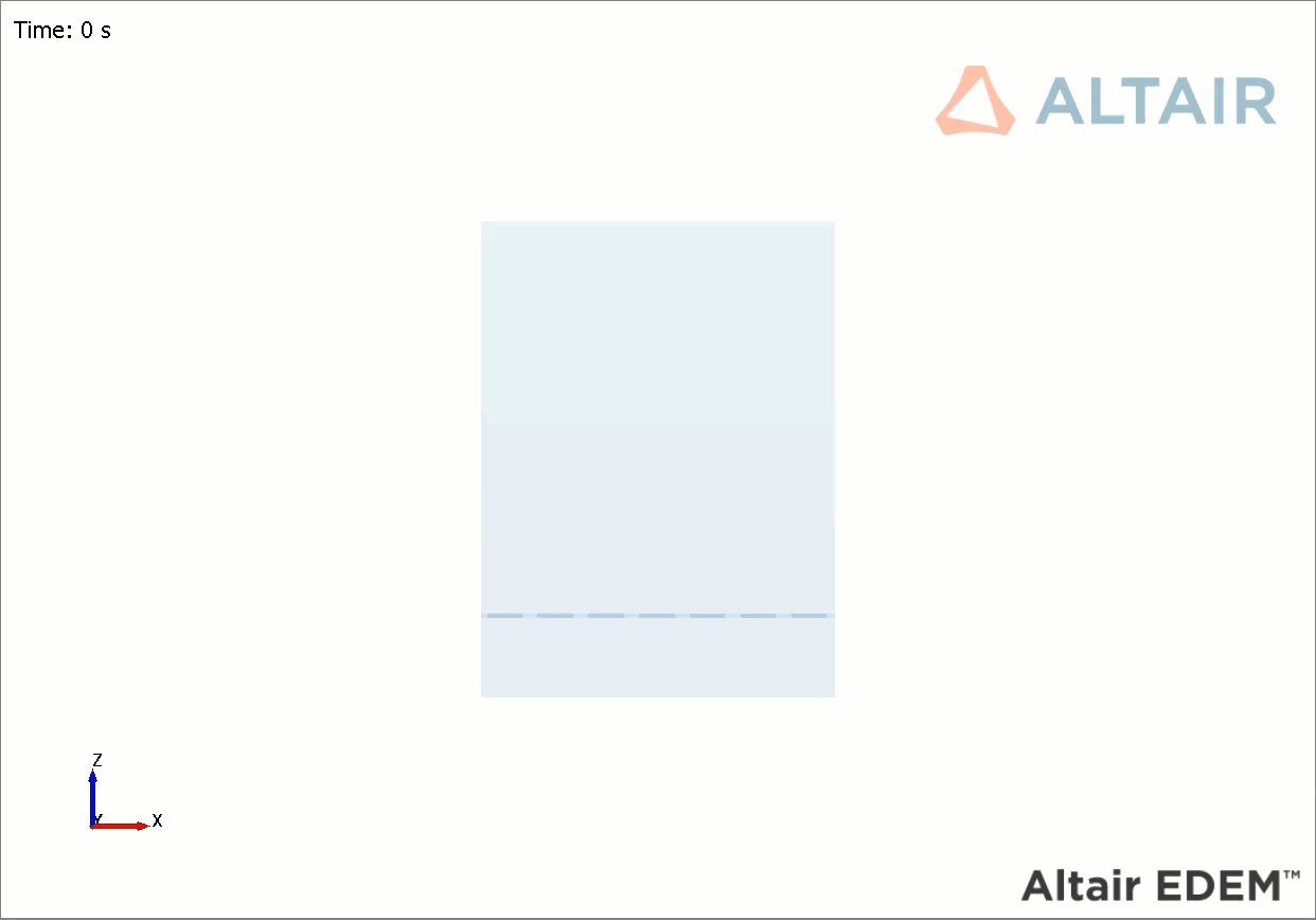

  9. On the menu bar, set the time to 0 by clicking:
    Figure 60.
  10. Set the View plane to + Y.
    Figure 61.
  11. In the Viewer window, set the Playback Speed to 0.1x and then click to play the particle flow animation.
