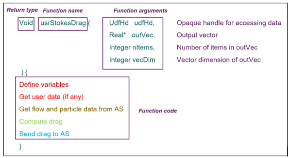

A standard C function in AcuSolve UDF has the following syntax:
Figure 3.
Return Type
All C functions should have a return type. Since the drag force values should be sent back to AcuSolve through outVec, the return value does not have any significance and the return type should be set to Void.
Function Arguments
The function arguments include:
udfHd
Pointer which contains the necessary information for accessing various data. All supporting routines require this argument.
outVec
Resulting vector of the user function. On input this array contains all zeros. This vector is used to send the force information back to AcuSolve.
nItems
This is the first dimension of outVec, which specifies the number of items that needs to be filled. For all drag model user functions, the value is 1 since you are calculating the drag force on 1 particle in each call.
vecDim
This is the second dimension of outVec which specifies the vector dimension of the particular data. This value depends on the type of data that is sent back.
Drag user function
Minimum three values (x, y ,z components) are required. Optionally a fourth value can also be sent back to AcuSolve (drag coefficient).
Lift user function
Three values (x, y, z components).
Torque user function

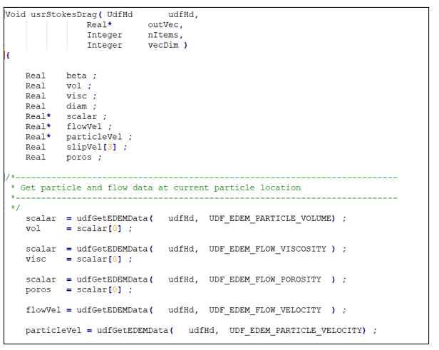

Variables:
Variables are used to store certain types of data. This data can be a single value or an array of values. In C language, all variables need to be declared before they can be used in the program. Although the declaration can be done anywhere inside the program, declaring all the required variables upfront makes the code more organized and easily understandable. The syntax for declaring a variable in C is Datatype variable_name ;
Example
Real volume ;
where Real is the data type and volume is the name of the variable.
In many UDFs, including the current example, you may need to access some data from AcuSolve which has already been calculated and stored by the solver at a particular memory address. For this, you need to declare pointer variables which point to the memory address of the requested data. For instance, if you need to access the local fluid velocity, you need to declare a pointer variable that stores the memory address of the location where AcuSolve has already stored the value.
Example
Real* xVel ;
Accessing data from AcuSolve:
The routine to be used for accessing particle and fluid data from AcuSolve is udfGetEDEMData(udfHd, dataName). This returns an array of data and length of the array depends on the type of data that is requested.
For example,
To access the particle’s volume, first you need to declare a pointer variable and then use the following data routine.
Real* vol ;
vol = udfGetEDEMData( udfHd, UDF_EDEM_PARTICLE_VOLUME) ;
Note: vol is a pointer variable and the actual value of the particle volume is stored in vol[0].

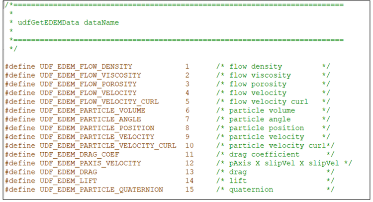

The list of all of the AS-EDEM data names is shown below.
Since using a lot of pointer variables can be confusing and difficult to track for longer UDFs, it is better to limit them to as few as possible and assign the values to other variables. For example, for the stokes drag law F D = 3 π ε d p μ U MathType@MTEF@5@5@+= feaagKart1ev2aaatCvAUfeBSjuyZL2yd9gzLbvyNv2CaerbuLwBLn hiov2DGi1BTfMBaeXatLxBI9gBaerbd9wDYLwzYbItLDharqqtubsr 4rNCHbGeaGqiVu0Je9sqqrpepC0xbbL8F4rqqrFfpeea0xe9Lq=Jc9 vqaqpepm0xbba9pwe9Q8fs0=yqaqpepae9pg0FirpepeKkFr0xfr=x fr=xb9adbaqaaeGaciGaaiaabeqaamaabaabaaGcbaGaamOramaaBa aaleaacaWGebaabeaakiabg2da9iaaiodacqaHapaCcqaH1oqzcaWG KbWaaSbaaSqaaiaadchaaeqaaOGaeqiVd0Maamyvaaaa@418B@ , you need to access the particle’s volume, and fluid’s porosity, viscosity and velocity. You can define a pointer variable named scalar and point that to the required scalar quantities such as volume, density, porosity and viscosity recursively while assigning the value to other variables in between.
Figure 4.
Once a pointer named scalar is declared, you first pointed it to the particle volume dataname. In the next line you assigned the value scalar[0] to a variable named vol. Next, you modified the pointer scalar to flow viscosity and assigned scalar[0] to visc.
Note: This is only one out of many correct ways of writing a program.

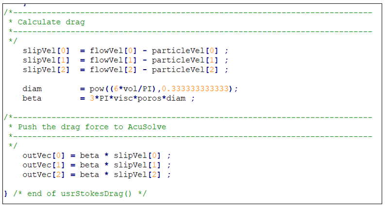

  • Calculate drag force values:
Once all the variables are declared and required data is accessed, you need to calculate the force values based on the drag law. Here, the 0,1,2 indices refer to the x, y and z components, respectively.
  • Send force data to AcuSolve:
After the force has been calculated, the outVec array should be filled. Since this is a drag force user function, at least 3 values should be sent back. Optionally, the fourth value can also be set which refers to the drag coefficient. (Not needed in this example.)

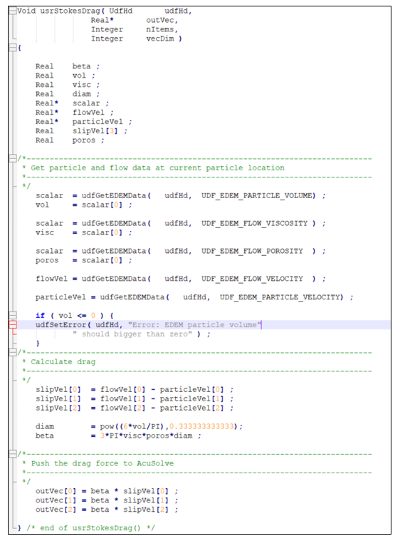

The full Stokes drag function is shown below.
Figure 6.
Full Code Snippet
#include "acusim.h"
#include "udf.h"
 * Prototype the function
UDF_PROTOTYPE( usrStokesDrag ) ;
 * "stokesDrag":  calculate EDEM particle drag force based on the Stokes law
 *  Arguments:
 *    udfHd     - opaque handle for accessing information
 *    outVec    - output vector
 *    nItems    - number of items in outVec (=1 in this case)
 *    vecDim    - vector dimension of outVec (=3 in this case)
 *  Input file parameters:
 *    user_values = { }
 *    user_strings = { "" }
Void usrStokesDrag(	UdfHd	      udfHd,
			Real*	     outVec,
			Integer	     nItems,
			Integer	     vecDim )
    Real    beta ;
    Real    vol ;
    Real    visc ;
    Real    diam ;
    Real*   scalar ;
    Real*   flowVel ;
    Real*   particleVel ;
    Real    slipVel[3] ;
    Real    poros ;
 * Get particle and flow data at current particle location
    scalar = udfGetEDEMData(	 udfHd,	UDF_EDEM_PARTICLE_VOLUME) ;
    vol = scalar[0] ;
    scalar = udfGetEDEMData(	 udfHd,	UDF_EDEM_FLOW_VISCOSITY	) ;
    visc = scalar[0] ;
    scalar = udfGetEDEMData(	 udfHd,	UDF_EDEM_FLOW_POROSITY	) ;
    poros = scalar[0] ;
    flowVel = udfGetEDEMData(	udfHd,	UDF_EDEM_FLOW_VELOCITY	) ;
    particleVel = udfGetEDEMData(   udfHd,	UDF_EDEM_PARTICLE_VELOCITY) ;
    if ( vol <= 0 ) {
	udfSetError( udfHd, "Error: EDEM particle volume"
			" should bigger than zero" ) ;
 * Calculate drag
    slipVel[0] = flowVel[0] - particleVel[0] ;
    slipVel[1] = flowVel[1] - particleVel[1] ;
    slipVel[2] = flowVel[2] - particleVel[2] ;
    diam = pow((6*vol/PI),0.333333333333);
    beta = 3*PI*visc*poros*diam ;
 * Push the drag force to AcuSolve
    outVec[0] = beta * slipVel[0] ;
    outVec[1] = beta * slipVel[1] ;
    outVec[2] = beta * slipVel[2] ;
} /* end of usrStokesDrag() */

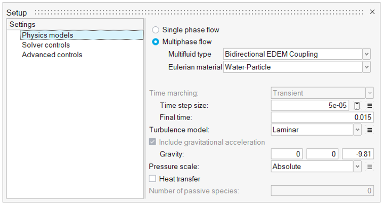

  1. From the Flow ribbon, click the Physics tool.
    Figure 9.
    The Setup dialog opens.

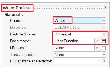

  2. Under the Physics models setting, select the Multiphase flow radio button.
  3. Change the Multifluid type to Bidirectional EDEM Coupling.
  4. Click the Eulerian material drop-down menu and select Material Library from the list.
    You can create new material models in the Material Library.
  5. In the Material Library dialog, select EDEM 2 Way Multiphase, switch to the My Material tab, and then click to add a new material model.
  6. In the microdialog, click EDEM Bidirectional Material in the top-left corner and change the name to Water-Particle.
  7. Set the Carrier field to Water.
  8. Verify that the Particle Shape is set to Spherical and set the Drag model to User Function.

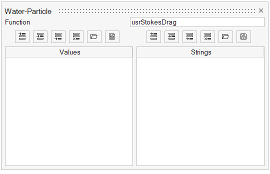

  9. Click the table icon beside the drag model drop-down.
    Figure 10.
  10. In the new dialog, set the Function name to usrStokesDrag.
    Note: The function name entered here should be the same as the name of the UDF_PROTOTPYE in the UDF. The user-function name can be any name supported in C that starts with the letters usr.
    Figure 11.
  11. Press Esc to close the dialog.
  12. Close the Material Model and Material Library dialogs.
  13. In the Setup dialog, set the Eulerian material to Water-Particle.
  14. Set Time step size and Final time to 5e-05 and 0.015, respectively.
  15. Set the Turbulence model to Laminar.
    The calculated particle Reynolds number is less than 0.3 which is in the Stokes regime where the viscous forces dominate the inertial forces and the turbulence effects can be neglected.
  16. Verify that Gravity is set to 0, 0, -9.81.
  17. Set the Pressure scale to Absolute.

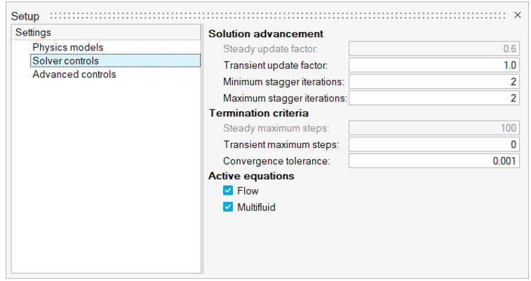

  18. Click the Solver controls setting and set the Minimum/Maximum stagger iterations to 2, respectively.
    Figure 13.

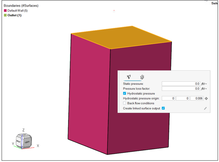

  1. Click the Outlet tool in the Boundaries group.
    Figure 15.
  2. In the modeling window, click the top surface of the model, which is highlighted in the figure below.
    Figure 16.
  3. In the microdialog, activate the Hydrostatic pressure option and set the Hydrostatic pressure origin to (0, 0, 0.006.)
  4. Click on the guide bar.
    Note: A no-slip wall condition is assigned to all surfaces by default.

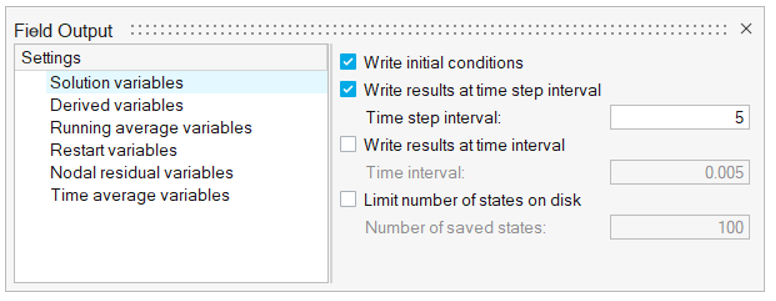

  1. From the Solution ribbon, click the Field tool.
    Figure 18.
    The Field Output dialog opens.
  2. Check the box for Write initial conditions.
  3. Check the box for Write results at time step interval.
  4. Set the Time step interval to 5.
    Figure 19.

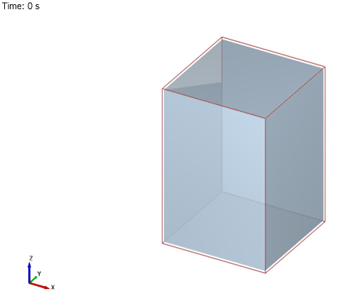

    Figure 20.
Review the EDEM Model Setup
The main area of focus for this tutorial is the user-defined drag model setup and compilation process for a bidirectional AcuSolve - EDEM coupling simulation. Therefore, for the sake of brevity, the EDEM database provided with the input files contains all of the required setup.

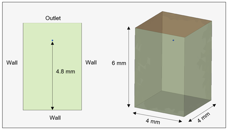

Summary of the EDEM Model
A spherical particle of diameter 0.0001 m is introduced in a water column at a point which is 0.0048 m from the bottom. Since the density of the particle is 1500 kg/m3, that is, heavier than water, the particle falls freely through the water column.

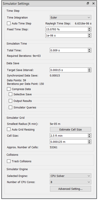

Define the Simulation Settings
  1. Click in the top-left corner to go to the EDEM Simulator tab.
  2. In the Simulator Settings tab, set the Time Integration scheme to Euler and deactivate the Auto Time Step checkbox.
  3. Enter a value of 1e-6s for Fixed Time Step.
    Note: Generally, a value of 20-40% of the Rayleigh Time Step is recommended as the time step size to ensure stability of the DEM simulation. Since the DEM time steps are usually a few orders lower than the CFD time step, for every CFD time step the DEM solver performs multiple iterations to match with the CFD time. Therefore, the CFD time step should always be an integer multiple of DEM time step to ensure that the physical times in both AcuSolve and EDEM match.
  4. Set the Total Time to 0.015 s and the Target Save Interval to 0.00015 s.
  5. Set the Cell Size to 2.5 R min.
  6. Set the Selected Engine to CPU Solver and set the Number of CPU Cores based on availability.
    Figure 21.
  7. Once the simulation settings have been defined, save the model.

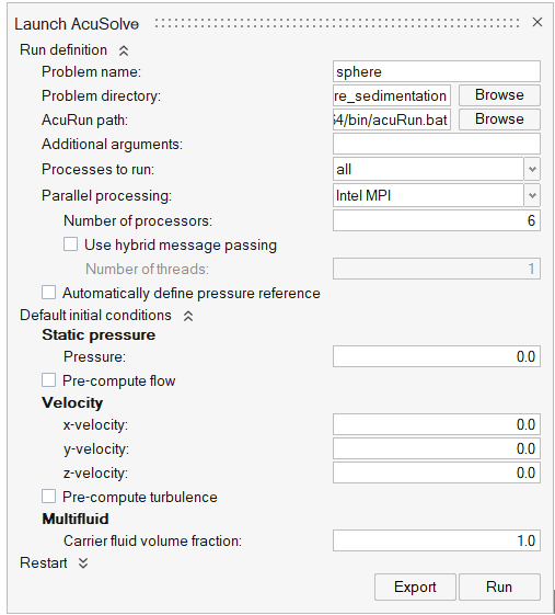

  2. Return to HyperMesh CFD.
  3. From the Solution ribbon, click the Run tool.
    Figure 24.
    The Launch AcuSolve dialog opens.
  4. Set the Parallel processing option to Intel MPI.
  5. Set the Number of processors to 6.
  6. Uncheck Automatically define pressure reference.
  7. Expand Default initial conditions, uncheck Pre-compute flow and set the velocity values to 0. Uncheck Pre-compute Turbulence.
  8. Click Run to launch AcuSolve.
    Figure 25.

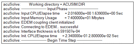

    Once the AcuSolve run is launched, the Run Status dialog opens.
  9. In the dialog, right-click the AcuSolve run and select View log file.
    If the coupling with EDEM is successful, that information is printed in the .log file.
    Figure 26.
    Once the simulation is complete, the summary of the run time is printed at the end of the .log file.

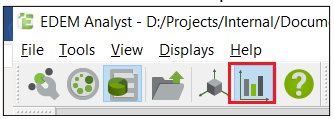

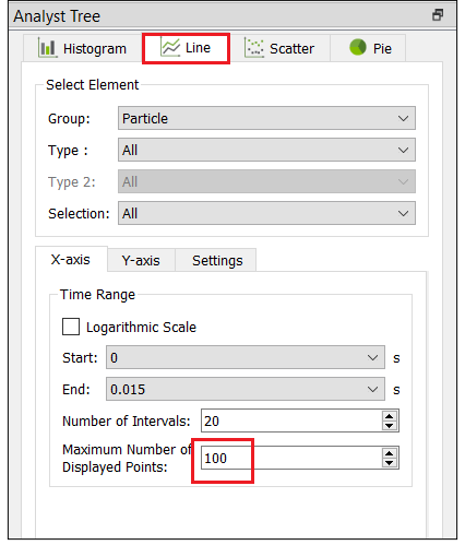

  1. Once the EDEM simulation is complete, click in the top-left corner to go to the EDEM Analyst tab.
  2. Click the Create Graph icon.
    Figure 27.

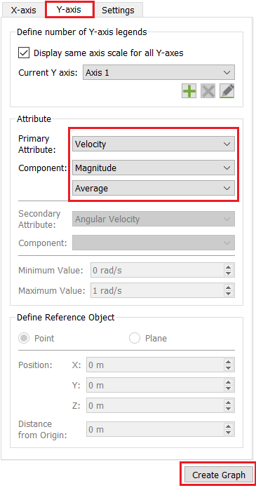

  3. In the Analyst tree, select the Line plot and make sure that the parameters for X-axis are set as shown in the figure below.
    Figure 28.
  4. Click the Y-axis tab and set the Primary Attribute to Velocity and the Component to Magnitude (Average).
  5. Click Create Graph.
    Figure 29.

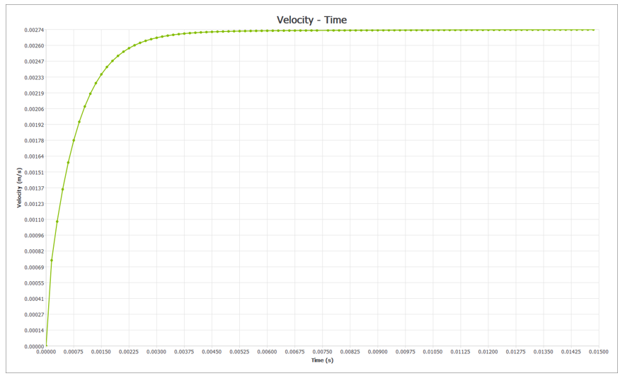

    The particle velocity vs time plot displays in the plot window.
    Figure 30.
    As expected, at the beginning of the simulation, the particle accelerates from zero-velocity because of gravity. As the particle moves and displaces the surrounding fluid, the frictional drag on the particle increases and due to the combined effect of buoyancy and drag force, the acceleration reduces to 0 and the particle moves with a constant velocity. This is known as the particle terminal velocity and in this case the predicted value is 0.00274 m/s which is very close (0.5% error) to the analytical solution (0.002725 m/s). This shows that the Stokes drag law is very accurate in predicting the fluid-induced drag forces for creeping flows.
