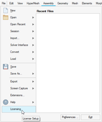

  1. Open the License Setup dialog using one of the following options:
    • If you have configured your license, navigate to File > Licensing.
    • If you have not configured your license, the License Setup dialog shown in the next step displays automatically when you start the application.

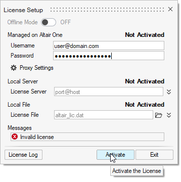

  2. In the License Setup dialog, enter your Altair One credentials (Username and Password) under the Managed on Altair One section.
    Figure 2. License Setup Dialog
  3. Click Activate.

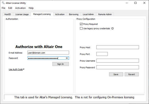

  2. Click the Managed Licensing tab.
  3. In the Authorization section, enter your Altair One credentials (E-mail Address and Password).
  4. Click Sign In.
    Figure 3.

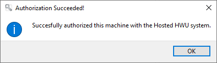

    A message displays that the authorization was successful.
    Figure 4.
  5. Click OK.
