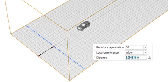

  4. Optional: Select the boundary layer suction line in the modeling window and turn the boundary layer suction off in the microdialog.
  5. Optional: Select the boundary layer suction line in the modeling window and define the location reference in the microdialog.

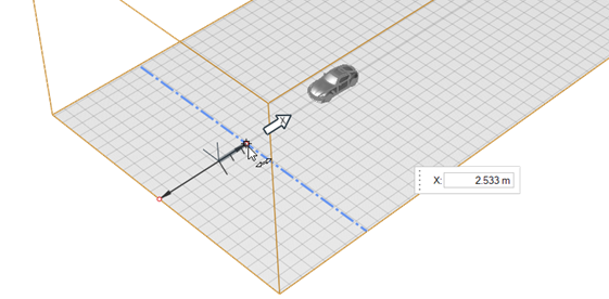

  6. Edit the boundary layer suction by selecting the boundary layer suction line in the modeling window and completing one of the following:
    • Enter a distance value in the microdialog.
    Figure 3.
    • Click in the microdialog and drag the boundary layer suction line.
    Figure 4.

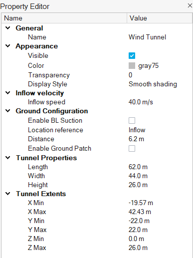

  7. Optional: Ground Configuration properties (among others) can be defined in the Property Editor panel.
    1. Define ground configuration properties, including:
      • Enable BL (boundary layer) Suction.
        • Location reference.
        • Distance.

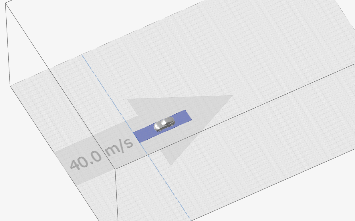

      • Enable Ground Patch: Create a finite ground patch with a no-slip boundary condition around the car instead of the entire wind tunnel floor.
        Note: When a ground patch is enabled, it will become visible in the model window.
      • Length: sets the length of the ground patch behind the car as a ratio of the car's length.
      • Width: sets the width of the ground patch on either side of the car as a ratio of the car's width.
    Figure 5.
