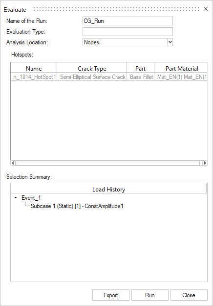

Use the Run Analysis tool to set up and launch the evaluation.
  1. From the Evaluate tool group, click the Run Analysis tool.
    The Evaluate dialog opens.
  2. Optional: Change the name of the run.
  3. Review the selected parts, hotspot name and loadcase.
  4. Click Run.
    The status bar highlights the run progress.
    Figure 3.
  5. Optional: Click Export to export a Batch Input File.
