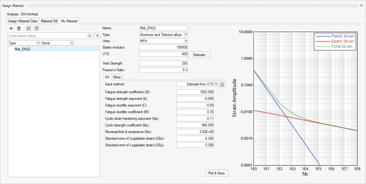

  3. Create a material from scratch.
    1. Click the My Material tab.
    2. Click to create a new material.
    3. Edit the name and any relevant properties.
      Note: Several input methods are available for fitting an SN curve based on the data provided.
    4. Click Plot & Save.
Note: Changing the units automatically updates the material properties and magnitudes accordingly.
Note: Refer to Fit a Curve by Estimating UTS and Other Methods for Fitting a Curve to define EN properties.
