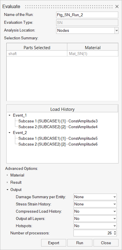

Use the Run Analysis tool to set up and launch the evaluation.
  1. From the Evaluate tool group, click the Run Analysis tool.
    The Evaluate dialog opens.
  2. Optional: Change the name of the run.
  3. For Analysis Location, select Elements/Nodes.
  4. Review the selected parts and loadcase.
  5. Optional: Under Advanced Options and Material, define the material options.
    • SN Curve Extrapolation can be set to True/False for Multiple SN curve interpolation.
    • Multiple Haigh Interpolation Method options are Mean Stress = Constant or Stress Ratio = Constant.
  6. Optional: Under Advanced Options and Result, you can calculate the safety factor for a specified amount of target cycles for SN uniaxial runs.
    1. Change the Safety Factor drop-down to Stress Ratio = Const / Mean Stress = Const / Scale.
    2. Enter a value for the target cycles.
  7. Optional: Under Advanced Options and Result, select the Scale Result.
    You can scale Life based on Equivalent Lie units or scale Damage based on Allowable Miner Sum.
  8. Optional: Under Advanced Options and Result, define the static failure options for SN.
    • Change to Continue or Stop for Static Failure options.
    • Retain No Check to avoid Static Failure check.
  9. Under Advanced Options and Result, define the static failure transition cycle.
    • Change to Stress or Life to control the Static failure transition cycle.
  10. Optional: Define Advanced Options for output.
    Supported only for Loading types: Time series, Transient, and Modal Superposition.
    • Damage Summary per Entity: EventwiseDamage.csv will be written to Run folder. The option is activated when either a set or CSV with Element/Node IDs are assigned. The IDs are identified based on Analysis Location.
    • Stress Strain History: Stress or Strain History based on Stress Life or Strain Life selected is output to the Run folder in RSP format. The option is activated when either a set or CSV with Element/Node IDs are assigned. The IDs are identified based on Analysis Location.
    • Compressed Load History: Compressed load history file per event is output to the Run folder in RSP format. The option is activated by Yes/No.
    • Output all Layers: Contour of fatigue results for all evaluated layers.
    • HotSpots: Output Hotspot clusters (sets) of Elements/Nodes (based on analysis location). On activation, the CSV sets will be written to run directory. The following options are to be assigned:
      1. Number of Hotspots: number of hotspot clusters to be detected.
      2. Threshold Ratio: percentage of the max element damage used to create the required cluster.
      3. Damage Limit: entities with damage less than the damage limit will not participate in Hotspot creation.
    Note: Hotspots are not supported for DangVan FOS and weld fatigue evaluation.
  11. Optional: Click Export to export a Batch Input File.
    See for more information on batch submission.
  12. Optional: For a faster solution time, change the number of processors used for the run (based on availability).

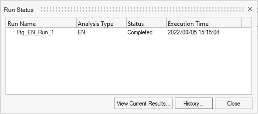

  13. Click Run.
    The Run Status dialog opens.
    Figure 3.
    Note: If you do not assign any time history to an event, you are prompted about the missing channel when you click Run.
