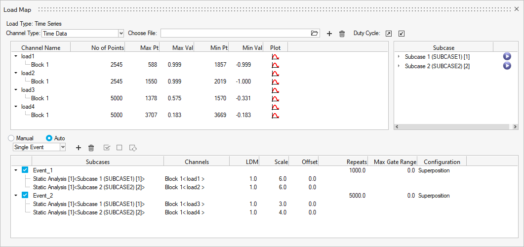

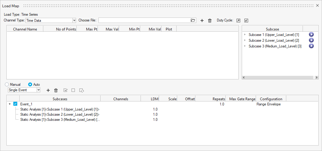

    When Auto and Single Event are selected, before you click ,
    1. Select a subcase and a load history channel, or
    2. Select multiple load histories and subcase pairs that have an equal number of time points.
    Only one event is created when you click .

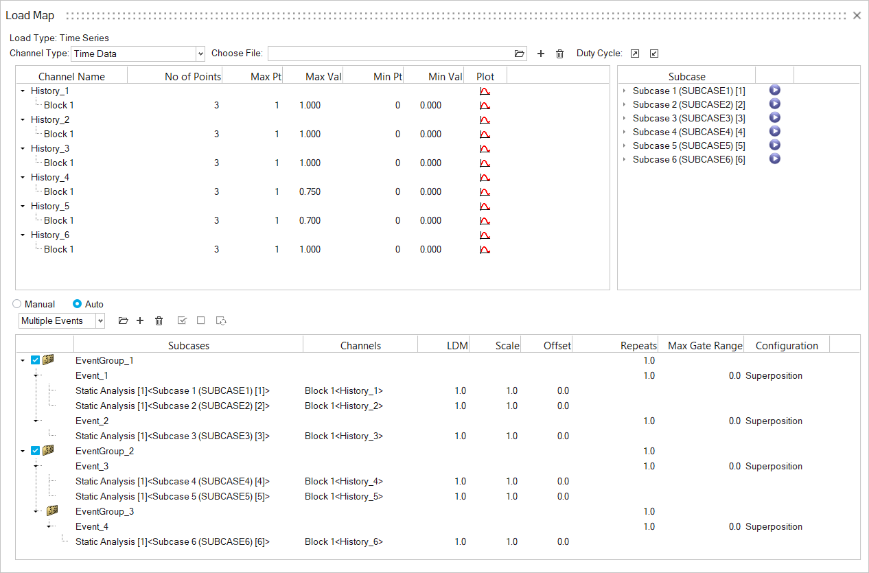

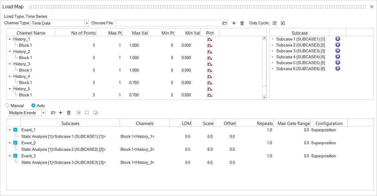

    When Auto and Multiple Events are selected, before you click ,
    1. Select multiple load histories and subcase pairs.
      The load histories must have an equal number of time points.
    2. Total number of events created = Number of channels selected / Number of subcases selected.
  3. Adjust the load magnitude, scale, offset, repeats, max gate range, and configuration of the events/subcases.
    Tip:
    • Apply the value of a parameter to all the events/subcases by right-clicking on a value and selecting Apply value to all events.
    • From the Subcase window, select any subcase increment.
  4. Activate the checkboxes of the events to be considered in the evaluation.
  5. Optional: Create Event Group .
    Events groups can be created to combine required event combinations. See Figure 6.
    1. Click on to create the Event Group and then use the event creation options to create events within the group.
      Event group should be highlighted before creating individual events within the group. Event groups can also be created within a group leading to nested event group combination as shown in Figure 6.
Figure 5.

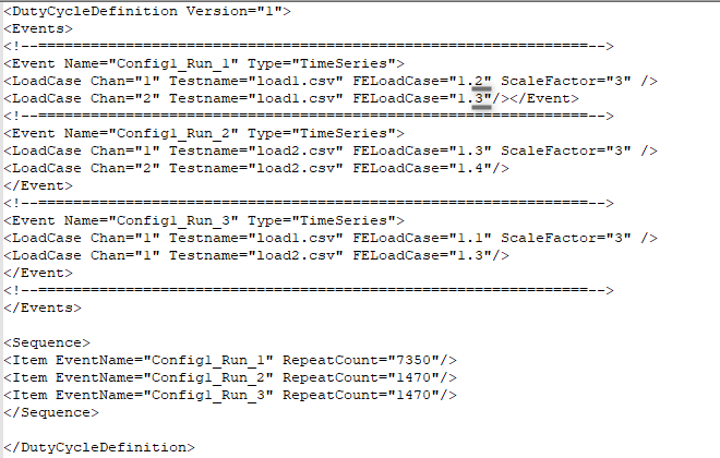

    Figure 10. Duty Cycle File Example

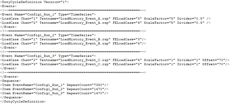

    The key words from the *.dcy file define the required duty cycle information, such as:
    • Channel number (Chan)
    • Load history file name with extension (Testname)
    • FE subcase ID in HyperLife (FELoadCase)

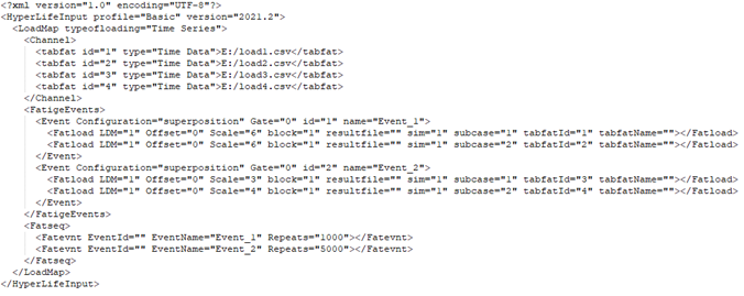

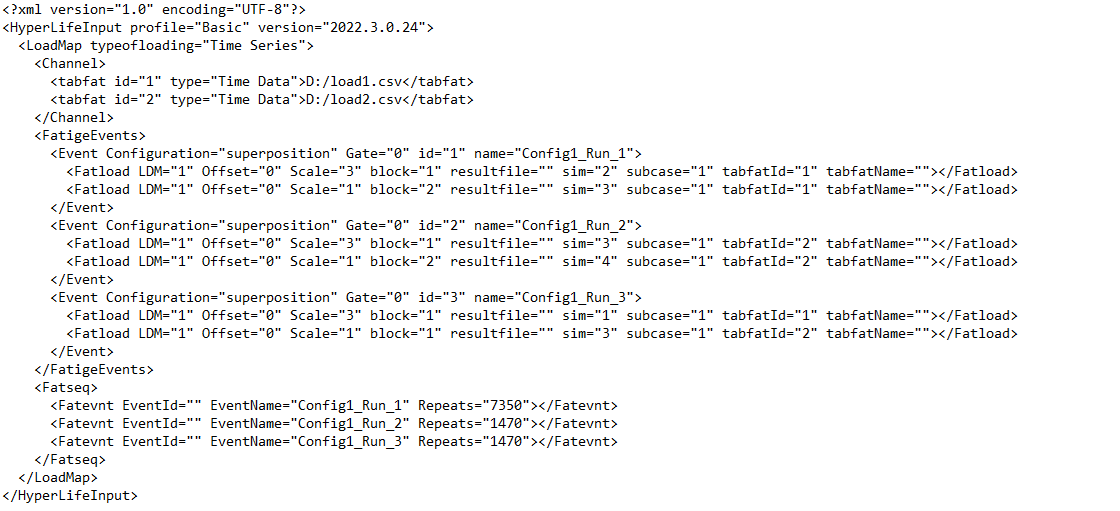

    Figure 15. Duty Cycle File Example
    The key words from the *.xml files define the required duty cycle information, such as:
    • Type of Load Type (typeofloading)
      <LoadMap typeofloading="Time Series">
    • Load History file name with extension
      <Channel>
              <tabfat id="1" type="Time Data">E:/load1.csv</tabfat>
      </Channel>
    • Event information
      <FatigeEvents>
              <Event Configuration="superposition" Gate="0" id="1" name="Event_1">
                  <Fatload LDM="1" Offset="0" Scale="6" block="1" resultfile="" sim="1" subcase="1" tabfatId="1" tabfatName=""></Fatload>
                  <Fatload LDM="1" Offset="0" Scale="6" block="1" resultfile="" sim="1" subcase="2" tabfatId="2" tabfatName=""></Fatload>
              </Event>
      </FatigeEvents>
    • Event sequence
      <Fatseq>
              <Fatevnt EventId="" EventName="Event_1" Repeats="1000"></Fatevnt>
              <Fatevnt EventId="" EventName="Event_2" Repeats="5000"></Fatevnt>
      </Fatseq>

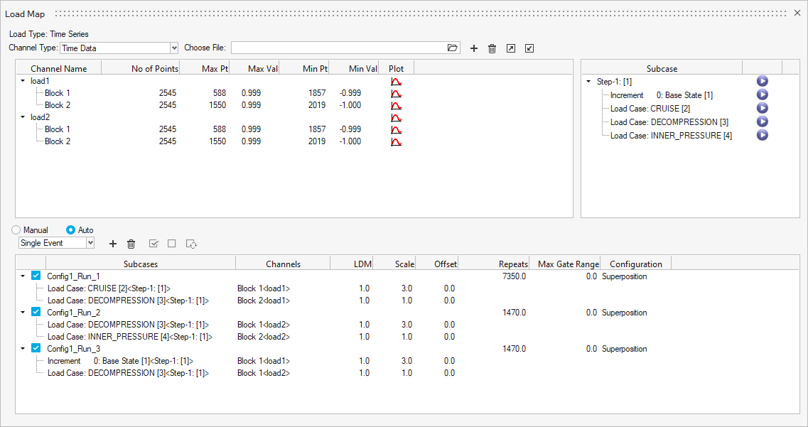

  4. Optional: Update any parameters as needed or disable an event to exclude it from the solution.
    Figure 16.
    Simulation list/increments within a FE subcase can be included in *.xml event pairing sim = Simulation.ID as shown in the example below.
    Figure 17.

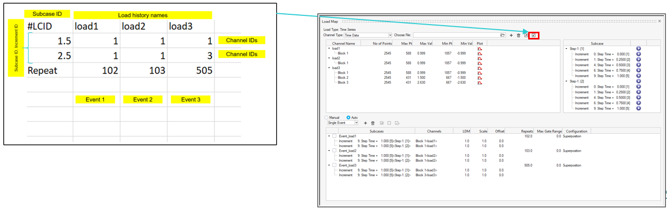

Event Mapper CSV
Event Mapper file is an alternative to Duty Cycle file for when the Channel mapping doesn’t specifically follow a uniform order for each of the FE loadcases.
The Channel IDs (Time series data) and FE loadcase IDs are pre-sorted to form Events in a *.csv format, which is imported on Load Map utility.
Figure 18.

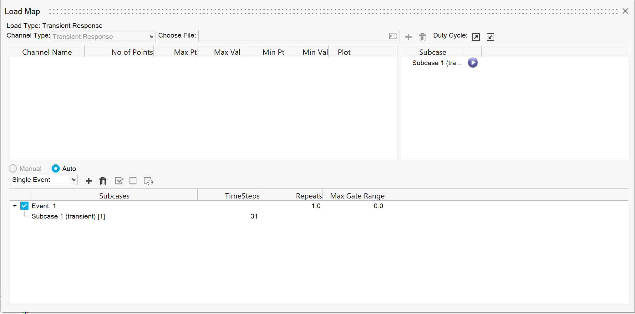

Create Transient Response Events
Transient subcases are supported for SN (uniaxial, multiaxial), EN (uniaxial, multiaxial), and FOS fatigue calculations with a Transient Response loading type.
  1. Click the Load Map tool.
    Figure 19.
    The Load Map dialog opens.
    By default, Transient Response is the selected Channel Type and can not be changed.
    Note: Plots or channels are not required.
  2. Select a subcase from the Subcase panel then click on the bottom half of the dialog to create an event.
    Stresses from each time step of the subcase are superimposed and damage is calculated on the superimposed stress.
    Note: You can only select one transient subcase per event.
  3. Optional: Edit the number of repeats.
    Tip: Apply a Repeats value to all the events by right-clicking on a value and selecting Apply value to all events.
  4. Apply Max Gate Range ( (0.0 ≤ Real < 1.0), to apply gate on the Stress History.
  5. Enable the checkboxes of the events to be considered in the evaluation.
Figure 20.

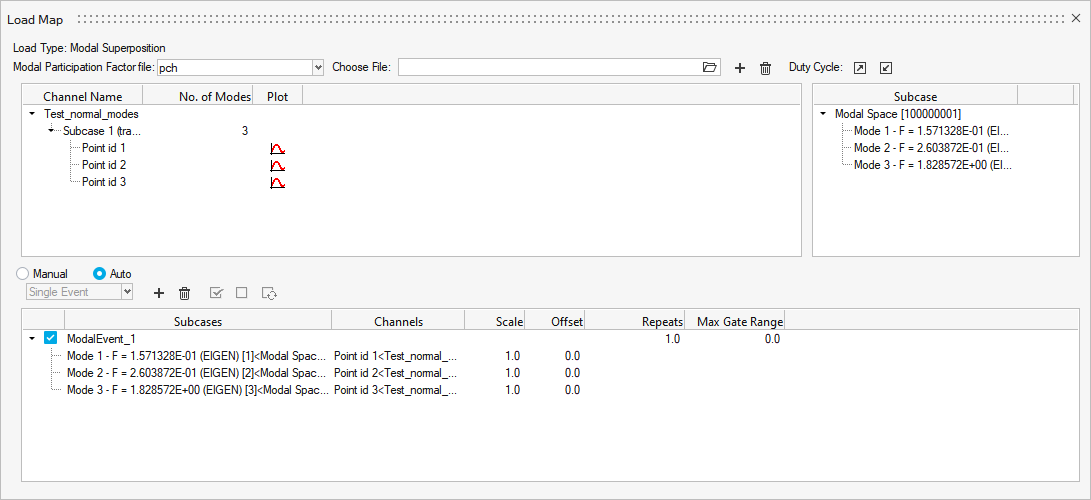

Create Modal Superposition Events
Modal subcases are supported for SN (uniaxial, multiaxial) and EN (uniaxial, multiaxial) fatigue calculations with a Modal Superposition loading type.
    Figure 21.
  2. Select the required modes from mrf/pch and the FE subcase.
  3. On the bottom half of the dialog, select Auto and click .
    A modal event is created.
  4. Optional: Edit the number of repeats.
  5. Apply Max Gate Range (0.0 ≤ Real < 1.0), to apply gate on the Stress History.
  6. Activate the checkboxes of the events to be considered in the evaluation.
Figure 22.
Stress history from modal participation factors and modal stresses is calculated as:
σ i j t = Σ k P k t ∗ S c a l e + O f f s e t ∗ σ i j , k MathType@MTEF@5@5@+= feaahqart1ev3aaatCvAUfeBSjuyZL2yd9gzLbvyNv2CaerbuLwBLn hiov2DGi1BTfMBaeXatLxBI9gBaerbd9wDYLwzYbItLDharqqtubsr 4rNCHbGeaGqiVu0Je9sqqrpepC0xbbL8F4rqqrFfpeea0xe9Lq=Jc9 vqaqpepm0xbba9pwe9Q8fs0=yqaqpepae9pg0FirpepeKkFr0xfr=x fr=xb9adbaqaaeGaciGaaiaabeqaamaabaabaaGcbaGaeq4Wdm3aaS baaSqaaiaadMgacaWGQbaabeaakmaabmaabaGaamiDaaGaayjkaiaa wMcaaiabg2da9iabfo6atnaaBaaaleaacaWGRbaabeaakmaabmaaba GaamiuamaaBaaaleaacaWGRbaabeaakmaabmaabaGaamiDaaGaayjk aiaawMcaaiabgEHiQiaadofacaWGJbGaamyyaiaadYgacaWGLbGaey 4kaSIaam4taiaadAgacaWGMbGaam4CaiaadwgacaWG0baacaGLOaGa ayzkaaGaey4fIOIaeq4Wdm3aaSbaaSqaaiaadMgacaWGQbGaaiilai aadUgaaeqaaaaa@5833@

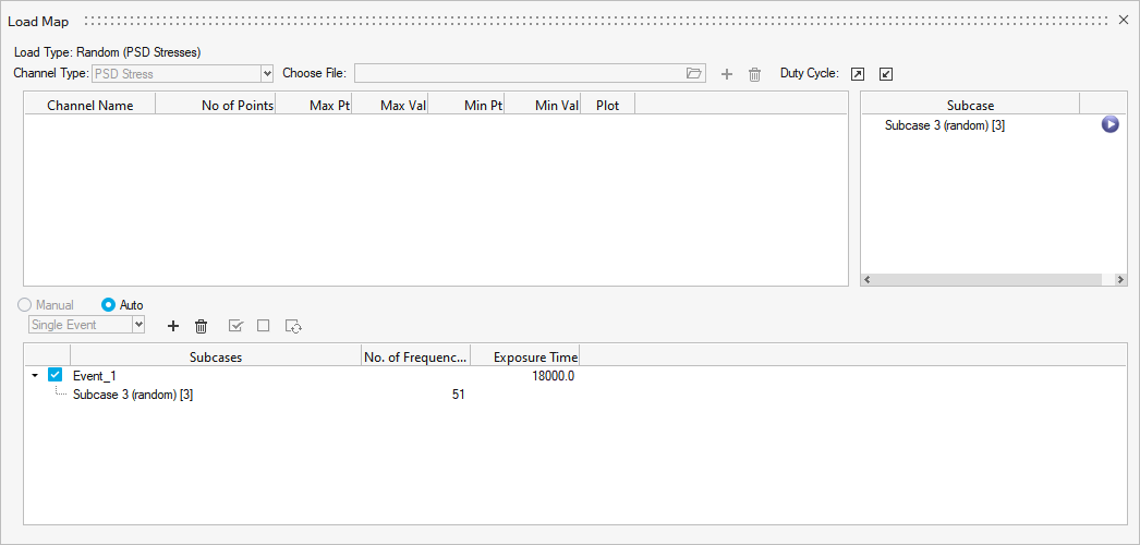

Create Random (PSD Stresses) Events
Random Response subcases are supported for SN (uniaxial) and EN (uniaxial) fatigue calculations with a Random (PSD Stresses) loading type.
    Figure 23.
    By default, PSD Stresses is the selected Channel Type and can not be changed.
    The Subcase panel lists random response FE subcases. FE static subcases are listed if mean stress correction is required.
    Note: You can only select one random subcase per event.
  3. Optional: Drag-and-drop one static subcase onto an event if mean stress correction is to be introduced.
  4. Optional: Edit the Exposure Time value.
    Tip: Apply an Exposure Time value to all the events by right-clicking on a value and selecting Apply value to all events.
Figure 24.

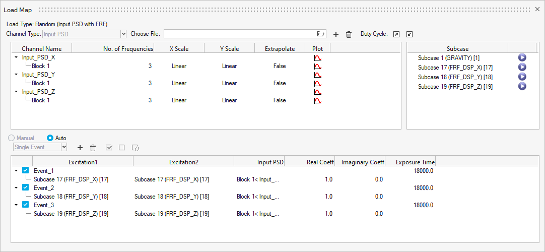

Create Random (Input PSD with FRF) Events
Frequency Response Analysis subcases are supported for SN (uniaxial) and EN (uniaxial) fatigue calculations with a Random (Input PSD with FRF) loading type.
Note: Default format on import of Input PSD is LINEAR - LINEAR (that is, linear interpolation for the x-axis and linear interpolation for the y-axis). X Scale and Y Scale is to be changed to the required format. For example: LOGARITHMIC - LOGARITHMIC.
    Figure 25.
  2. Select subcases.
  3. On the bottom half of the dialog, click to create an event.
    The possible correlations (Excitation1 and Excitation2) of the selected FRF subcases are listed under the event.
  4. Drag-and-drop the imported channels onto the Input PSD field of each correlation.
    The Input PSDs are used to scale the complex stresses. Input PSD of frequency vs scale in CSV format are supported.
  5. Scale the complex stresses using the Input PSD and the Real and Imaginary coefficients from each event.
  6. Optional: Edit the Exposure Time value.
  7. Enable the checkboxes of the events to be considered in the evaluation.
    Figure 26.

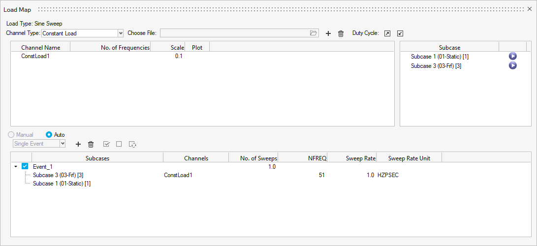

Create Sine Sweep Events
Frequency Response Function subcases are supported for SN (uniaxial) and EN (uniaxial) fatigue calculations with a Sine Sweep loading type.
    Figure 27.
  2. Select both an FRF subcase and an imported channel.
  4. Edit the number of sweeps, the number of frequencies (NFREQ), the sweep rate, and the sweep rate unit.
    Tip: Apply the value of a parameter to all the events/subcases by right-clicking on a value and selecting Apply value to all events.
    Figure 28.
Note: If Mean Stress correction is to be applied, a static subcase, if present in the result file, will be listed in the Subcase window and can be drag and dropped onto the event (no channel is required to be paired).
