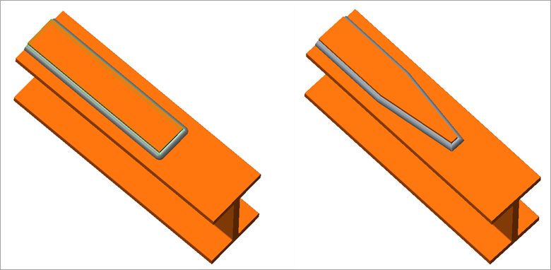

  • Weld design-based stress concentration:
    The second stress concentration comes from the joint design. Stress concentrations arise whenever there is a change in stiffness in the structure. It can result from either an increase of decrease in stiffness. For example, a hole in a plate will have about the same stress concentration as a rigid boss added to the plate. Here are some examples of weld joints contrasting good and poor design practice.
    First you need to consider a cover plate welded to a bending beam. A large stress concentration exists at the end of the cover plate because of the large change in stiffness. A better design is shown on the right side where there is a more gradual change in stiffness.
    Figure 3. (a) Incorrect Weld Design; (b) Correct Weld Design: Gradual Stiffness Gradient

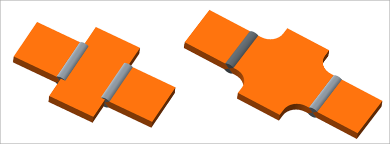

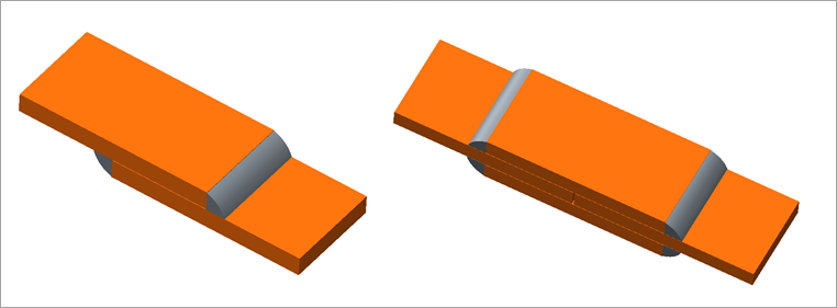

    A second source of stress concentration is unintentional bending stresses caused by asymmetric geometries. The design on the left will have larger bending stresses than the double lap joint on the right side.
    Figure 4. (a) Incorrect Weld Design; (b) Correct Weld Design: Double Lap Joint Symmetric Geometry
    Welding plates of differing thicknesses or widths is always problematic. Just as above, the easiest geometry to weld has the largest stress concentration. You should always consider moving the welds to lower stress areas in the structure and have a gradual transition in stiffness such as the joint shown Figure 5(b).
    Figure 5. (a) Incorrect Weld Design; (b) Correct Weld Design: Gradual Stiffness Transition

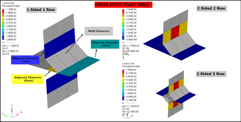

Cross-joint
For a cross-joint, all weld elements associated with one cross joint weld should be specified in a single part/set, otherwise HyperLife will treat the cross-joint fillet weld as separate multiple welds and may output unexpected results. Additional requirement for a cross-joint is that the joint should be symmetric.
  • One-sided One Row
    For a One-sided One Row Cross-joint, the weld element normal direction should point towards the corresponding weld toe.
    Figure 11. Representation of a One-sided Cross-Joint Fillet Weld with One Row of CQUAD4 Elements Each
  • One-sided Two Row
    Multiple rows are recommended for welds where the weld penetration is high and the weld typically forms the basis for contact between the two plates. Such welds are more rigid compared to welds where the penetration is lower, thereby additional rows of weld shell elements are required to capture the behavior. In Figure 12, the welds have penetrated more than the welds in Figure 11. For a One-sided Two Row Cross-joint, the weld element normal direction should point towards the corresponding weld toe. The vertical weld element normals should also point towards the corresponding weld toe.
    Figure 12. Representation of a One-sided Cross-Joint Fillet Weld with Two rows of CQUAD4 Elements Each
  • Two-sided Two Row
    For a Two-sided Two Row Cross-Joint, the weld element normal direction should point towards the corresponding weld toe.
    Figure 13. Representation of a Two-sided Cross-Joint Fillet Weld with Two Rows of CQUAD4 Elements Each
  • Two-sided Three Row
    Multiple rows are recommended for welds where the weld penetration is high and the weld typically forms the basis for contact between the two plates. Such welds are more rigid compared to welds where the penetration is lower, thereby additional rows of weld shell elements are required to capture the behavior. In Figure 14, the welds have penetrated more than the welds in Figure 12.
    For a Two-sided Three Row Cross-Joint, the weld element normal direction should point towards the corresponding weld toe. The normals of the vertical weld elements can point towards either weld toe on each side.
    Figure 14. Representation of a Two-sided Cross-Joint Fillet Weld with Three Rows of CQUAD4 Elements Each

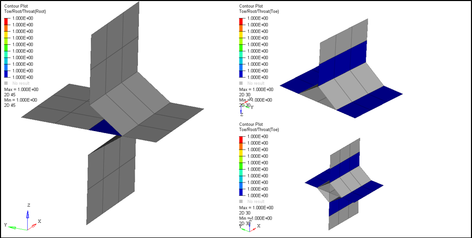

Fillet
The weld toe and root locations are evaluated. Throat location is not evaluated.
Note: The arrows in Figure 21 and Figure 22 indicate surfaces for evaluation (surface of the shell elements adjacent to the weld element).
Figure 21. Failure Locations for One Row Fillet
Figure 22. Failure Locations for Two Row Fillet

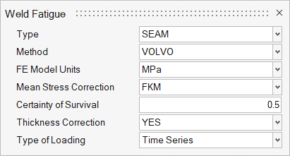

Fatigue Properties
There are a few fatigue properties relevant to Seam Weld Fatigue Analysis that allow you to control the fatigue behavior.
Bending Ratio
Experiments show that two types of SN curves are required to perform Seam Weld Fatigue Analysis based on a method suggested by M. Fermér, M Andréasson, and B Frodin. Based on lab tests, two SN curves were plotted (Figure 29). The upper curve is obtained in tests where the maximum stress is dominated by Bending Moment ( m 2 Y ) and the lower curve is obtained from tests where membrane force ( f 2 X ) dominates the maximum stress.
Figure 29. Example Stress Amplitude versus Fatigue Life log(N) for Bending dominated versus Membrane Dominated Structure
The upper and lower curves are referred to as Bending SN curve and Membrane SN curve, respectively. It is recommended that membrane SN curve should be used when membrane stress dominates in an element, and bending SN curve should be used when bending stress dominates. Interpolation between the two curves may be carried out depending on the degree of bending dominance.
Degree of bending dominance can be determined by the average bending ratio ( r B A V G ). First, the bending ratio ( r ) is defined as:

To activate Seam Weld Fatigue Analysis, the Welds icon from the Fatigue Modules should be selected.
Figure 31.
Fatigue Elements
Currently, shell elements (preferably CQUAD4) are supported for the seam weld calculations
Fatigue Parameters
The Method, FE Model Units, Mean Stress Correction, Certainty of Survival, and Thickness Correction are defined though the Seam Weld Fatigue dialog.
For more information on FKM mean stress correction, see the FKM section under Uniaxial S-N Fatigue.
Figure 32.
