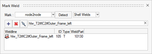

  2. Enter hlw_T2#IC2#Outer_Frame_left in the search text box and press Enter.
    Figure 7.

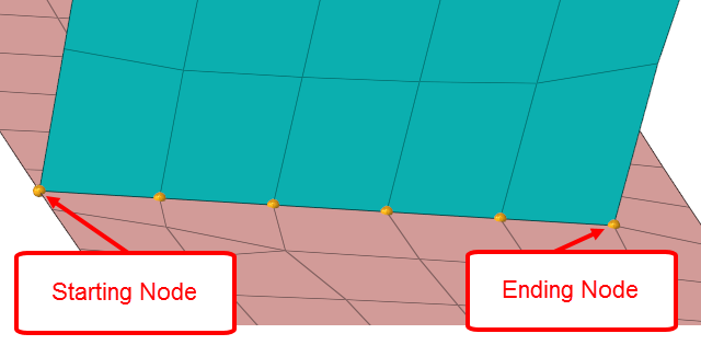

  6. In the Mark Weld dialog, click .
    An entity selector appears.
  7. Select the starting and ending nodes of the weld path as shown in the image below.
    Figure 9.
    The nodes in between the starting and ending nodes should be selected automatically.

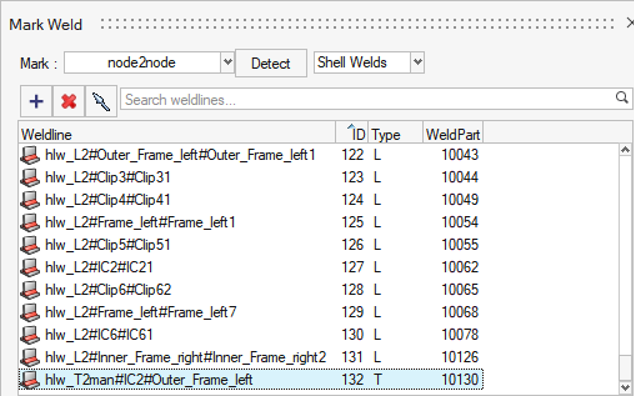

  8. Click OK in the Advanced Selection dialog then click on the entity selector.
    The newly created weld line is displayed in the Mark Weld dialog.
    Figure 10.
    The weld line is also added to the WeldLines folder in the HyperLife Model Browser.

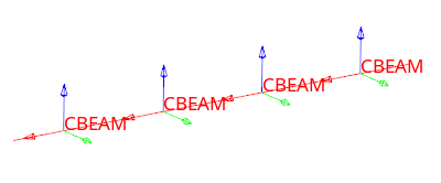

  1. In the Mark Weld dialog, right-click on the first weld line, hlw_T2#Frame_left1#Frame_left7, and select Isolate > Weld + Comp.
    This lets you visualize the weld line and the two connected components in the modeling window.

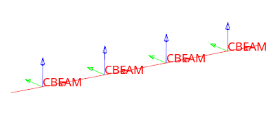

  2. Right-click again on the same weld line and select Isolate > Weld + Systems.
    The systems of the individual segments that make up the weld line are isolated.
    Figure 11.
  3. Again, right-click on hlw_T2#Frame_left1#Frame_left7 then select Rotate Y > All.
  4. The direction of the weld line segments are rotated, but the change is not immediately apparent. In order to see the rotation, right-click on the weld line name once more and select Isolate > Weld + Systems.
    Figure 12.

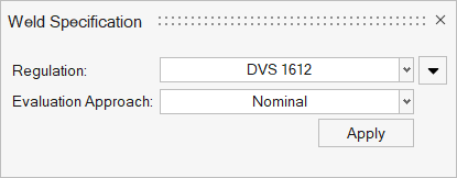

  2. Select DVS 1612 from the Regulation drop-down menu.
    Figure 18.
  3. Click Apply.
    Parameters are applied to all the weld line evaluation points.

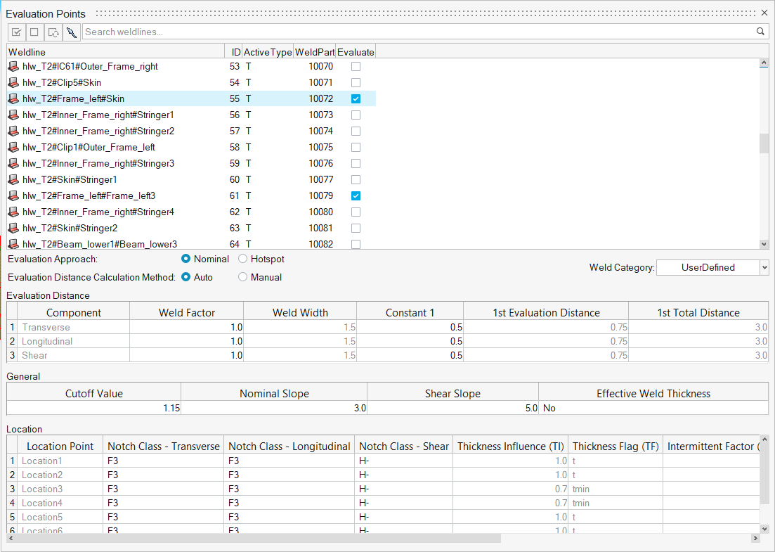

  1. Click the Points tool.
    Figure 19.
    The Evaluation Points dialog opens.
  2. Select hlw_T2#Frame_left#Skin from the weld line list.
    Note: The Evaluate checkbox should be activated. Any weld lines that are marked as critical in the screening process are automatically selected in the Evaluation Points dialog.
  3. Review the classification parameters.
    The classification parameters for each weld vary depending on the weld type and the weld regulation selected.
    Figure 20.
  4. Review other weld lines at your own discretion then exit the dialog.

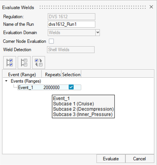

  1. From the Evaluate tool group, click the Run Analysis tool.
    Figure 21.
    By default, an event with all subcases is created. The created event will compare the subcases placed within an event to create the maximum range.
    The Evaluate Welds dialog opens.
  2. Optional: Enter a name for the run.
  3. Optional: Edit the default event or create a new subcase through the LoadMap context.
    Figure 22.
  4. Click Evaluate.
    A summary of the run appears.
  5. Click OK to close the dialog.

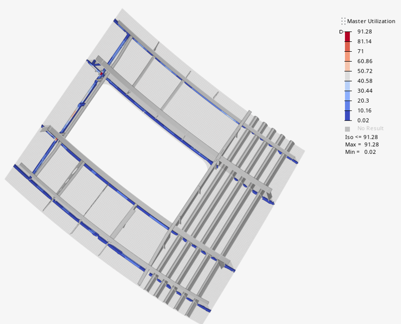

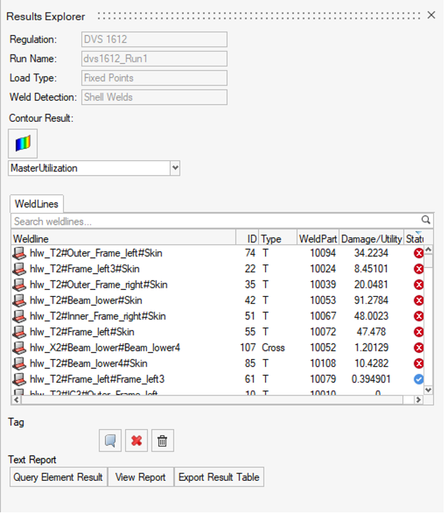

    The Results Explorer opens and the model is contoured.
    Figure 23.

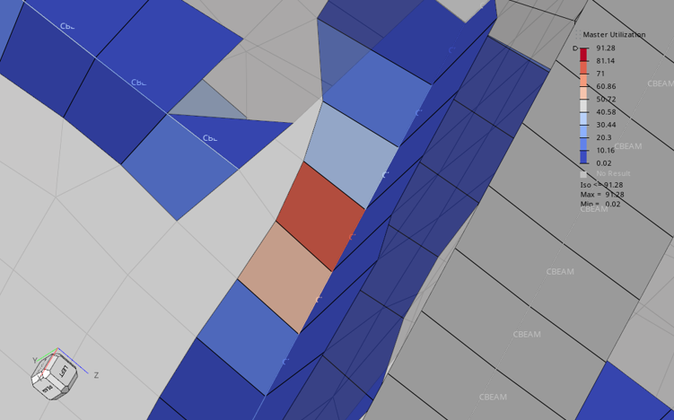

  6. In the Results Explorer, select Location_4 from the first drop-down menu and Max_Utilization from the second drop-down menu, then click .
    Figure 24.

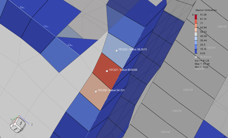

  7. Zoom in on the model to view areas of interest.
    Figure 25.
  8. Add tags to elements.
    1. Under the Tag field of the Results Explorer, click .
    2. Select elements to tag.
    3. Click on the entity selector.
      The selected elements are tagged with IDs and utilization values.
