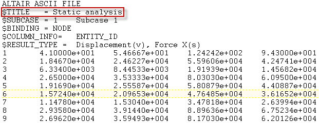

Static Analysis

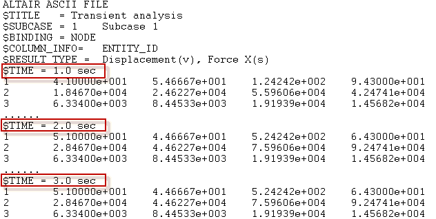

Transient Analysis

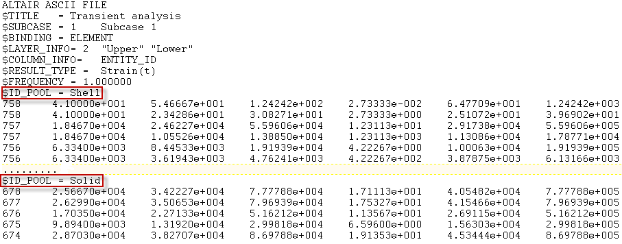

Element Results with Layers and ID Pool
Figure 4.

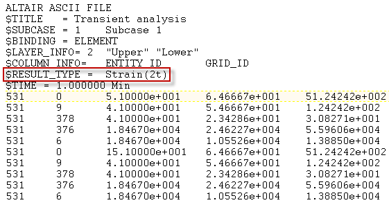

2D Tensor Result with Corner Data
Figure 5.

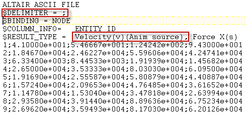

Delimiter and Animation Source
Figure 7.

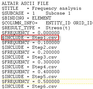

Include File
Figure 8.
