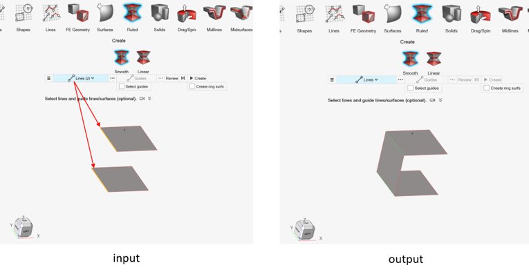

Creation Rules Applied in Tools and Workflows
  1. For CAD geometry inputs, expected output is CAD geometry.
    Ruled surface creation from two CAD edges gives CAD geometry surface.

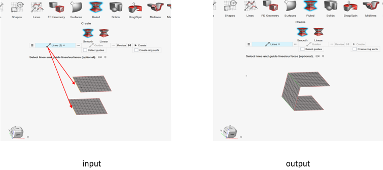

  2. For FE geometry inputs, expected output is FE geometry.
    Ruled surface creation from two FE geometry edges gives FE geometry surface.

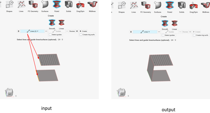

  3. For mixed inputs (CAD geometry + FE geometry), the expected output is defined by the HyperMesh > Geometry > Geometry Creation: Create mode option in Preferences.
    The same is true for the following:
    • Ruled surface creation from mixed selection (CAD edge and FE geometry edge)
    • Connectivity within or across component
    • Orphan nodes locations
    • Structural nodes (not associated) selection
    CAD edge/CAD line selection results in CAD surface.
    FE edge/FE line selection results in FE surface.

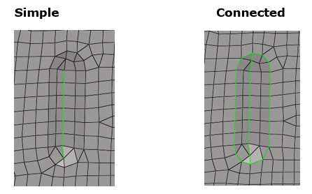

    Simple - Fast method of identifying features based solely on the angle between normals of adjacent elements. Based on this, the surface is created.
    Connected - Seeks to avoid any "orphan" or non-closed feature lines. It includes a more rigorous check to combine small areas and avoid creating features that end abruptly or do not connect to any other features while creating surfaces. Example shown below:
    Figure 5.
