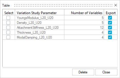

  23. From the SnRPre ribbon, select the Review Variations tool.
    Figure 4.
    A table opens containing all the variations and the related parameters.
    Figure 5.

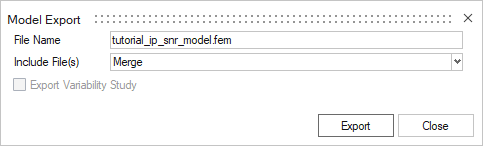

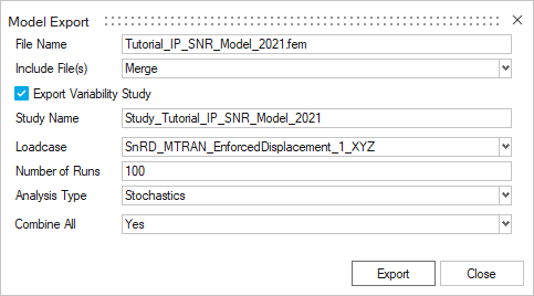

    The Model Export dialog opens.
    Figure 7.
  2. In the Model Export dialog, select the Export Variability Study check box.
    The Variability Study properties are displayed.
    Figure 8.
  3. Accept the default options and click Export.
    A folder selection dialog opens.
    Tip: You can modify any properties in the dialog.
  4. Browse and select the required folder.
    The OptiStruct solver deck, along with the XML and TPL files are exported to the selected folder.
  5. Click Close to close the model export option.

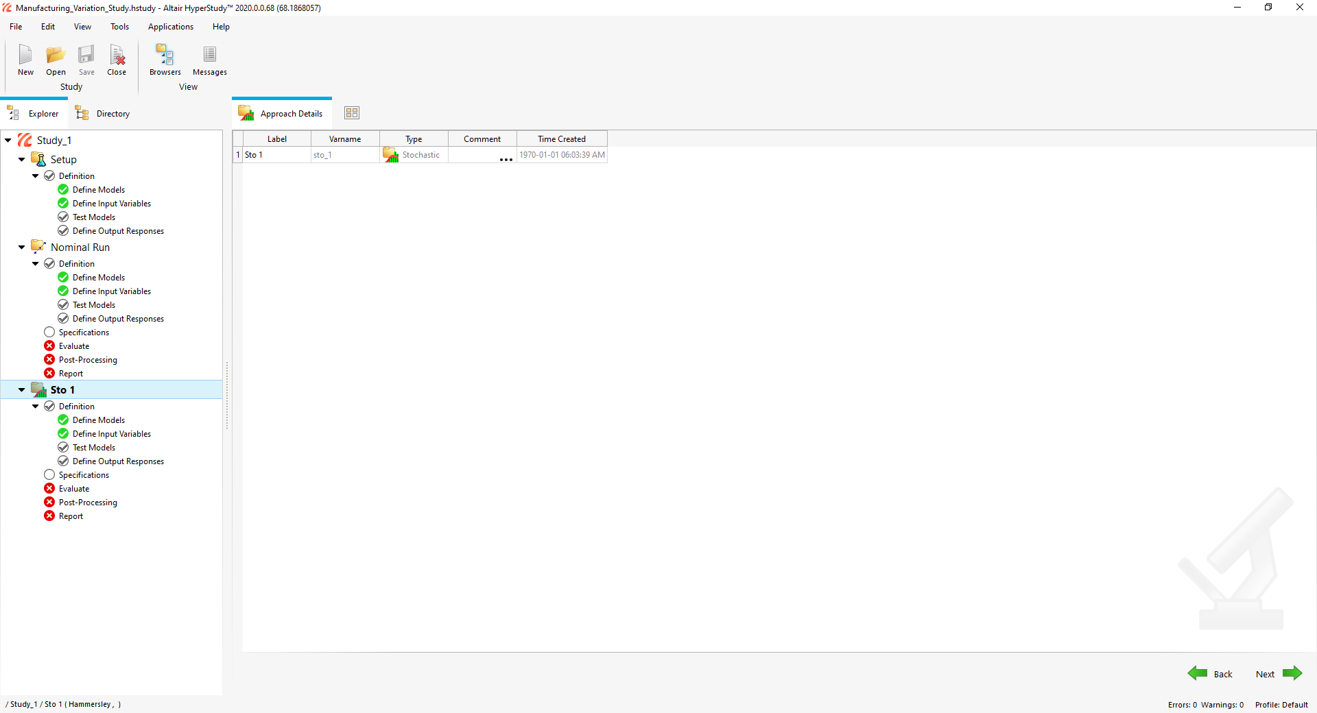

  1. Launch HyperStudy2025.1.
  2. Click Open.
    A file browser option will be displayed. Browse and select tutorial XML file. Once the XML file is loaded, a session tree will populate in HyperStudy and the process will start from the Sto 1 node.
    Figure 9.
    Note: Green checkboxes signify that the respective data is available. Any Yellow, Red, or empty boxes mean inputs are required.

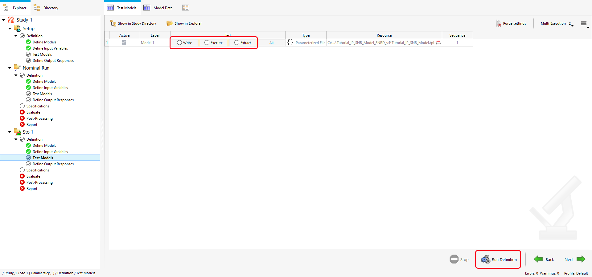

  3. Click Next to proceed to the Sto 1 > Definition > Test Models task.
    Note: You can skip Define Models and Define Input Variables tasks since they are pre-defined.
    Figure 10.
  4. In the Test column, click All.
  5. Click to proceed to Define Output Responses and click Evaluate.

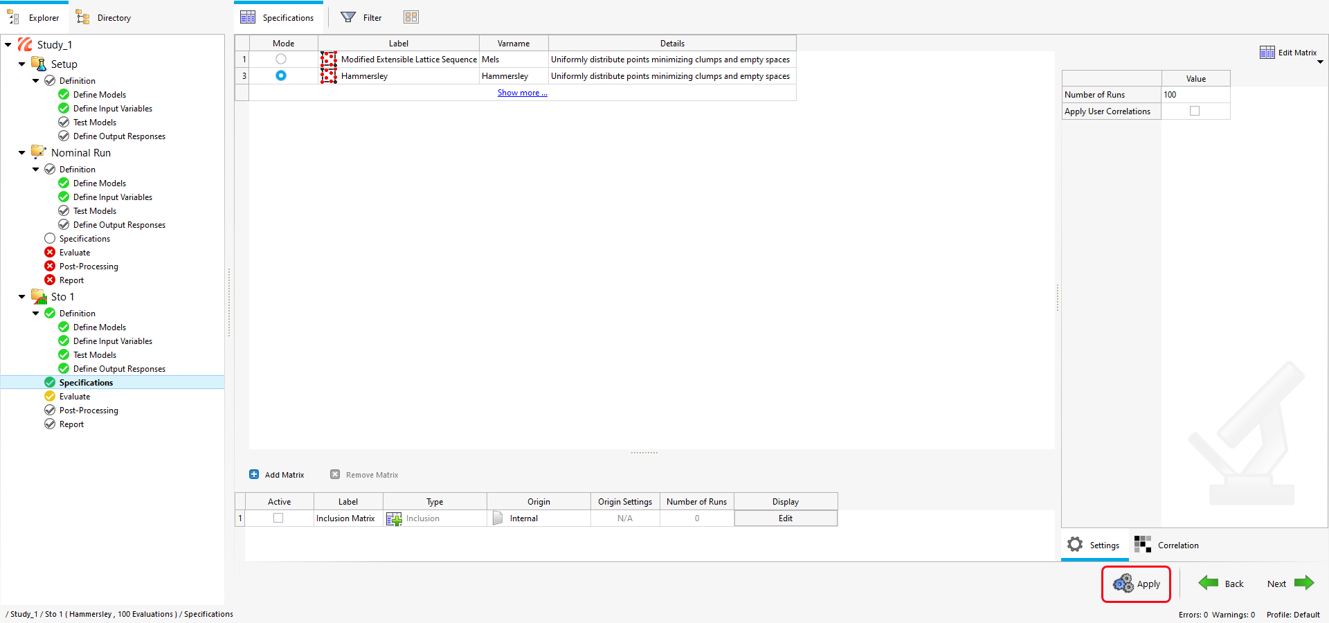

  6. Click to proceed to Specifications and click Apply.
    Figure 11.

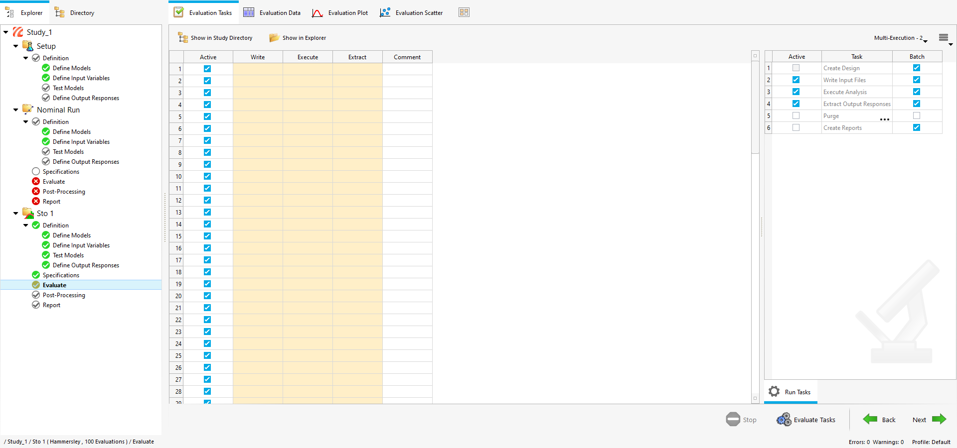

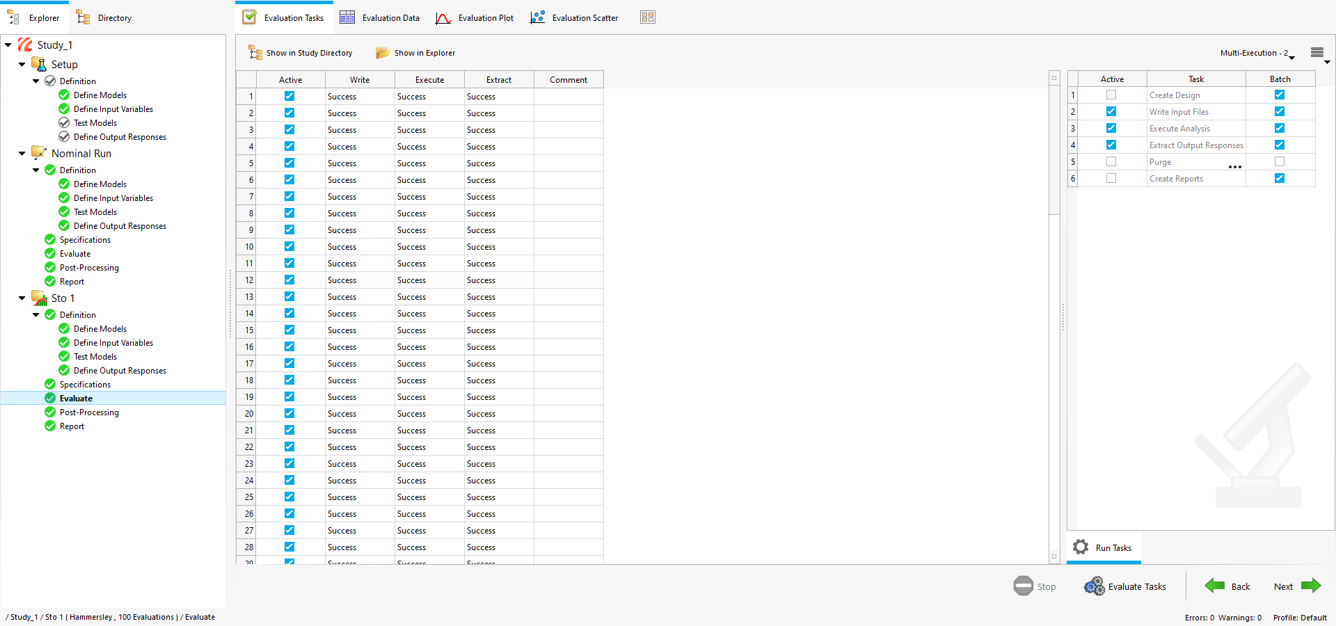

  7. Click to proceed to Evaluate and click Evaluate to run the stochastics variations.
    Figure 12.
    Note: Evaluation tasks will take considerable amount time to complete. Do not interfere with HyperStudy when the process is running.
    Figure 13.
    Once the evaluation is completed, remaining tasks, Post-processing and Report, turn green.

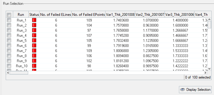

  11. Click Apply Filters.
    All the runs in the Run Selection table are filtered.
    Figure 15.

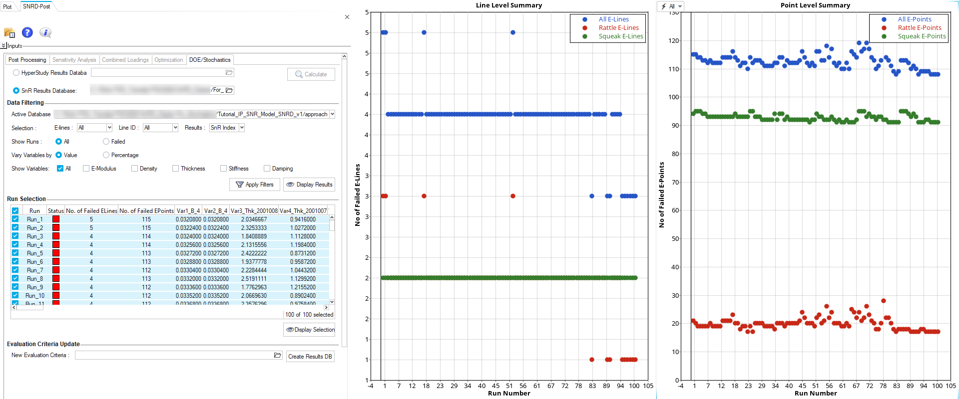

  12. Click Display Results.
    The results for the all the filtered runs are plotted.
    Tip: You can select the required runs from the Run Selection table.
  13. Click Display Selection.
    The results for the selected runs are plotted.
    Figure 16.
