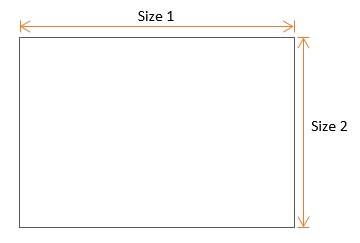

Rectangular
Figure 8.

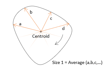

General
Figure 9.
