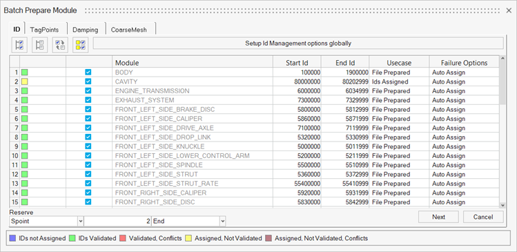

ID Tab
The ID tab provides options for you to define how to execute the ID management task for the selected modules. The column to the left indicates the current validation state of the corresponding module, and presents a checkbox that allows you to select to include the module in the batch ID management process.
Also in the dialog are the Module, Start Id and End Id columns, along with two ID management columns, Usecase and Failure Options.
The following use cases are available:
File Prepared
Nothing will be done for the module.
IDs Assigned
The assigned IDs will be used to organize entities in each module.
IDs Not Assigned
The next available block of IDs based on each module size will be automatically assigned to the module. All entities within the module are then renumbered into the assigned range.
Two options are available for dealing with failure situations in executing the IDs assigned use case, such as IDs that are not actually available, IDs are available but are in conflict with those assigned to another module, or assigned IDs are insufficient to contain all entities.
Auto Assign
The next available block of IDs are assigned to the failed module, same as if the IDs Not Assigned use case has been selected.
Skip Module
The module will be skipped, and the batch preparation process moves on to the next module.
A global reserve setting is available to reserve additional IDs for spoint or other purposes.

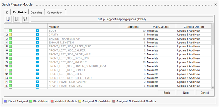

TagPoints Tab
The TagPoints tab provides options for you to define how to execute the tagpoint validation task for the selected modules. The left column indicates the current validation state of the corresponding module, and presents a checkbox that allows you to select to include the module in the batch tagpoint validation process.
Also in the dialog are the Module and Tagpoints columns, along with two tagpoint validation columns: Main/Source and Conflict Option.
There are three options available in the Main/Source column:
Metadata
The assembly tagpoint metadata is used as the main.
10th Field
The 10th field comment of grid cards are used as the main.
HM Tags
Altair HyperMesh tag entities are used as the main.
There are also options available for reconciling potential conflicts in tagpoint data between assembly metadata and information in the module include file:
Update & Add New
Update existing tagpoints in metadata and add new ones based on information from the include file.
Update
Update existing tagpoints in metadata based on information from the include file.
Do Nothing

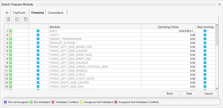

Damping Tab
Figure 3.
The Damping tab provides options for you to define damping to modules. The specified damping value will be used as global if the representation file does not have material damping or if the option for Skip existing is turned off. If the option Skip existing is turned on, the material damping value in the representation file will be used and the specified damping value will not be used.

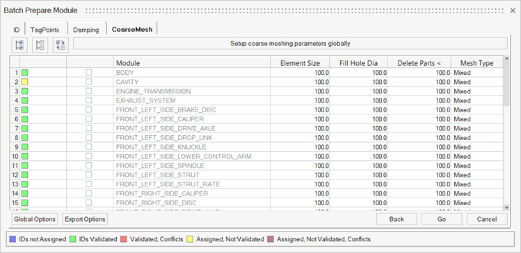

CoarseMesh Tab
Figure 4.
The CoarseMesh tab provides options for you to define parameters used to execute the coarse display mesh creation task for the selected modules. The left column indicates the current validation state of the corresponding module, and presents a checkbox that allows you to include the module in the batch coarse display mesh creation process. The tab also contains Element Size, Fill hole dia, Delete Parts< and Mesh Type columns where you can specify parameters specific to each module, if needed.
  1. Click Global Options to specify additional meshing options that are used for all modules.
  2. Click Export Options to specify additional file export options that are used for all modules.
