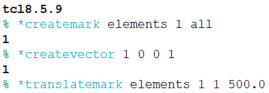

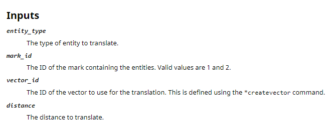

Translating elements via *translatemark command in Tcl requires providing four inputs - the entity type and mark ID (i.e. the input entity selection), the direction vector (provided via *createvector command) and the distance (e.g. 500.0).
*translatemark entity_type mark_id vector_id distance
Figure 1. List of inputs for Tcl command *translatemark.
Figure 2. Code snippet from the Tcl console showing the usage of *translatemark command.

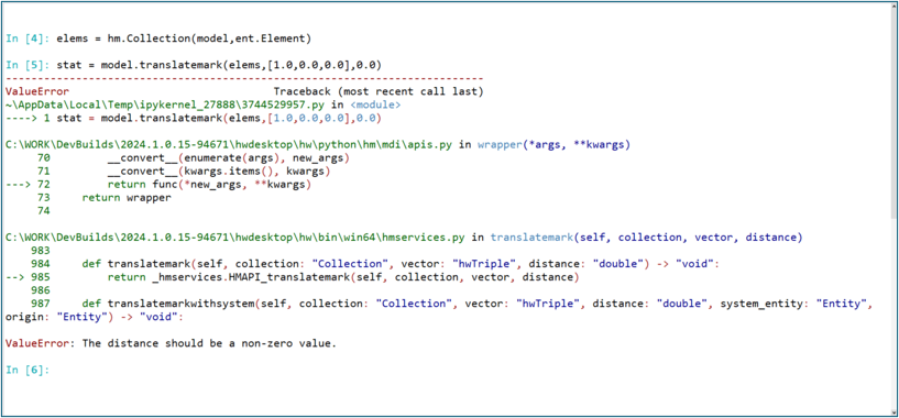

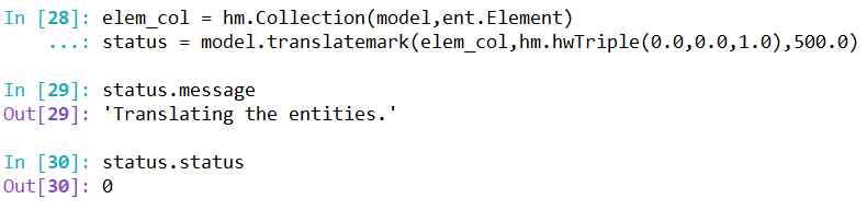

All HyperMesh functions return a status object. Most of the query functions also return a result object which is covered in the next section. The status objects let you review the message returned by the function and the status returned by the core function.
Status value 0 indicates successful execution. If the function fails, a Python error is triggered.
Figure 3. Python Window showing the usage of status object.
Figure 4. Python Window showing the error triggered by incorrect argument definition.

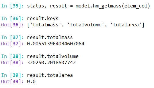

The name of query functions always starts with “hm_”. Their characteristic is that most of them, beside returning a status object, return also a result object that carries the queried information. There are two types of result objects/classes - HmQueryResult and HmQueryResultList.
HmQueryResult is a HyperMesh data type that by default has the attribute
keys which returns a list of all attributes that carry the information
returned by the function. Below is an example of hm_getmass()
function
that returns the total mass, total volume, and total area.
Figure 5. Python Window showing the usage of query result object.

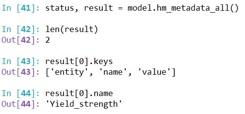

HmQueryResultList represents a list of HmQueryResult objects. A
HmQueryResultList object can be returned directly by a function, or in
case of more complex query functions it can be returned by one of the
HmQueryResult attributes. Below example shows a HmQueryResultList object
returned by hm_metadata_all()
function. User can check the length of the
object using Python’s len()
, grab individual HmQueryResult objects and
query their content.
Figure 6. Python Window showing the usage of status object.
