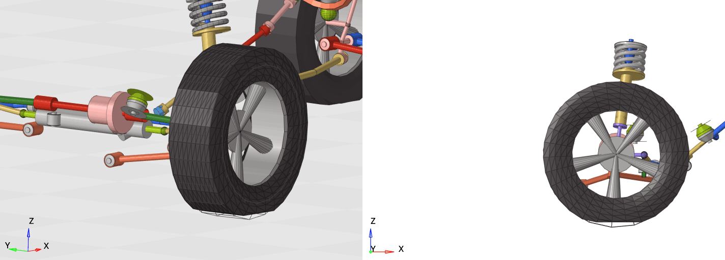

Visualization of Tire Deformation for Altair Fiala and Siemens Simcenter MF-Tyre/MF-Swift
The Vehicle Tools Extension now includes the option to visualize tire deformations for Altair Fiala and Simcenter MF-Tyre/MF-Swift. You can turn on the toggle to view the tire deformations in a HyperView animation. These deformations enhance the visual appeal of the animations and provide an approximate estimate of contact patch sizes.

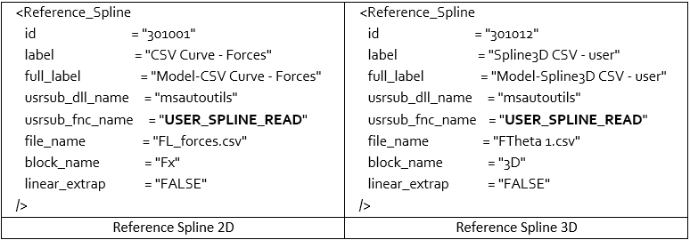

User Spline Support for CSV/RPC/DAC Input Formats
In MotionSolve, an in-built subroutine is now available and can be used to read CSV, RPC/RSP, and DAC formats. This is implemented as a SPLINE_READ user-subroutine and is used to create a Reference_Spline element in the XML/Python solver deck. You can use this subroutine to read 2D and/or 3D spline data into your MotionSolve models. For 3D splines, only CSV formats are supported.

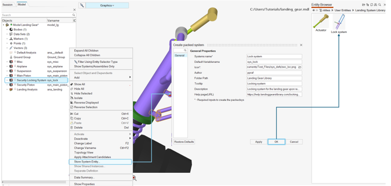

Save System Definition to the Entity Browser (MotionView)
MotionView's Entity Browser contains a list of entities that can be added to the model. It is now possible to save systems to the Entity Browser for quick retrieval and reuse.
Figure 3.
Select a system in the Model Browser, right-click, and select Store System Entity.... In the subsequent dialog, fill in system details, an icon image, and click OK.
  • The system is listed under the User Entities folder.
  • Provide a folder path to organize the stored systems.
  • Double click on the stored system to insert it into the active model.

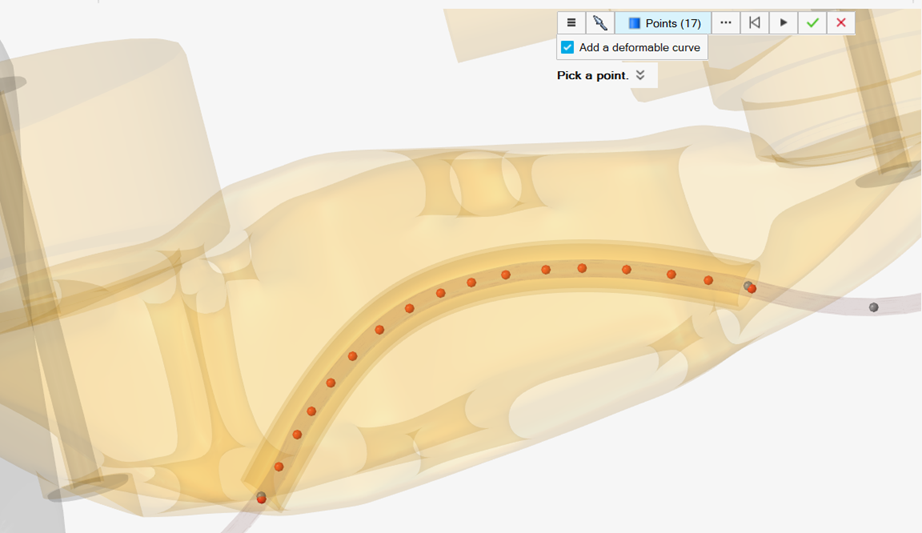

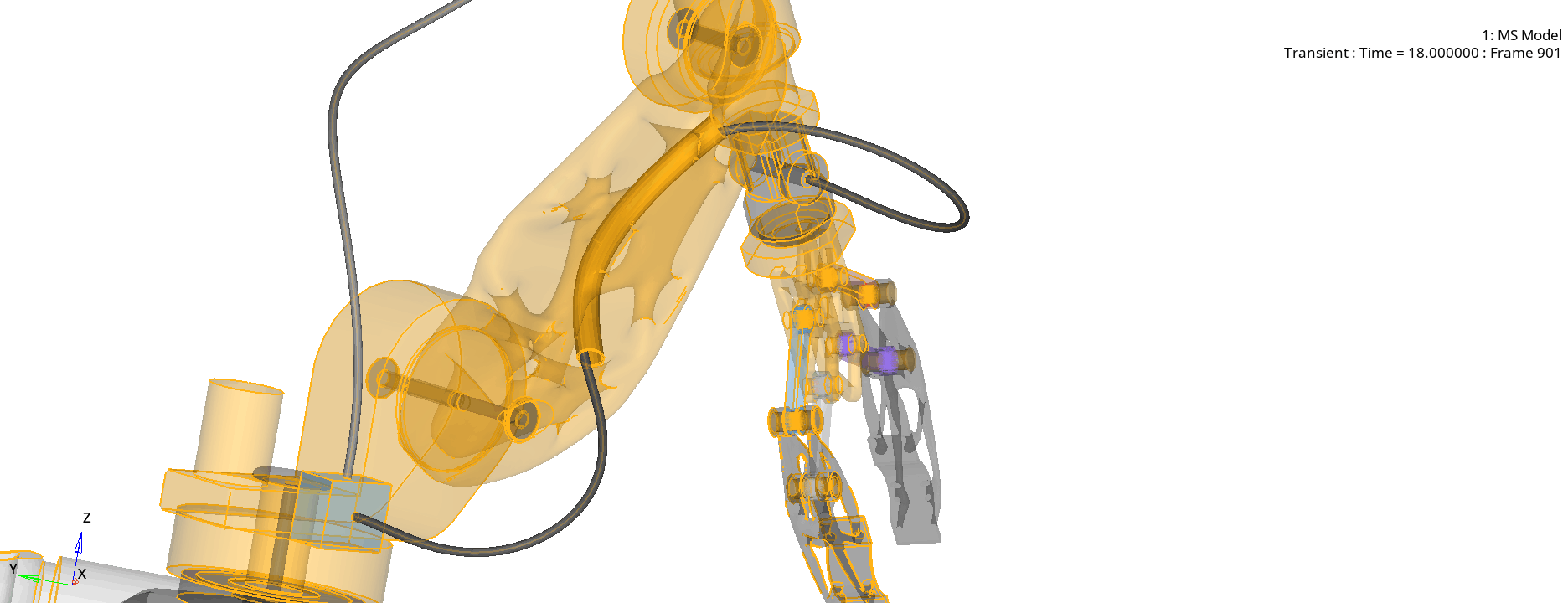

Deformable Curve on Polybeam (MotionView)
In the previous release, MotionView and MotionSolve added support for the deformable curve contact, which can be used to model pipes, cables, and tubes in contact. In this release, MotionView further enhances this functionality by providing an option to add a deformable curve with graphics when creating a polybeam entity. This improvement streamlines the setup of models with slender elements, enabling faster configuration.
