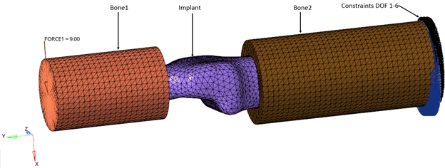

Figure 1. Model and Loading Description
Figure 1 shows the structural model used for this tutorial: A Hyperelastic Implant connected to bone on both sides. A force of 9 Newtons is applied at one end of the model and the other end of the model is constrained with all degrees of freedom.
The arthritic finger is modeled using hyperelastic material and subjected to a force of 9 N, aiming to rotate the finger by 90 degrees. The results of strain, displacement and stresses are analyzed for the TIE contact.

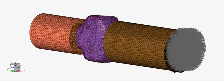

Import the Model
  1. On the menu bar, select File > Import > Solver Deck.
  2. In the Import File window, navigate to and select Arthritis_Finger.fem you saved to your working directory.
  3. Click Open.
  4. In the Solver Import Options dialog, ensure the Reader is set to OptiStruct.
    Figure 3. Import Base Model in HyperMesh
  5. Accept the default settings and click Import.

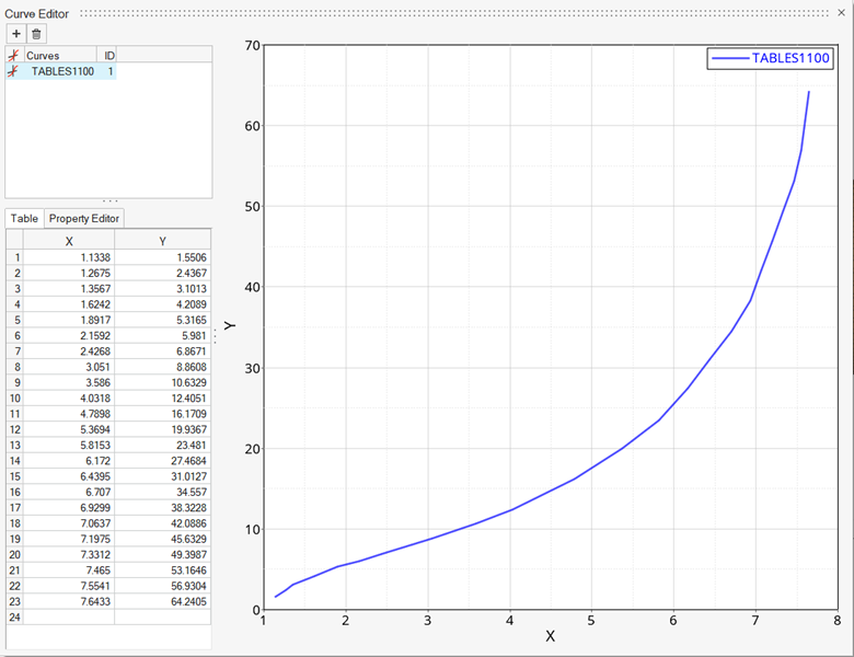

Create Curves
In this step, create the curves for the hyper elastic material.
  1. In the Model Browser, right-click and select Create > Curve.
    A default window for the Curve Editor opens.
  2. Right-click on the new table and select Rename.
  3. For name, enter TABLES1100.
  4. Enter the following values in the X and Y fields:
    Table 1. Simple Tension Compression Data Values
    X (stress) Y (strain)
    1.1338 1.5506
    1.2675 2.4367
    1.3567 3.1013
    1.6242 4.2089
    1.8917 5.3165
    2.1592 5.981
    2.4268 6.8671
    3.051 8.8608
    3.586 10.6329
    4.0318 12.4051
    4.7898 16.1709
    5.3694 19.9367
    5.8153 23.481
    6.172 27.4684
    6.4395 31.0127
    6.707 34.557
    6.9299 38.3228
    7.0637 42.0886
    7.1975 45.6329
    7.3312 49.3987
    7.465 53.1646
    7.5541 56.9304
    7.6433 64.2405
    Figure 4.
  5. Click Close.

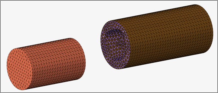

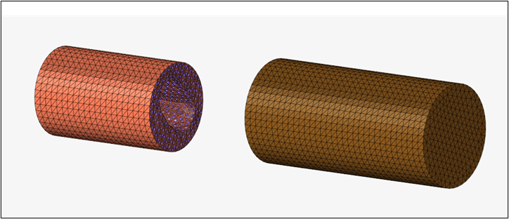

Define the Set Segment for the Implant
  1. In the Component Browser, right-click on Implant and select Isolate from the context menu.
  2. In the Model Browser, click Create > Set Segment.
  3. For Name, enter Implant.
  4. Click Color and select a color from the color palette.
  5. For Card Image, select SURF from the drop-down menu.
  6. For Elements, select 0 Elements > Elements.
  7. In the drop-down menu, select faces.
  8. Select all faces of the Implant component in the modeling window.
Define the Set Segment for the Bone
  1. In the Component Browser, right-click on Bone1 and Bone2 and select Isolate from the context menu.
  3. For Name, enter Bone.
  8. Select all inside faces of the Bone1 and Bone2 components in the modeling window.
    Figure 5.
    Figure 6.
Define TIE Contact
  1. In the Model Browser, right-click and select Create > Contact.
  2. For Name, enter Tie_Contact.
  3. Click Color and select a color from the color palette.
  4. For Card Image, select TIE from the drop-down menu.
  5. For Secondary Entity IDs, click Unspecified > Set Segment and select Implant.
  6. For Main Entity IDs, click Unspecified > Set Segment and select Bone.
  7. For DISCRET, select N2S from the drop-down menu.

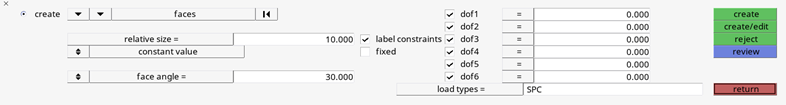

Define the Boundary Condition SPC
  1. In the Model Browser, right-click and select Create > Load Collector.
  2. For Name, enter spc.
  4. Open the Analyze ribbon and select BCs > Constraints.
    A panel to define the constraint opens.
  5. On the first drop-down menu in the panel, select nodes.
  6. On the second drop-down menu, select faces.
  7. In the modeling window, select the entire rear side face (all nodes) of Bone1.
  8. For load types, select SPC.
  9. Select all dof check boxes and enter 0.0 in the corresponding text boxes.
    Figure 7.
    Figure 8.

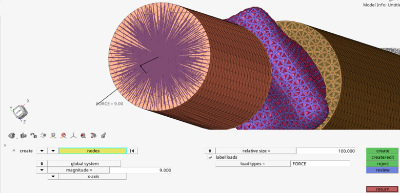

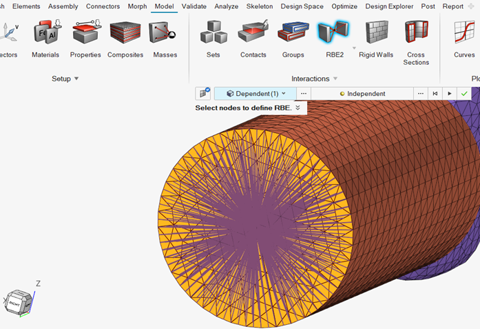

Define Force
  1. In the Model Browser, right-click and select Create > Component.
  2. For Name, enter RBE2.
  4. On the guide bar, select Dependent and choose faces from the drop-down menu.
  5. Select the front face of Bone2 and click .
    Figure 9. Face Selection for RBE2
  6. In the Model Browser, click Create > Load Collector.
  7. For Name, enter Force.
  8. Click Color and select a color from the color palette.
  9. Select the Analyze ribbon.
  10. On the Loads tool, select the Forces sub tool.
    Figure 10.
    The corresponding panel opens.
  11. In the modeling window, select the center node of RBE2.
  12. For magnitude, enter 9.0.
  13. From the drop-down menu below magnitude, select x-axis.
  14. For load types, select FORCE.
    Figure 11. Force Load RBE2

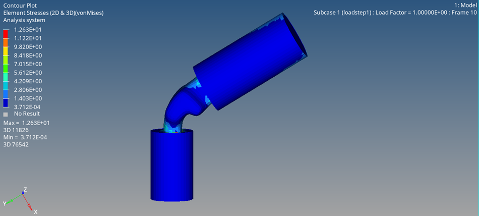

View the Results
  1. In the Solver window, select Results to open the results in HyperView.
  2. HyperView, select Contour .
  3. For Results Type, in the first drop-down menu, select Element Stresses (2D & 3D) (t).
  4. For Results Type, in the second drop-down menu, select vonMises.
    Figure 12. Contour of Element Stresses in Bone and Implant Subject to Loading

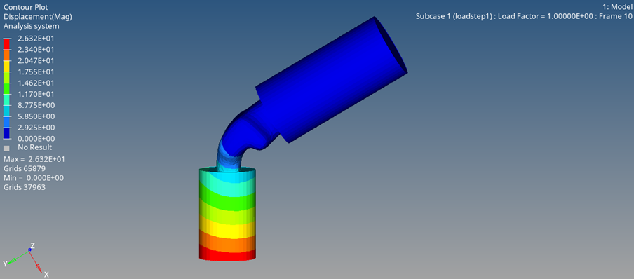

    Figure 13. Contour of Displacement in Bone and Implant Subject to Loading

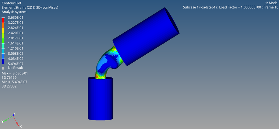

    Figure 14. Contour of Element Strains in Bone and Implant Subject to Loading
