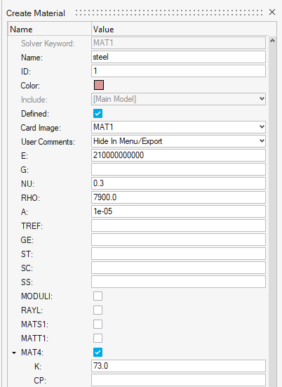

  1. In the Model Browser, right-click and select Create > Material.
    A default MAT1 material displays in a Create Material window.
  2. For Name, enter steel.
  3. Select the check box next to MAT4.
    The MAT4 card image appears below MAT1 in the material information area. The MAT1 card defines the isotropic structural material. The MAT4 card is for the constant thermal material. MAT4 uses the same material ID as MAT1.
  4. In the Create Material window, enter the following values for the material, steel:
    1. [E] Young’s modulus = 2.1 x 1011 Pa
    2. [NU] Poisson’s ratio = 0.3
    3. [RHO] Material density = 7.9 x 103 Kg/m3
    4. [A] Thermal expansion coefficient = 1 x 10-5 / °C
    5. [K] Thermal conductivity = 73W / (m * °C)
  5. Click Close.
    A new coupled thermal/structural material, steel, is created.
    Figure 4. Create Material Window

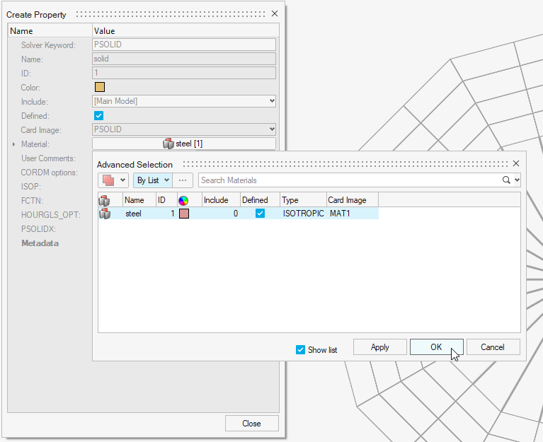

  6. In the Model Browser, right-click and select Create > Property.
    A default PSHELL property displays in a Create Property window.
  7. For Name, enter solid.
  8. For Card Image, select PSOLID from the drop-down menu.
  9. For Material, click Unspecified.
  10. Click .
  11. In the Advanced Selection window, select steel and click OK.
  12. Click Close.
    The property of the solid steel pipe has been created as 3D PSOLID. Material information is linked to this property.
    Figure 5. Assign the Material Steel to the Property Solid

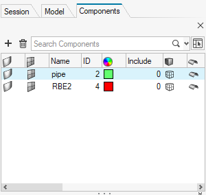

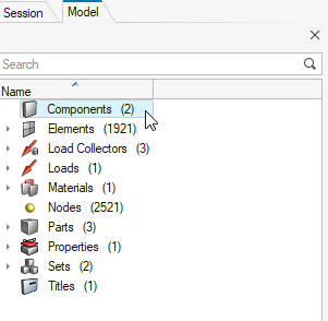

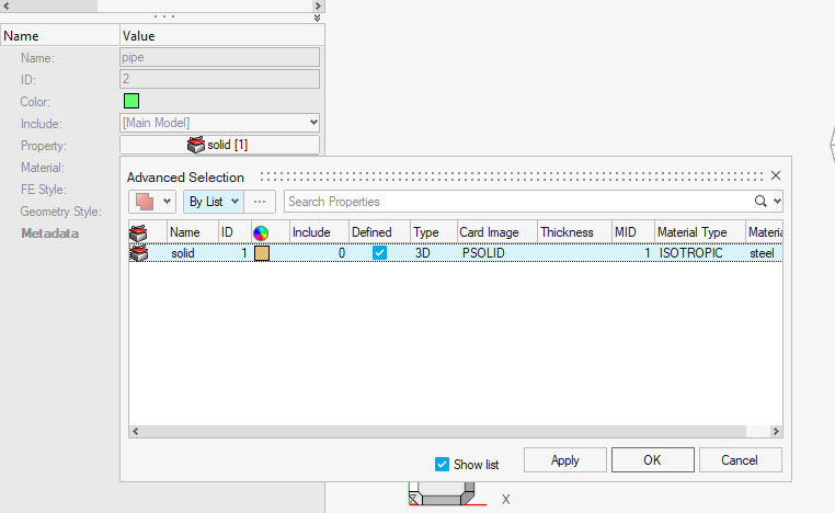

  1. In the Model Browser, double click Components to open the Components Browser.
  2. Click on the pipe component.
    The component template displays in the Entity Editor.
  3. For Property, click Unspecified.
  4. Click .
  5. In the Advanced Selection window, select solid and click OK.

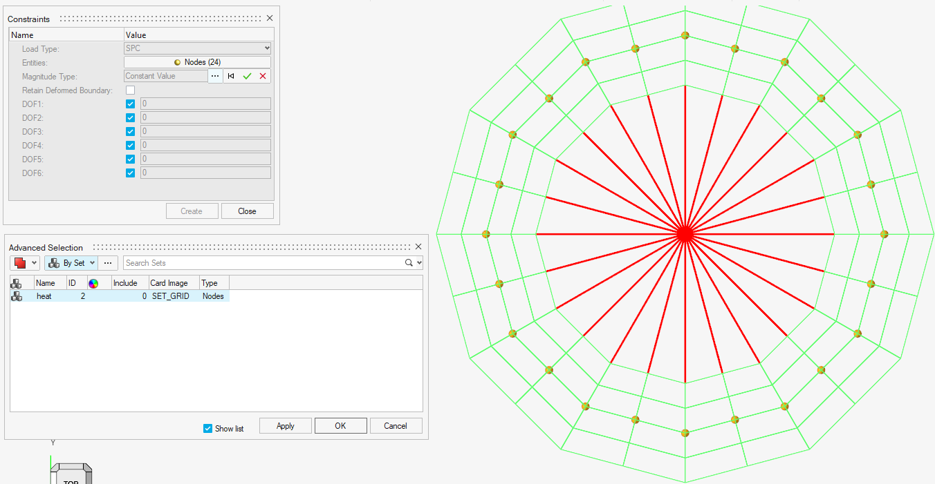

Create Thermal Constraints

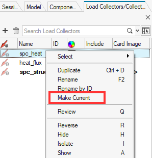

  1. In the Model Browser, double click Collectors under the Load Collectors section to open the Load Collectors/Collectors browser.
  2. Right-click spc_heat and select Make Current from the context menu.
    Figure 9. Make spc_heat Collector Current

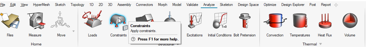

  3. From the Analyze ribbon, select the Constraints tool.
    Figure 10. Add Constraints

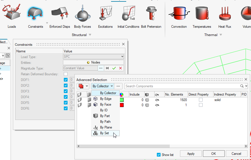

  4. For Entities, select Nodes > .
  5. In the Advanced Selection window, select By Set from the drop-down menu.
    Figure 11. Advanced Selection Menus
  6. Select the predefined entity set heat, then click OK.
    Figure 12. Node Selection for Thermal SPC
  7. Clear the check boxes for DOF1, DOF2, DOF3, DOF4, DOF5, and DOF6.
  8. Click Create and then Close.

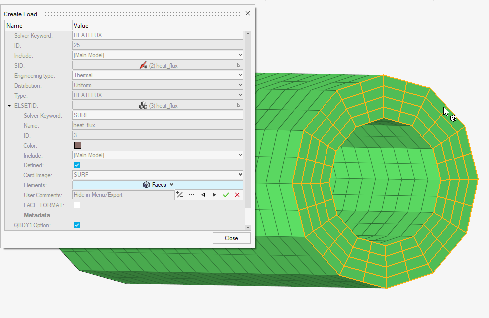

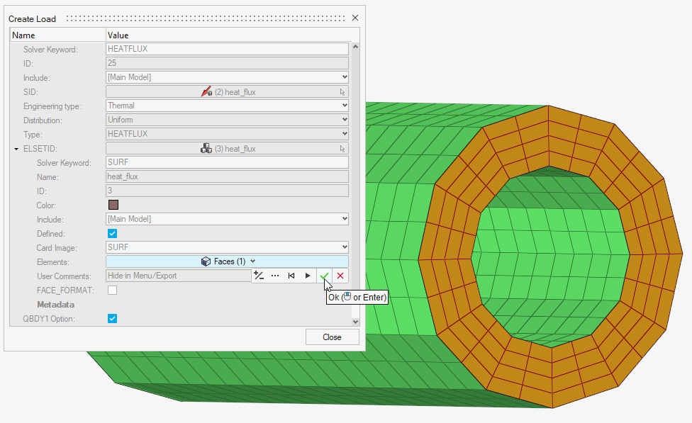

Create Heat Flux Load on the Free End of the Pipe
The heat flux is applied on the surface of the free end of the pipe.
  2. Right-click heat_flux and select Make Current from the context menu.

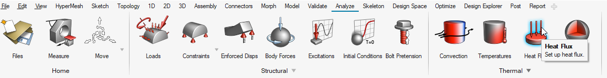

  3. From the Analyze ribbon, select the Heat Flux tool.
    Figure 13. Select Heat Flux Load
  4. In the Create Load window, For ELSETID, select the hamburger menu.
    Figure 14. Choose Surface for Heat Flux Load
  5. In the pop-up menu, click Create.
    Here, you can create a SURF SET on which the heat flux is applied.
  6. For Name, enter heat_surf.
  7. For Elements, click 0 Elements.
  8. Hover over and select the faces in the free-end of the pipe, as shown in Figure 15.
    The faces are automatically highlighted in the modeling window, making it easy to select the faces where the heat-flux is applied.
    Figure 15. Select Faces for Heat Flux Load
  9. Click to complete selection.
    Figure 16. Selected Faces for Heat Flux Load
  10. Under QBDY1 Option, verify Q0 is set to 1.0.
    Figure 17. QBDY1 Load Value
  11. Click Close.
    The uniform heat flux in the surface elements is defined.

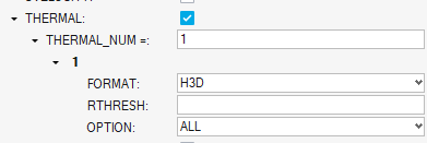

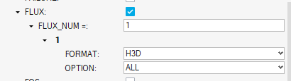

  9. Select the OUTPUT check box.
  10. On the sublist for OUTPUT, select the FLUX and THERMAL check boxes.
  11. For both FLUX and THERMAL, set FORMAT to H3D and OPTION to ALL.
    Figure 18. Activate Output Requests

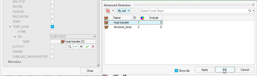

To perform a coupled thermal/structural analysis, the heat transfer SUBCASE needs to be referenced by a structural SUBCASE through TEMP card. Since this is not directly supported in HyperMesh, a linear static structural subcase is created and temperature is added using SUBCASE_UNSUPPORTED or by editing the .fem file after the model export.
  1. In the Model Browser, right-click and select Create > Load Step.
    A default load step displays in the Entity Editor.
  2. For Name, enter structure_temp.
  3. Click on the drop-down menu in the Value field next to Analysis type in the Entity Editor and select Linear Static.
  4. For SPC, click Unspecified > .
  5. In the Advanced Selection dialog, select spc_struct and click OK.
  6. Select the check box next to TEMP_LOAD and SUBCASE OPTIONS.
  7. For SID, select SUBCASEID.
  8. Click and select the heat transfer subcase.
  9. Click Apply.
    This selects the heat transfer subcase ID as the input load for TEMP entry for the structural subcase.
    Figure 19. Select Heat Transfer Subcase as Load for Structural Subcase
  10. Click Close.

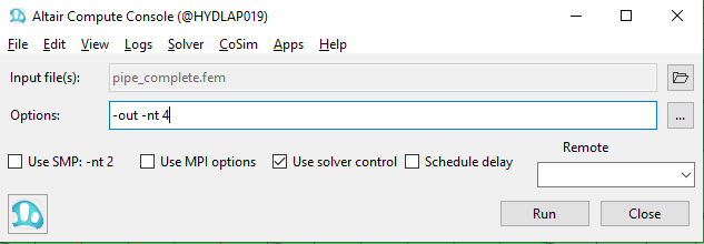

  6. In the Altair Compute Console, for Options, add the following run options:
    Figure 22. Altair Compute Console
  7. Click Run.

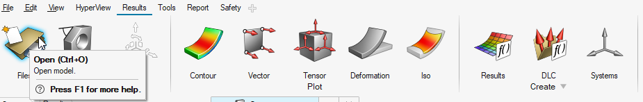

  5. On the Results ribbon, Files tool group, click Open.
    Figure 23. Open Results File in HyperView

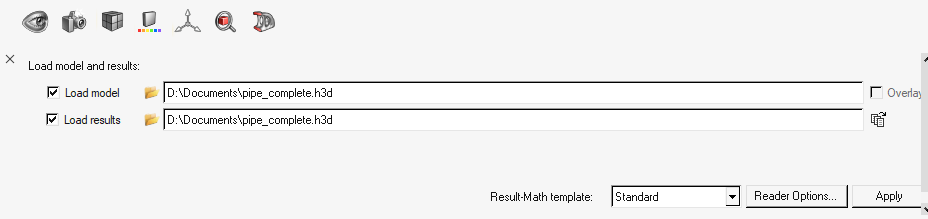

  6. For both the Load model and Load results fields, select pipe_complete.h3d from the File Explorer.
    Figure 24. Load H3D File in HyperView
  7. Click Apply.

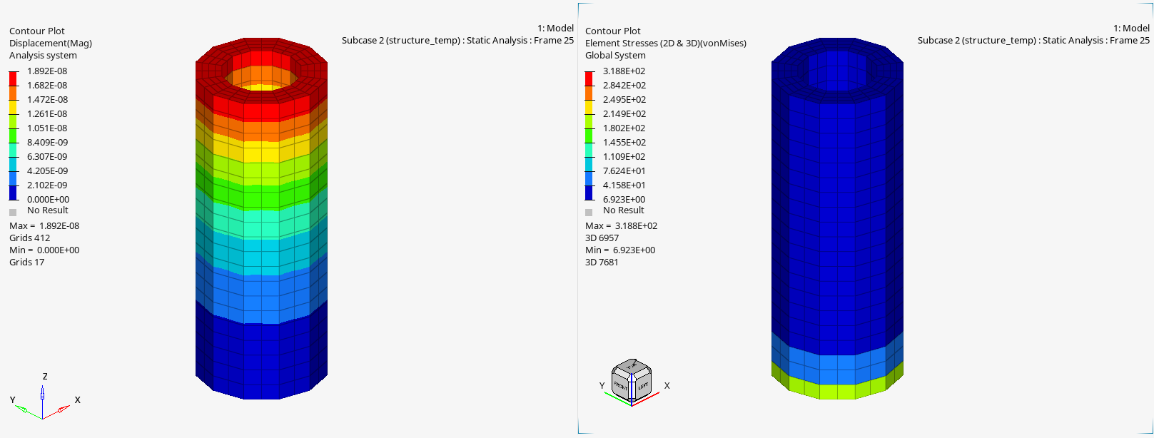

  8. On the Results ribbon, click Contour .
    Figure 25.

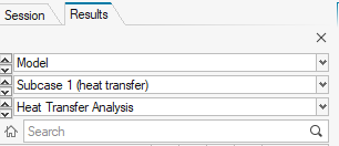

  9. In the Results Browser tab, select Subcase 1 (heat transfer) as the current load case.
    Figure 26. Results Tab in HyperView

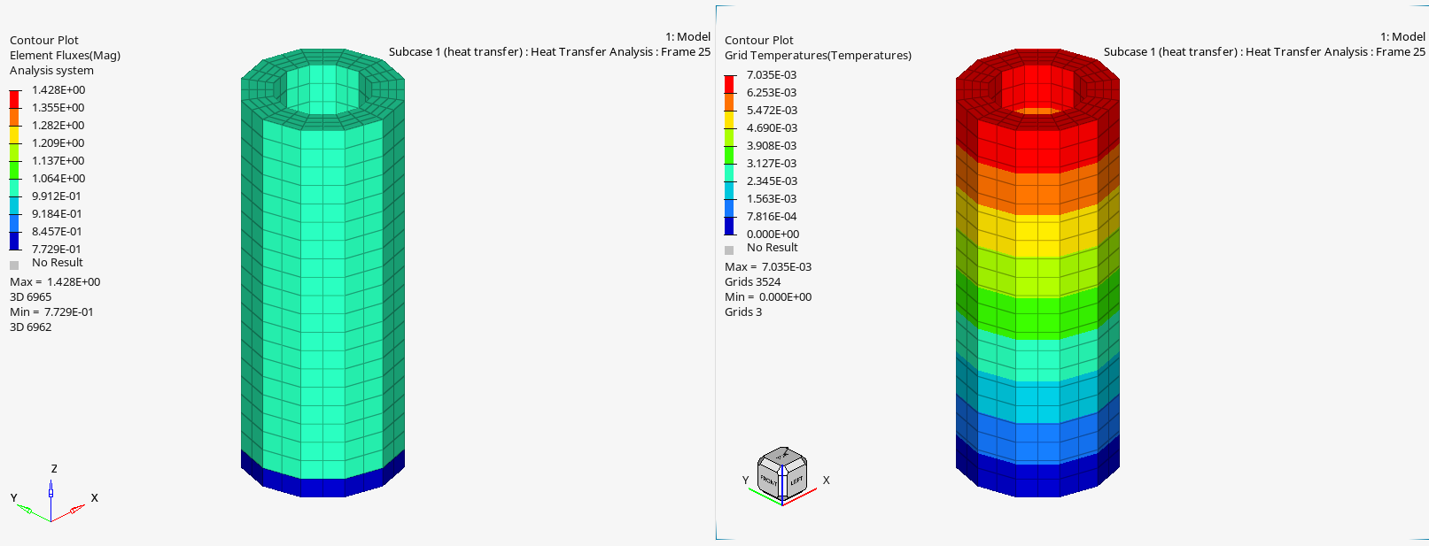

  10. In the first pull-down menu below Result type, select Element Fluxes (V).
  11. Click Apply.
    A contoured image representing Grid temperatures is displayed.
    Figure 27. Results of Heat Transfer Analysis
View the Coupled Thermal/Structural Analysis Results
  1. In the Results Browser tab, select Subcase 2 (structure temp) as the current load case.
  2. In the first pull-down menu below Result type, select Displacement (v).
  3. In the second pull-down menu below Result type, select Mag.
  4. Click Apply.
    The displacement contours are plotted.
  5. In the first pull-down menu below Result type, select Element Stresses [2D & 3D] (t).
  6. In the second pull-down menu below Result type, select vonMises.
  7. Click Apply.
    A contoured image representing von Mises stresses is displayed. Each element in the model is assigned a legend color, indicating the von Mises stress value for that element resulting from the applied loads and boundary conditions.
    Figure 28. Results of Structural Analysis
